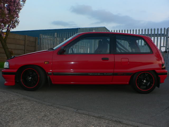

Mates charade gtti 998cc
  Evo 8 Jap Crap
His cars in fast car next month :)
187Bhp + 155ft/lbs @ the wheels :cool:
Fully rebuilt 998cc block with an Impreza TD04 Turbo
  Ph1 Clio V6, Ph2 172

Jefs is around 220bhp and is a fully rebuilt block
Original 993cc 12v twin cam engine
-Full engine rebuild including:
- Main bearings oversized
-Big end bearings
-Reground crank then polished
-Boars Honed
-New piston Rings (uprated)
-New head gasket uprated
-Valves re-seated and shimmed
-Cyclinder head ported and polished and skimmed plus comression tested
-Full engine gasket kit
-engine block paint stripped and re-painted
-new oil pump
-new thermostat
-New balenced shaft bearings
-8mm Magnacor racing HT leads
-Rocker cover painted black
-Piper Cross Foam air filter
-Universal front mount intercooler 50mm outlets
-50mm intercooler pipes mix of solid and silicone plus umgraged hose clamps
-Subaru impreza TD04 turbo
-Custom exhaust manafold
-Custom down pipe 2 and a half inch
-2 and a half " exhaust system with middle box and back box made by Blue Flame
-rx7 1990 non turbo 460cc injectors
-Polished gear box
-Phontom grip lsd fitted in gear box
-Greddy profec boost controller
-Greddy emanage piggy back ecu controlling fuel and ignition
-greddy 3 bar map sensor
-custom oil catch can and engine breathing system
-Honda accord ally radiator
-Fuel pressure regulator running at 3 bar
-Sports Clutch with 50% uprated exceedy pressure plate plus bearing
-Lightend and balenced flywheel
-Extra engine earths
-Aftermarket fan mounted to radiator
