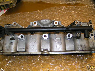

Has anyone got a picture of where the rs is stamped on the rs stamped inlets? Took off my fuel rail gaurd last night and got a morror out. Couldnt see anything?
  172 cup
thats weird. I am rite in thinking yours is a cup from your pic? Check engine code matches to one on VIN might of had a different one at some point?
