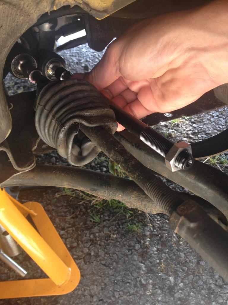

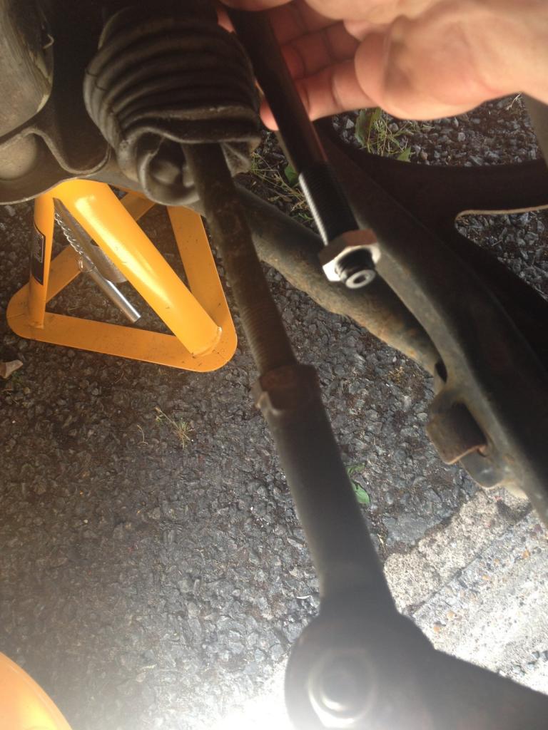

So, as part of the suspension refresh on my car.. I bought Lemforder track rods. Fitted most the parts a few months ago and only just got round going to fit the track rods. Turns out they are wrong!! Pulled the steering rack boot back and compared the old and new items before removing anything else, the Lemforder items are sooooo much shorter than original bits (think original anyway)
The car is a FF 182 so maybe this is where it's gone wrong, the Lemforder items are 270mm end to end (rack end threads included) and the original items appear to be about 5cm longer. Anyone know what ECP are like returning parts after 4 months??

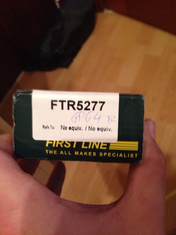

They're actually listed as a berlingo van I believe but just ask for them by part number FTR5277
