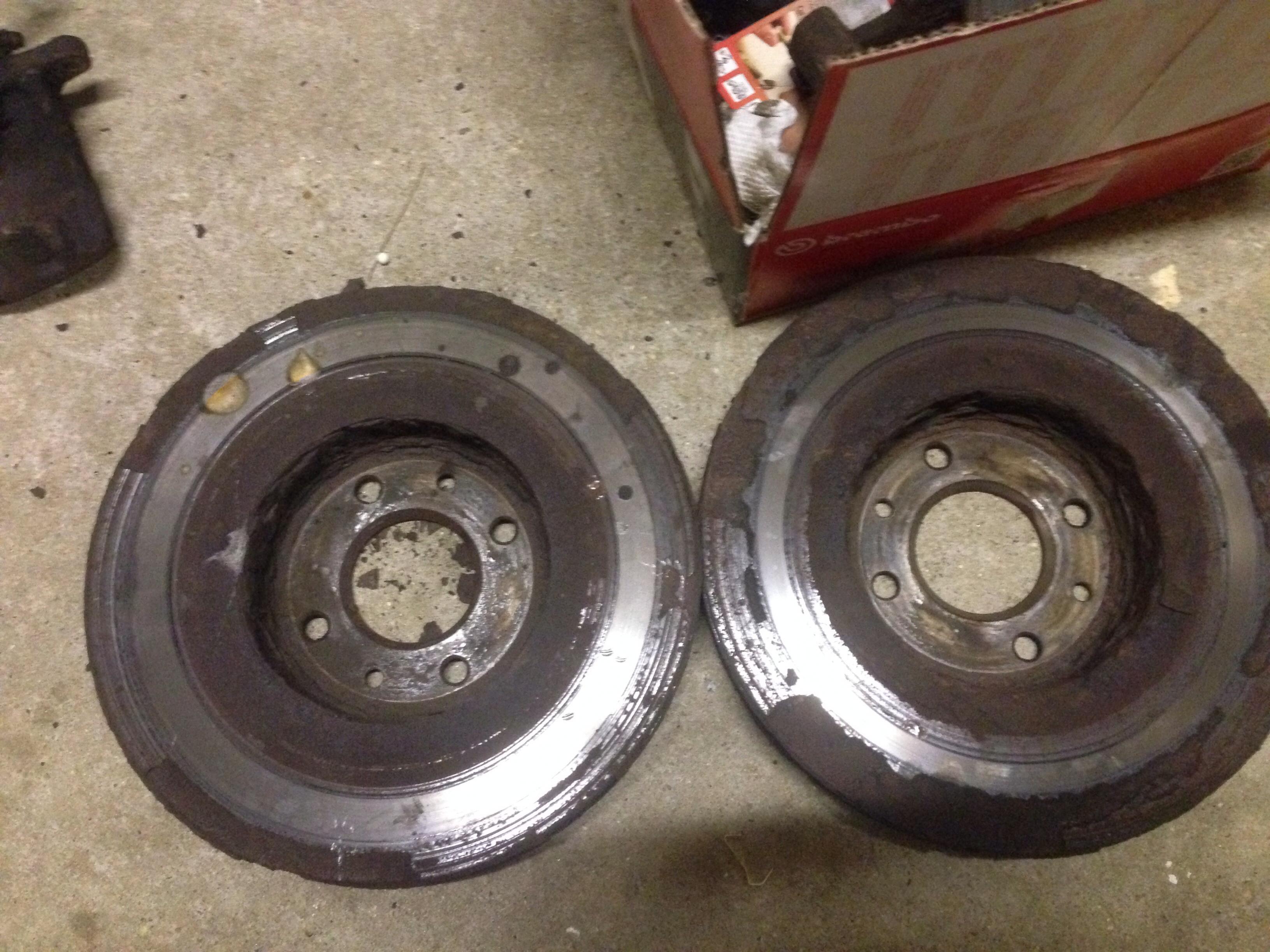

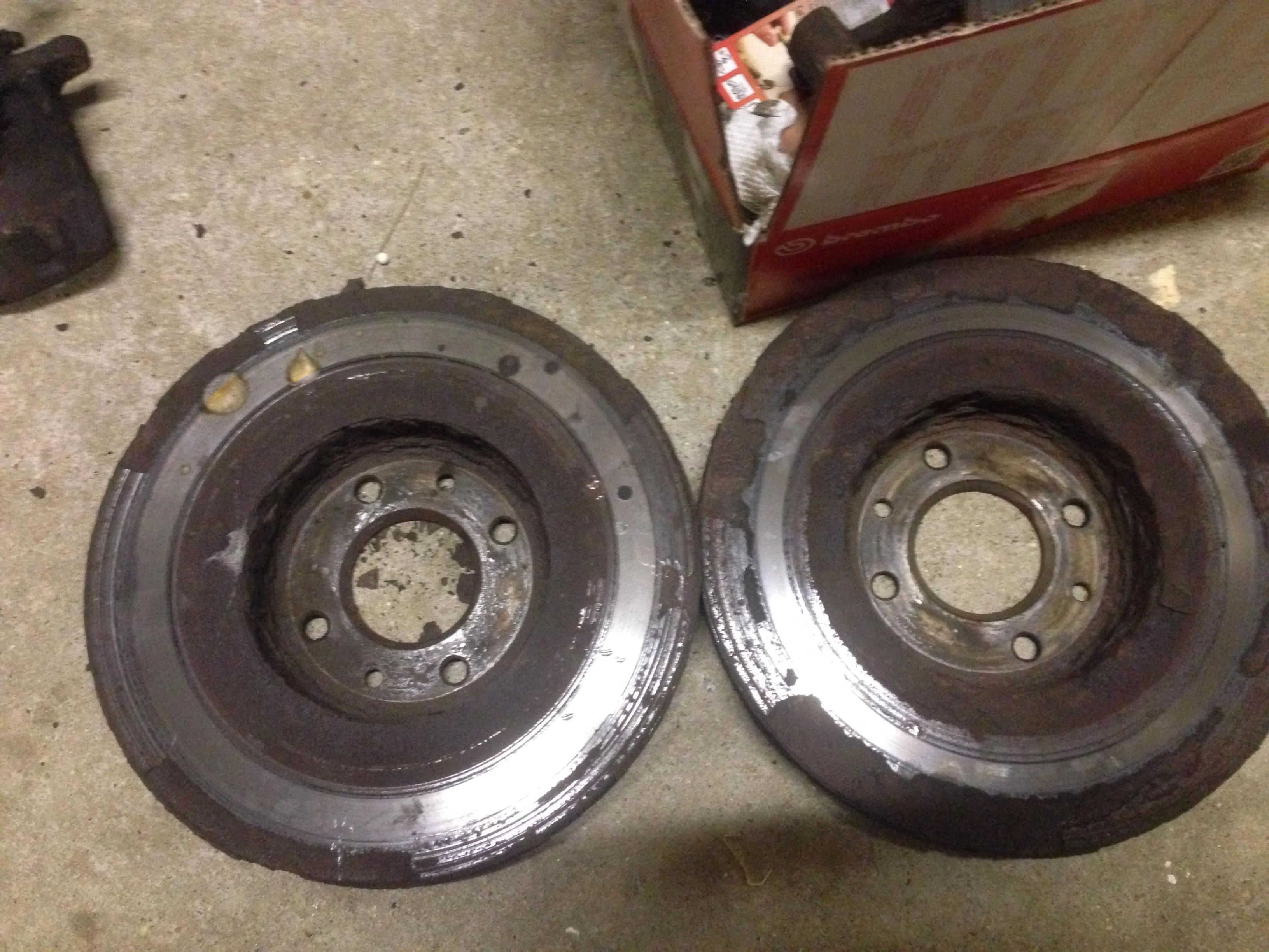

I'll give the jubilee clip method a go then but also try to salvage the old retaining clip, I don't fancy changing the whole boot if it isn't necessary. I had to change the calipers as the ones on there were corroded to s**t, the pistons just wouldn't move back enough to get them over the new pads, also the slide pin things on one side were seized. Thankfully I had already purchased a second set of powder coated caliper earlier in the year so I wasn't completely buggered. I'll try to post a photo of the condition of the discs they were truly shocking I've only had the car 3 months Christ knows how it got through an mot earlier this year
