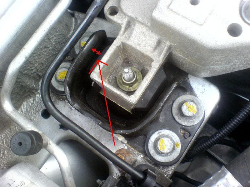

Yeah, basically there is a mount on the left as you look at the engine from the front of the car with four bolts around it.
Loosen all 4 bolts, get someone to pull the engine by grabbing the back of the engine (nearest the windscreen) towards the front of the car.
Pull it as far as possible, get your mate to hold it there whilst you tighten the top left, bottom right, top right and bottom left bolts (in that order preferebly).
Heres a pic that was in a thread (http://www.cliosport.net/forum/showthread.php?t=348491&highlight=engine) that I asked about the same problem before.
The picture is a bit confusing as the small arrows indicate to increase the gap between the metal and the rubber bracket, therefore decreasing the gap on the other side which is what you're meant to do.

I have the same problem, tried to move the engine forward today. The metal part around the rubber mount can be moved, but it makes no difference to the engine position. Is the plate below this supposed to move to, seems like it's pegged to the body somehow and it has small lugs sticking up that limit the movement of the upper metal part. I'll post a photo later to explain what I mean.
