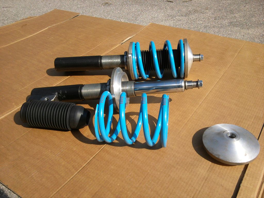

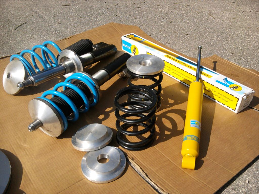

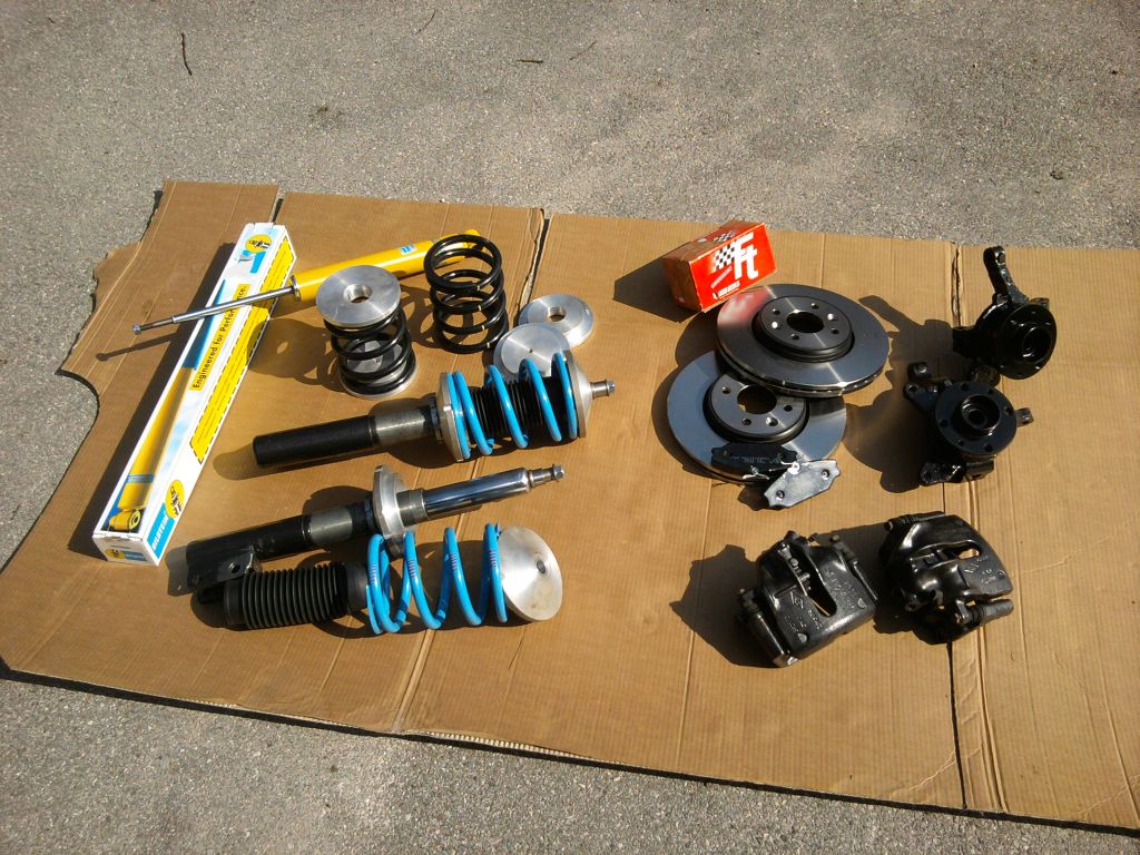

I'm driving 2002 Renault Clio 1.4 16V for about two years. At first it was comliptly standard, than I bought Koni coilovers, updated brake pads etc. but this year I've decided to start all over again.

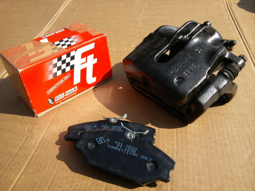

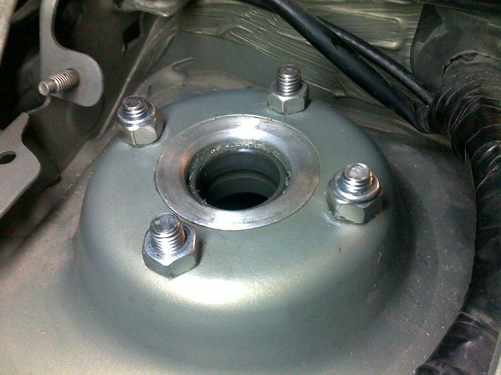

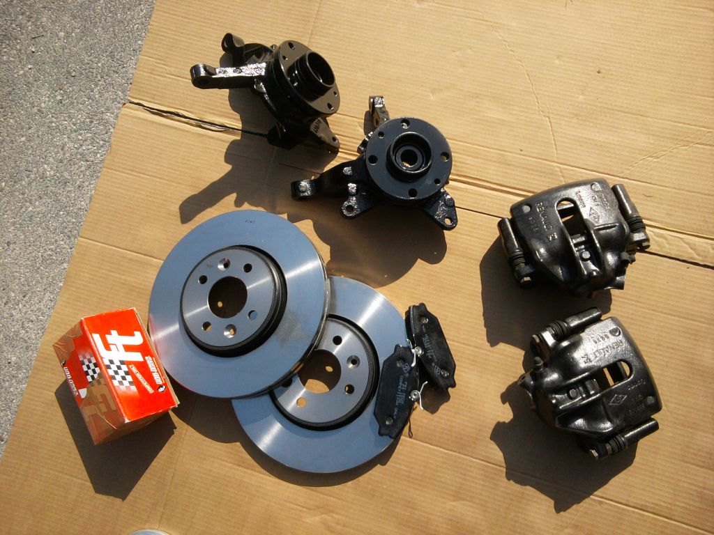

I've used front Renault sport (Bilstein) struts and dampers from Clio I 1.8 16V Gr.A (I had to make some modifications), rear Clio II RS Gr.N dampers (Bilstein) and Clio II RS Gr.N springs (front and rear, both 6kg/mm). I've also made solid top mounts. Beside that I've updated my brakes - Clio II RS hubs with brake calipers, Fritech race pads, Clio II RS Gr.N discs.
Thats all for now.. ..engine swap is in progress. More pictures later.

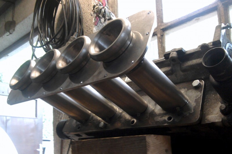

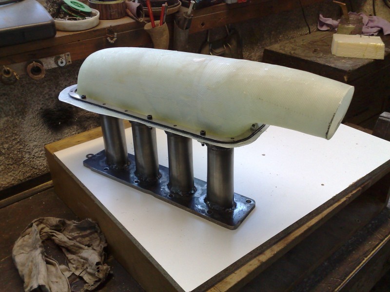

K4M won't be standard.. ..skimed head (little higher compression), lightened flywheel, Clio 172 exhaust manifold (modified to fit on K4M engine) and custom (home made) intake manifold (that will look very similar to JMS RS2 manifold).

Difference between K4J and K4M is just extra 200ccm (K4M), almost everything else is the same (depends on type of TB - fly by wire or mechanical). My intake manifold will fit on both engines.

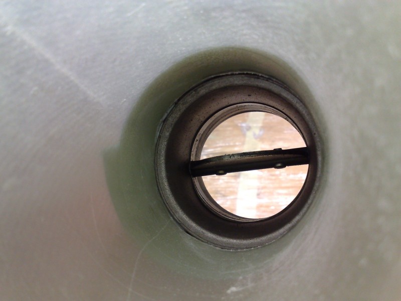

Exhaust flange was made in local machine shop. I've made a copy of exhaust gasget (in Solidworks) and than it was cut on water jet. I can send you the drawing if it helps.

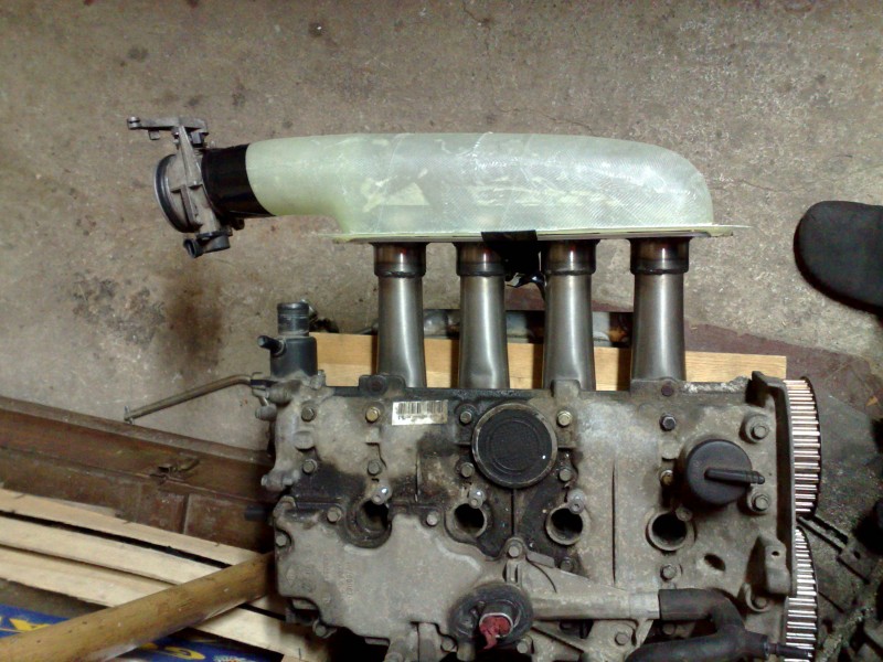

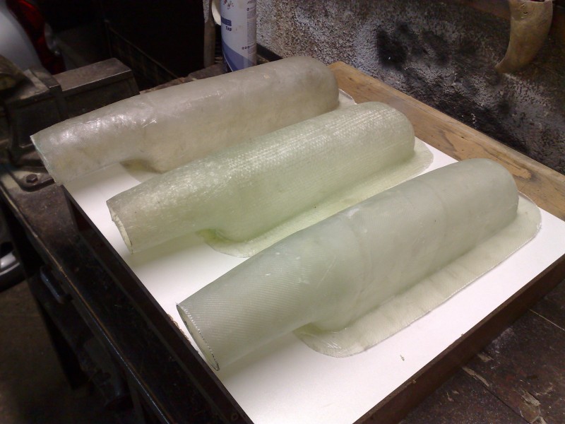

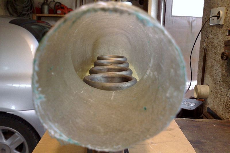

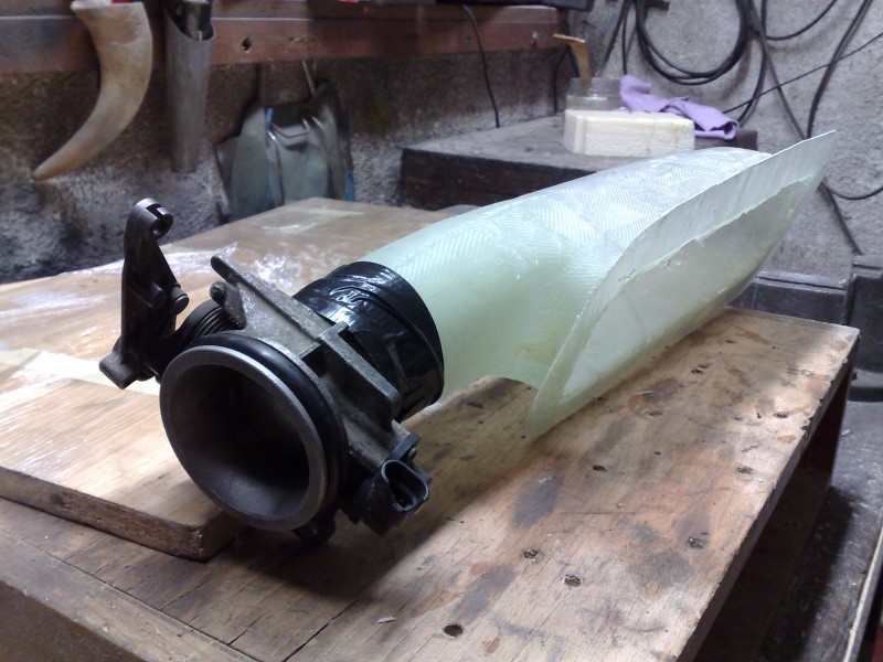

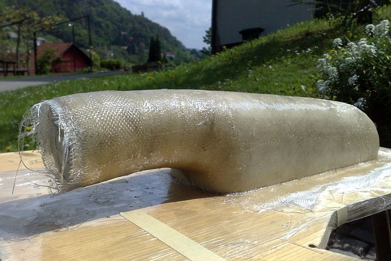

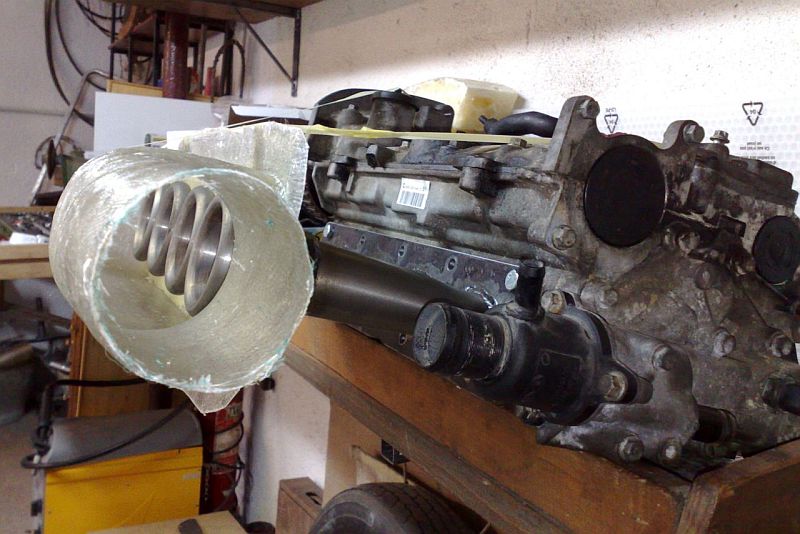

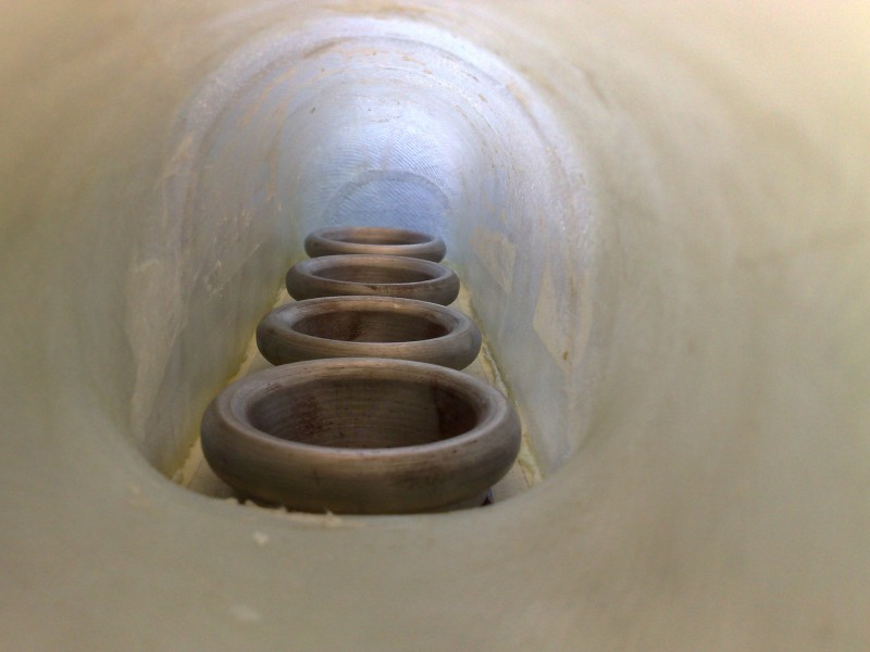

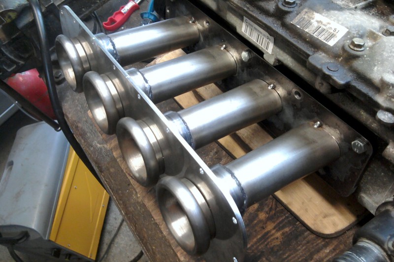

I've made 3 different plenums.. ..the one on right is the latest and will be use on my engine.

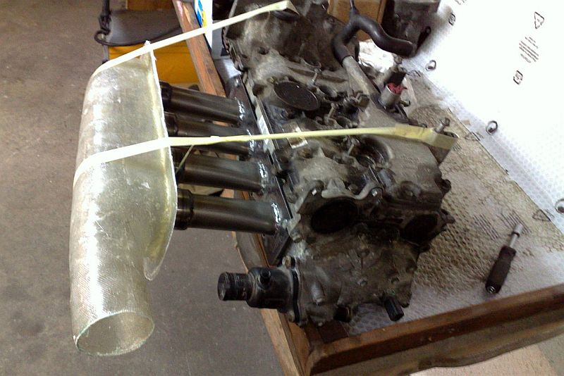

Test fit..
And my favorit pic..
