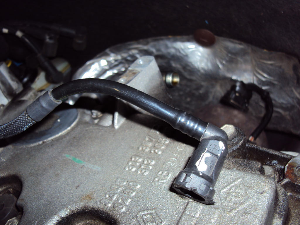

1 - The 172 has a hose that connects to the top of the crank case breather plate - the 182 has the same hose but it connects to the plenum, but my RS2 does not seem to have anywhere for this hose to go, how is this supposed to be fitted? can I just not connect the hose ?

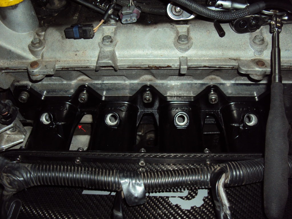

2 - The bottom left bolt that holds the manifold to the head, I got the bolt tight by hand but how the hell do you get in there to tighten it? does it require the alternator to be removed or am I missing something?

1. I think (I might go outside and check for you ;) that pipe is for the carbon canister, you can just leave it (bit pikey) or remove the carbon canister altogether and block the pipe from the tank. On a 172 it goes onto the oil breather plate.
2. It is a b*****d, you just have to get an allen key in there and turn it a bit at a time. I have no air con so maybe mine was easier.

2. i cut down an allen key and bent it with some heat, just takes time

1. Is the vac supply to the carbon canister this can be removed but I believe it will bring a dash light on.
Is removing the canister a good idea? where does the fuel tank then vent to? would it be a better solution to join the brake servo and carbon canister to a T piece and then run to the plenum?
The fuel tank has a vent anyway - I've blocked the pipe off and binned the carbon canister on my ITB'd car - no problems at all. It has a secondary vent through the fuel cap I believe

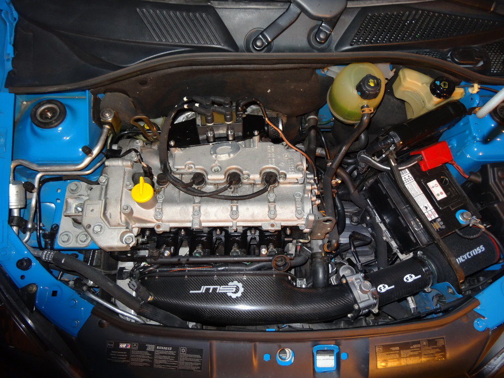

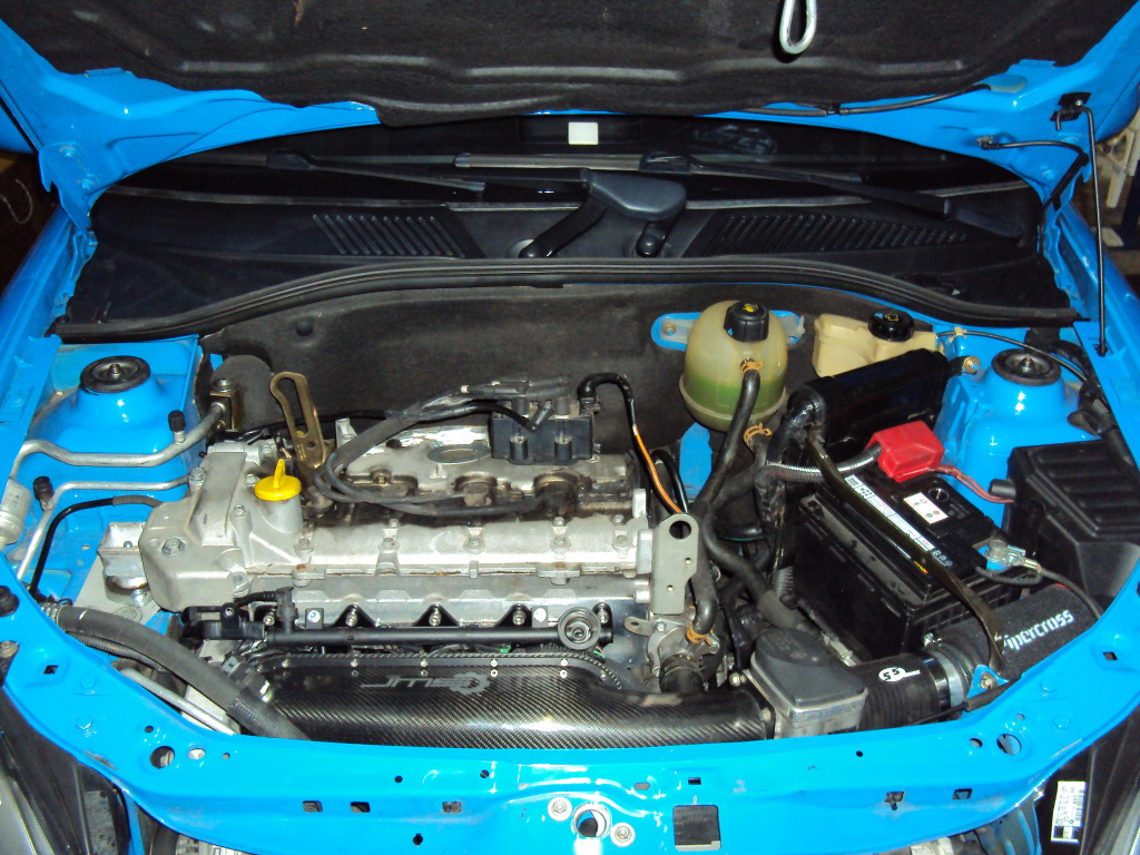

Finally got the dam thing on and started last night:
gave it a bit of a rev, havent driven it yet as I still need to mount the coil packs and find a t piece to run the charcoal canister line back into the intake.
Did get it back fire through the intake twice though when reving it though, made a nice POP! any ideas why that would occur?

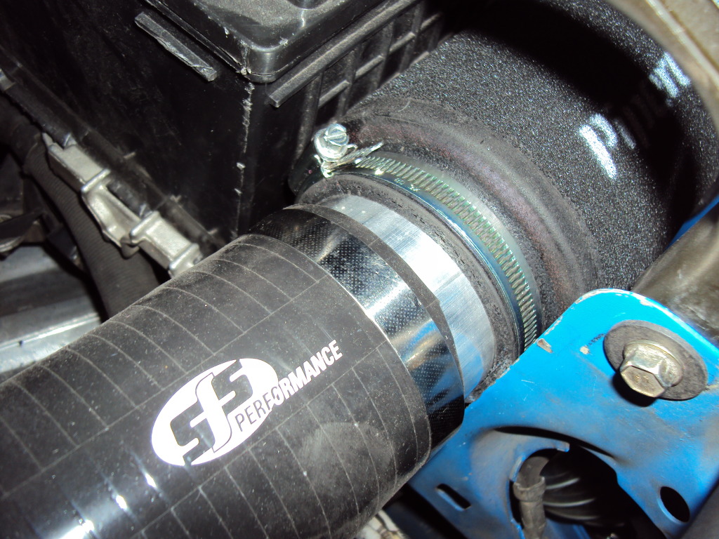

I also dont like how the filter is basically un secured:
Looks like it might rub a bit,
The coughing back through the manifold is most likely as you haven't had it mapped yet. I remember mine needed very gentle throttle at low revs before mapping.
My filter is same as yours, it's been fitted nearly 2 years without any issues.

Easy to make a bracket for the filter but TBH the pipe is so stiff it isnt really an issue.

that distribution side bolt is a b**ch isn't it...:evil:
I cursed so loud the place I was working at asked me to keep it down a bit.
