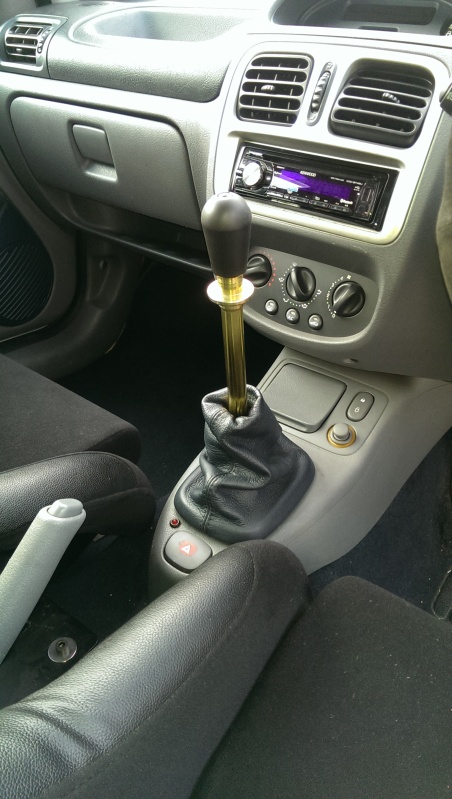

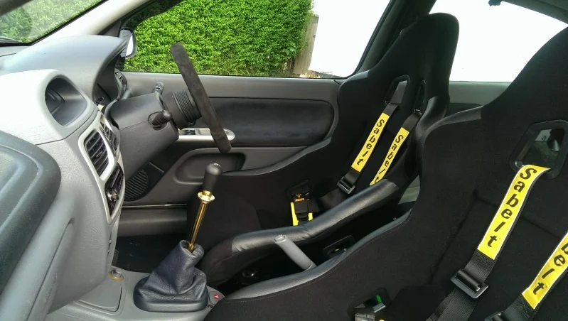

Well I got my PMS shifter the day after ordering. I was a little put off by the price but I stumped up anyway and got it fitted.
Fitting was easy enough but the setup was a little trying, got it perfect in the end and I must say I'm quite impressed although I'd have felt about £100 cheaper would be a better price, then again I don't know what it costs to put the kit together.
For setup I followed the instructions and started in reverse. But I couldn't really get 3rd, 4th and 5th. So I put it in 2nd and tweaked it a bit. I could get everything bar 5th gear. So I tweaked it finally in 4th and I could get all gears perfectly. Its a very confidence inspiring shift. I went for a quick blast and tried a bit of heel and toe on downshifts and I didn't once feel like I would miss a gear.
As for the rattle, I get a little bit occasionally but nothing major. Its the spherical bearing in the shifter housing, being a bearing it can take loads but in this scenario it isn't under load which lets it vibrate a bit. I used double sides sticky foam doubled up instead of silicon which might help a bit and I left the sound deadening in place around the shifter housing.
The positioning is spot on and when giving it some it just feels 'right'.

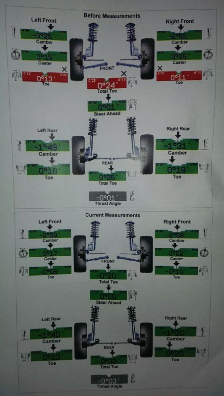

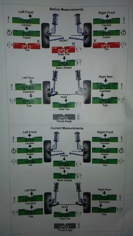

And I got my geo set, first off I went to AJK Motors. It cost £84 and when I got home I looked at it and I thought it wasn't quite right so I took it to Buckley Tyres where I usually go. As I thought, it was out; 0.5 degrees more camber on the OSF and AJK had set 20 mins toe in when I had asked for toe out. And they hadn't tightened the lock nut on the OSF spherical bearing rod end.
Something I need to consider is going back to AJK and making a scene, they obviously don't know what they're doing.
All sorted

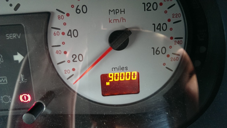

When I got to Buckley Tyres I hit a milestone, 90k miles

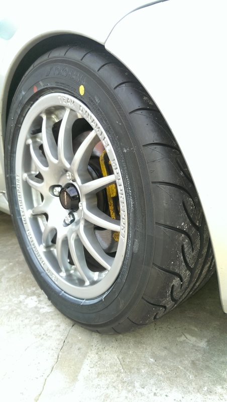

The Yokohama AD08R seemed to have held up much better than the Federal RSR, I felt the cornering grip wasn't a great deal different but they don't need as much camber, braking felt more stable (that could be down to the camber) and the power got put down better (again probably due to less camber). I'll definitely be sticking to these over the RSR although I don't know how they compare in the wet.

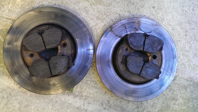

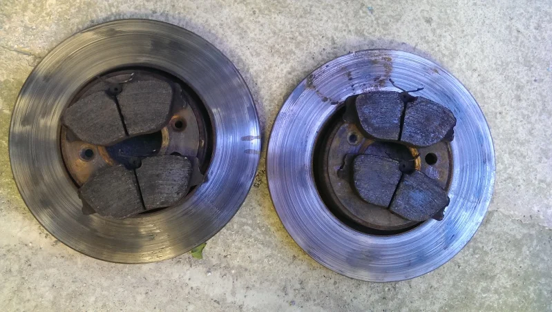

The only real let down, although it didn't hamper the day, was the brakes. The DS2500 on the front cooked and got a nice glaze so the discs and pads have had it. To be fair they've been pretty good until now, pushing on to take on some R26.R Meganes probably didn't help.
So these will be going on earlier than I had planned along with a set of Carbon Lorraine RC5+ pads I ordered from KTec who are the cheapest around for them at the moment.

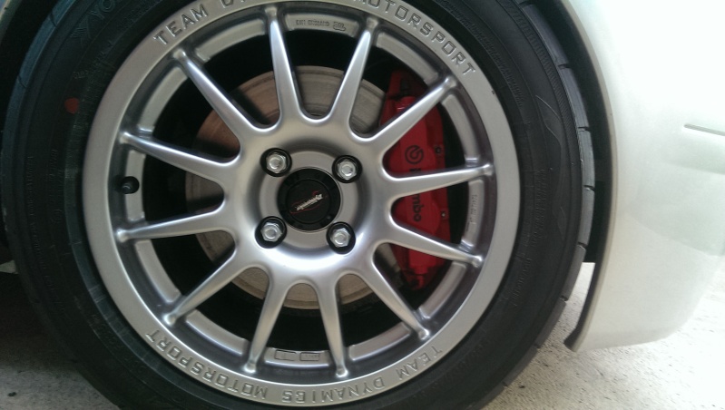

Off with the cooked discs and pads...

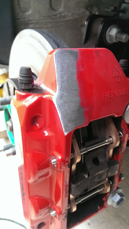

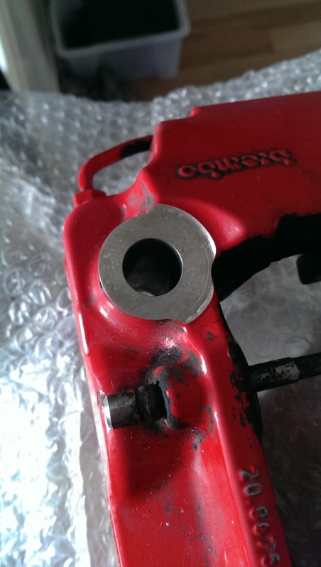

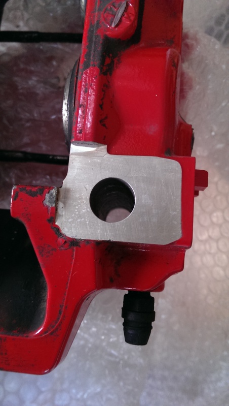

I machined the new callipers last week in work, I took 5mm on the mounting face and 1.5mm off where the nuts will sit to accommodate the 283mm bells and rotors later on in the year.

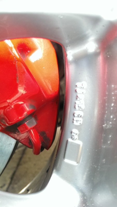

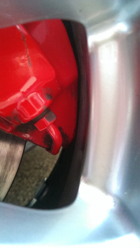

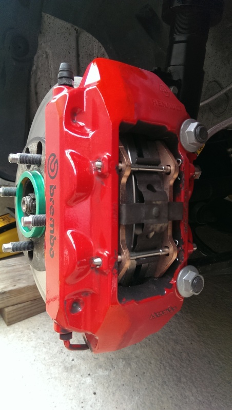

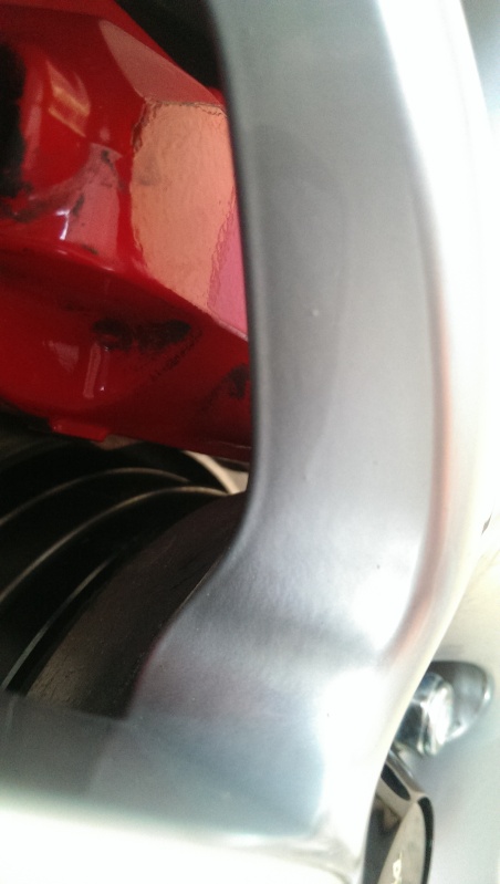

Managed to get my 4 pots on, they're a tight fit! I'm going to take a bit off the corners this weekend and reduce the spacers from 10mm to 5mm.
Ph1 Tom
Lol! That's proper f**king close!! No room for wheel weights there!
Nope! I had to remove them :rasp: so I'll need to get them rebalanced soon
Awesome!!! 197/Megane brembos, and only 10mm spacers? What offset are those wheels again?
I could get away with 5mm, maybe even a bit less like 3mm. They're ET35 so to run without spacers you want ET30. With the Pro Race 3 which has more spoke clearance you could quite easily fit ET45-40.
That's about as close as mine is running 300's
Yeah, The downside is compared with the Wilwood Midilites they have a larger pad area and are made for larger discs and so it means disc size is compromised and they are a bit heavier. The upside is the larger pad area, piston area, disc thickness (when I fit my bells and rotors) and larger surface area of the calliper to disperse heat.
Overall the brake torque of the Brembos with 283mm discs and a lower coefficient pad (RC5+ = 0.48) is a little bit more than Midilites with 300mm discs and a slightly higher coefficient pad (DS3000 = 0.51) but not enough to notice any difference between the two systems your only talking 5-6%. Whether the extra pad area, disc thickness and ability to disperse heat means that pad and disc wear is reduced I'll never know!

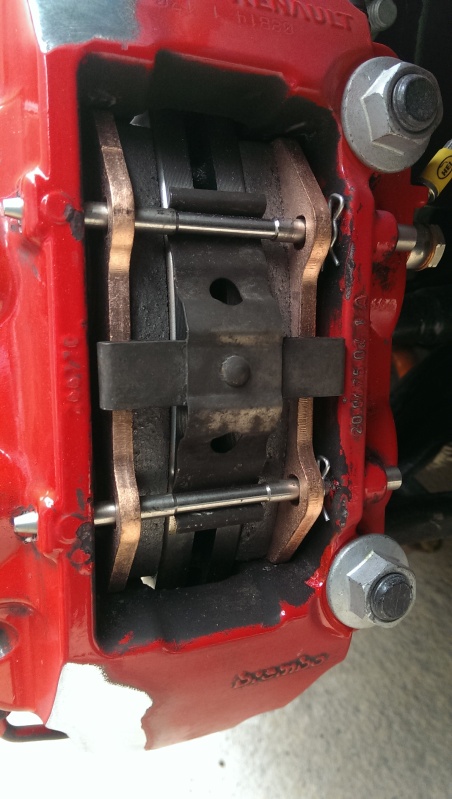

A bit more clearance sorted :) I didn't want to take too much off but I've got about another 3mm
Here you can see the redesigned brake pad retaining pins and CL pads.

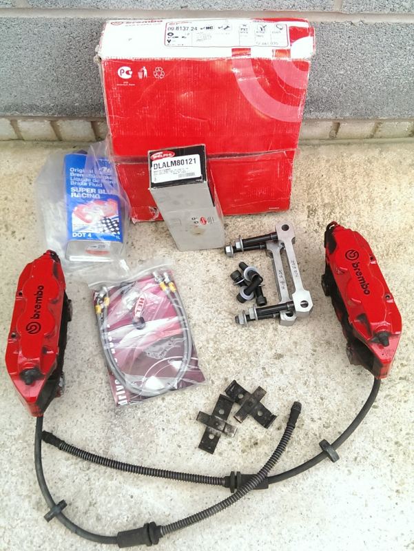

Looks good Tom. Did you give up on the MG AP's?
I did Morgan, I decided to go for a more 'off the shelf' solution instead.
