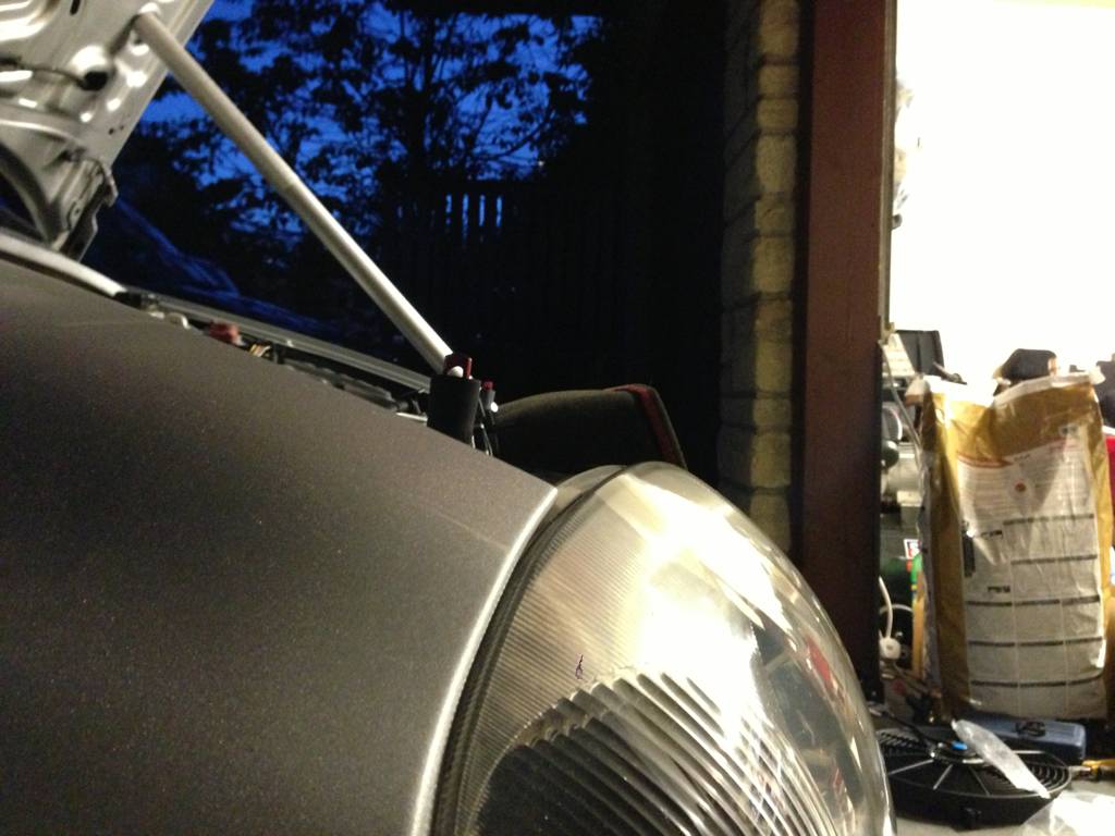

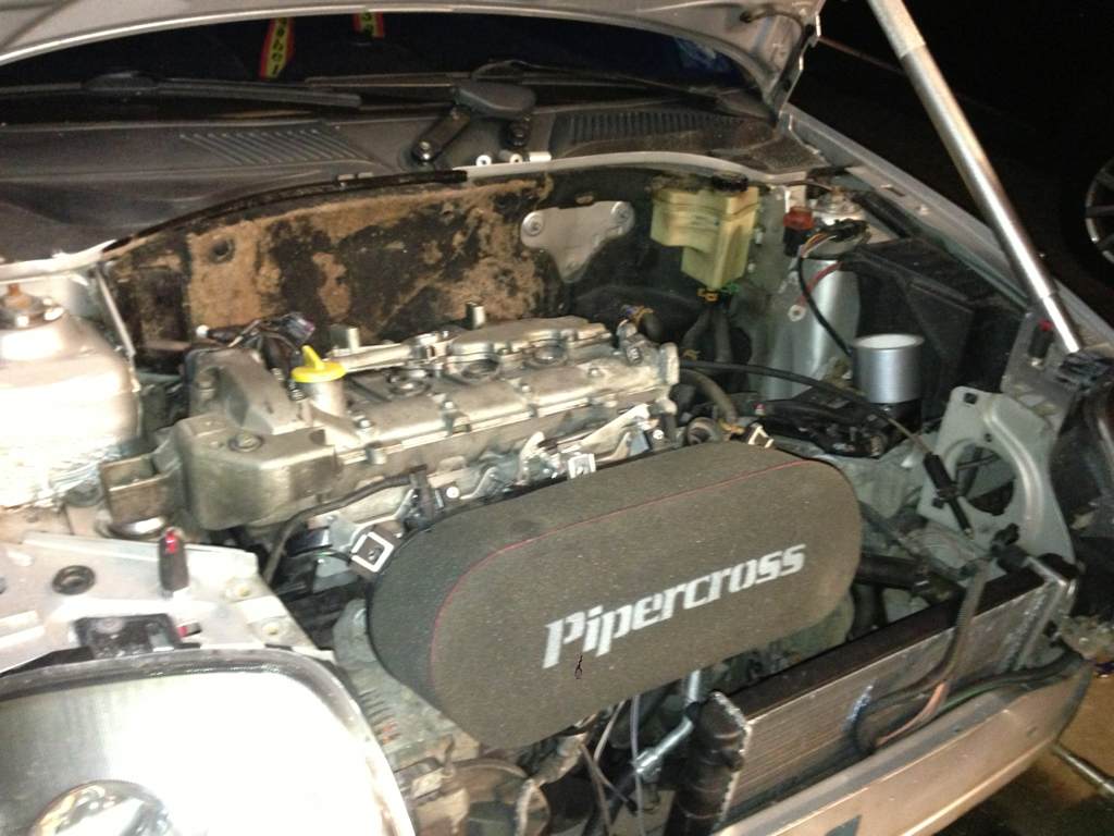

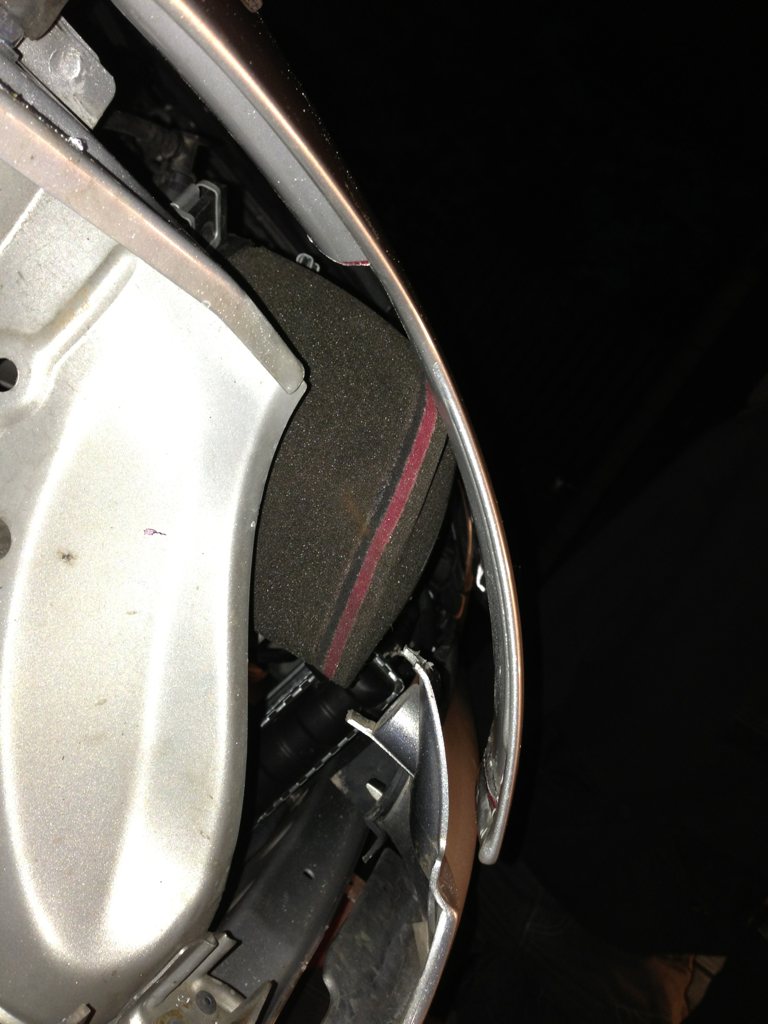

As can be seen I'm struggling with the 120mm trumpets in my ph1.
Any way of making them work?
Will they work with the filter hitting the underside of the bonnet? Or am I best to go down to 90mm trumpets?

Which ITBs are they? Jenvey SF's? The filter looks to be mounted quite high up. 120s are TIGHT on a ph2, I'm not sure they'll go on a ph1. 90s and a curved filter will work better for you
Ye I think they're SFs.
They definitely angle up off the head, the manifold is at a tiny angle upwards.
With it hitting the bonnet, will I lose performance? Less air flow?
The small grill on a ph1 (cut most away apart from the base into larger piece) looks like it will force the air ulwards
  Cup In bits
I didn't realise you were using this filter its been cut to pieces no? That's never going to work even if you change trumpets, the filter has caging inside. Like I have said, machine the manifold ideally, rounded sausage filter and 120's should have more room. Remember when driving forward them trumpets are only going to get higher. Come buy my 90's and I'll lend you my filter if its delivery time your struggling for another filter.

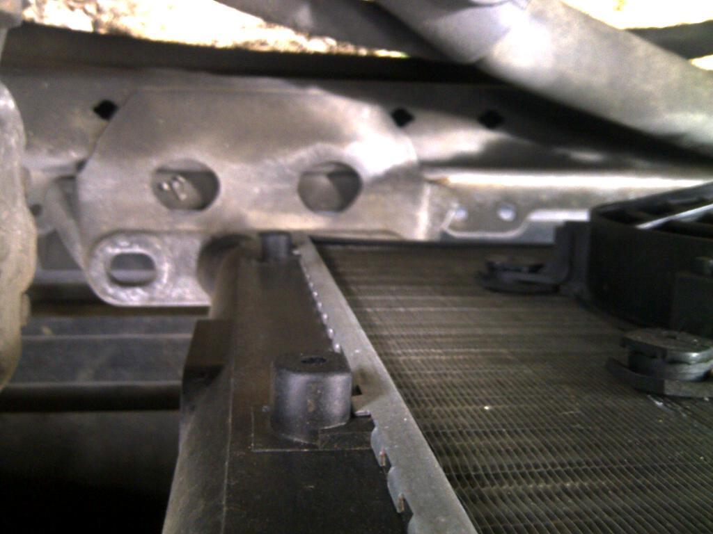

My next issues is mounting the polo radiator! Who's done it and what's the best way?

Mount it using the front crossmember and the mounting points on the front of rad. run a strip of metal between each point using drill and bolts then drill thru the crossmember parallel with the strips you have made then run 1 larger bolt thru each strip and thru the crossmember, then put the nuts on tighten them up and away you go.

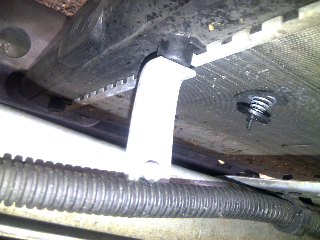

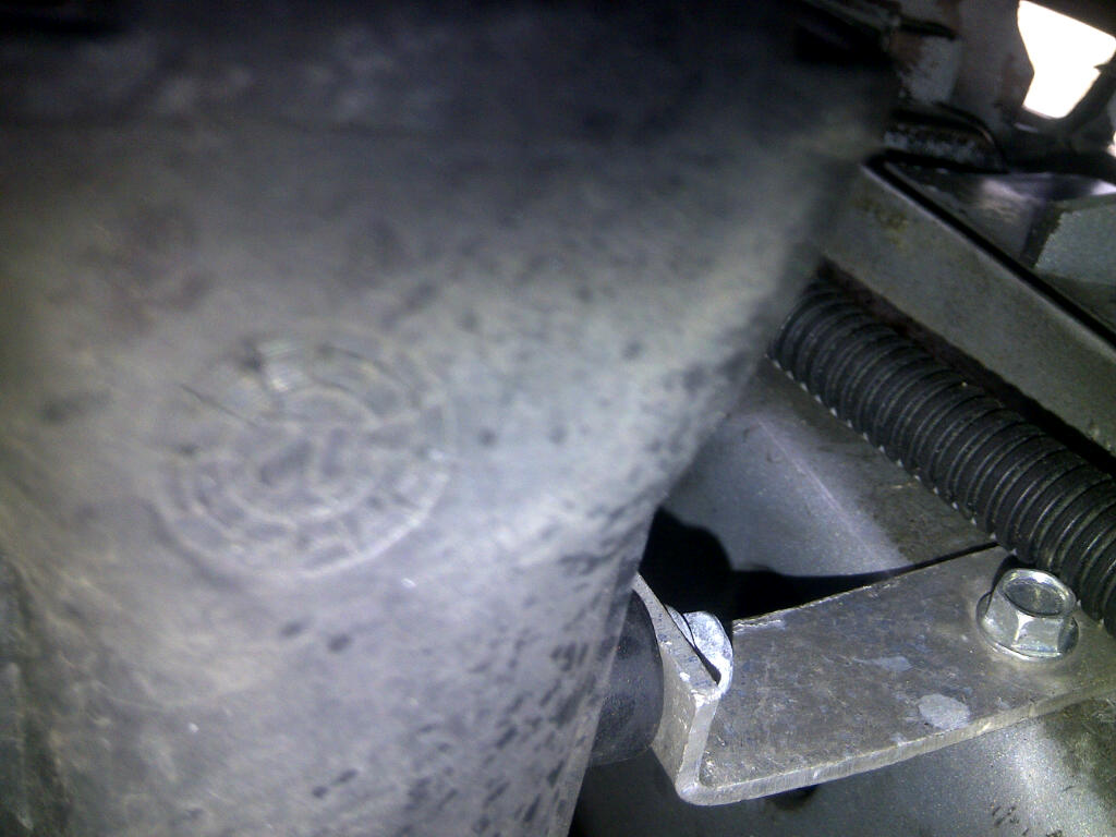

polo rad all i've done is used the rubber feet at the bottom and used a small bent piece of ally plate and used self tapper nut in 2 the cross member and rad, don't want it solid mounted with all metal brackets as the vibration will cause the rad 2 crack... give me 5 mins i'l see if i can get some pics of how mines mounted

2 little rubber grommets or something similar between the crossmember and rad with eliminate the vibration.

true but it just seems hassle, when it literally took all of 2mins 2 bend the little bracket i've made and then it has the rubber feet on the bottom 2 take the vibration etc, just trying to upload pics to photobucket now

the hole to the right of where the rad is sitting is where the original Rad used 2 line up with, as you can see i've used the rubber feet to locate the bottom of the rad and also takes up any vibration you'l get, covered a good few K with the rad mounted like this and had no problems

Could of told you they wouldn't fit. 90s are a squeeze on a ph1 bonnet with a decent filter, let a lone 120s. Swoops down lower than the Ph2

just simpler mate, i have seen the way you mentioned but they hadn't used and rubber grommets anywhere hence why i mentioned the cracking etc which is what put me off about it soon as i saw it
Ye I was thinking very similar to yours mate thanks
