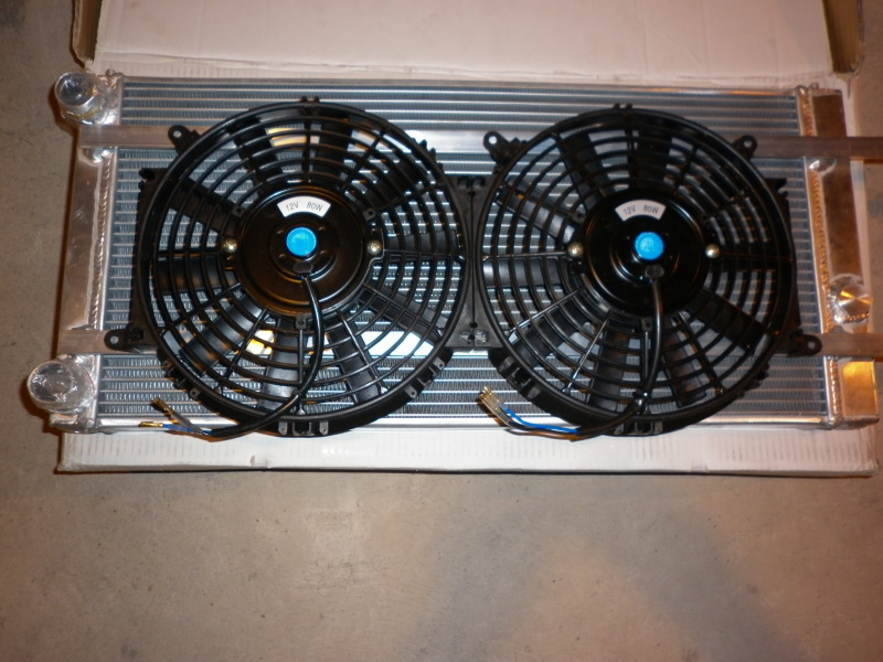

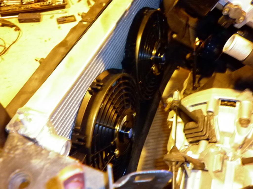

I prefer having proper mountings for the fan, I just used aluminium flat bar bolted to threads already on the rad , not keen on those straps as I have seen them rub through the element or just fall off.
I have 2 x generic 10" eBay fans and mad max' look to be the same.
Few pics
  RB 182
Does it make any difference cooling wise with the fan being placed slightly further away? Are they meant to sit flush with the surface? I can get the cross brace welded in work.
  Cup In bits
Look through Ian Speedys thread, he had nice shroud plates water jetted out and welded on, real nice way to do it.
