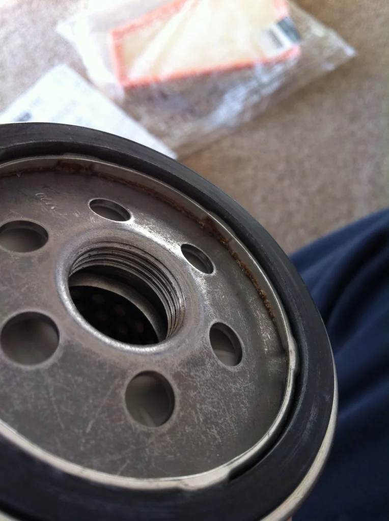

Is this oil filter faulty?
Austin-182
  182
Looks like it has some sort of glue (i imagine used to hold part of it togeter) coming out the top of it.

Yes genuine, from the guy you always recommend. Just hadn't seen that stuff inside them before.Cheers
