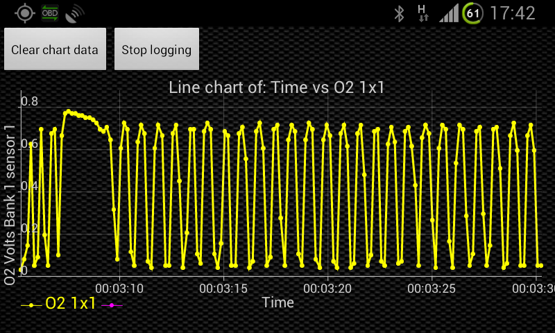

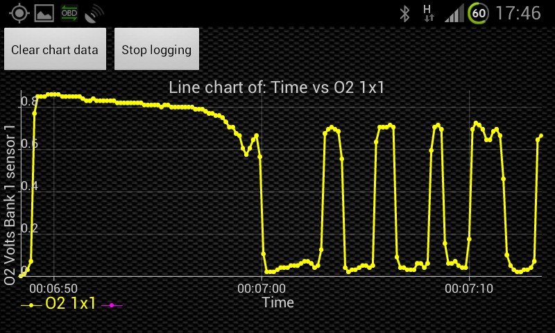

tickover begins at the beginning of the graph more or less probably at the richest point.
left it a while in my drive and this was result.
Driving at 2000RPM ish below, looks ok to me.

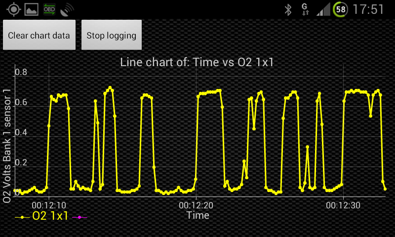

Update for anyone else who may come across.
Changed the Lambda anyway last night. cant tell any difference driving but on idle the fluctuations are stronger and more frequent. Also with the old probe it would sometimes flatline for periods of time.
Hardest part about the job was the f*cking plug above the subframe GOD AWFUL DESIGN. no room for 2 hands but you can eventually struggle with one I was expecting it to be seized in but it came out no dramas.
