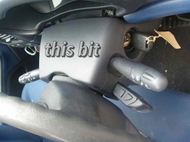

Can anyone tell me how to remove old wiper stalk!?!?
Wheel off (two metal pins on the rear), remove steering column cowling (3 screws, can't remember what size but are torx) and you'll see that both wiper stalks are held in by even smaller torx screws. There are two for each stalk and they slide out from the side, just watch the wires. There is a much more comprehensive guide on here somewhere ;-)

sorry to dig this up from the ether... My auto wipers have stopped working so instead of faffing about with gels and sensors etc I'd like to go to normal style wipers with off/adj intermittent/slow/fast & trip computer.
Does this exist for a 182? I've found this on ebay, anyone know if it will work? I can't tell if the intermittent is adjustable or not.

You want one with adjustable seconds between intermittent wiper wipes.
If that makes sense.
green
  Hi comp phase 1
That’s it... I’ve fitted one to my trophy. Straight swap.
