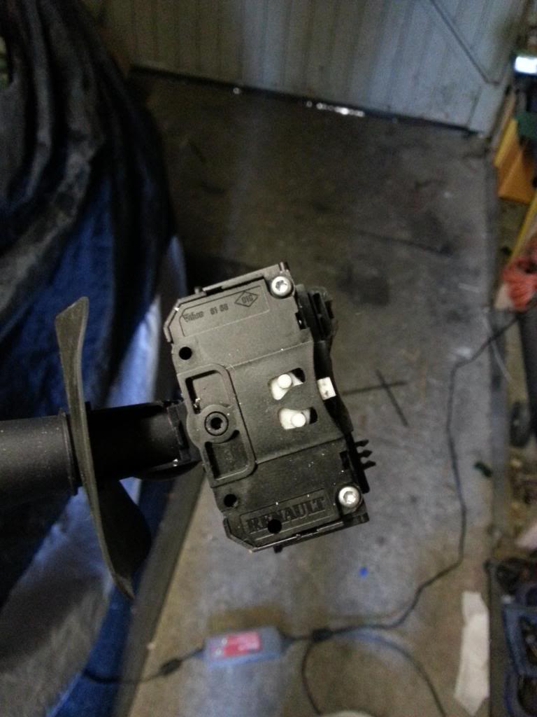

i wouldn't say its the ring, im almost certain it's the tag issue. if you take the ph1 stalk off, on the front of is is a small panel held on with 2 torx screws, it needs taking off and replaced with the same part from the ph2 stalk.
very. follow this to get the ph1 stalk off
http://www.cliosport.net/forum/show...ng-wheel-all-stalks-steering-casing-and-squib
then you'll be left with this.

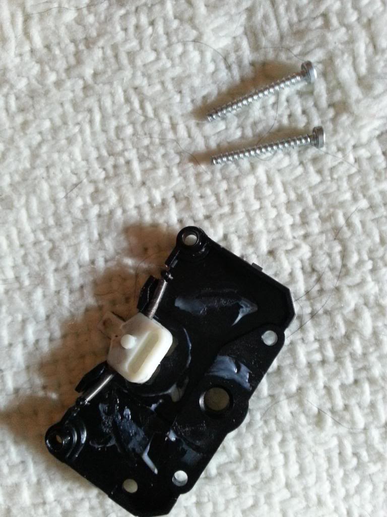

remove the two screws and prize (be careful) the panel off. do the same on the ph2 stalk and swap over and do everything in reverse.
Nice one. So i do all this and swap over the panels as pictured in your last pic? From the ph2 stalk to the ph1?
Sounds too easy lol.
Cheers for your help. Now to get hold of a ph2 wiper stalk.
yes mate, i changed to an aftermarket wheel and had the same issue. went out and bought other stalks, which also didnt work, then i changed that plate and it worked lovely.
