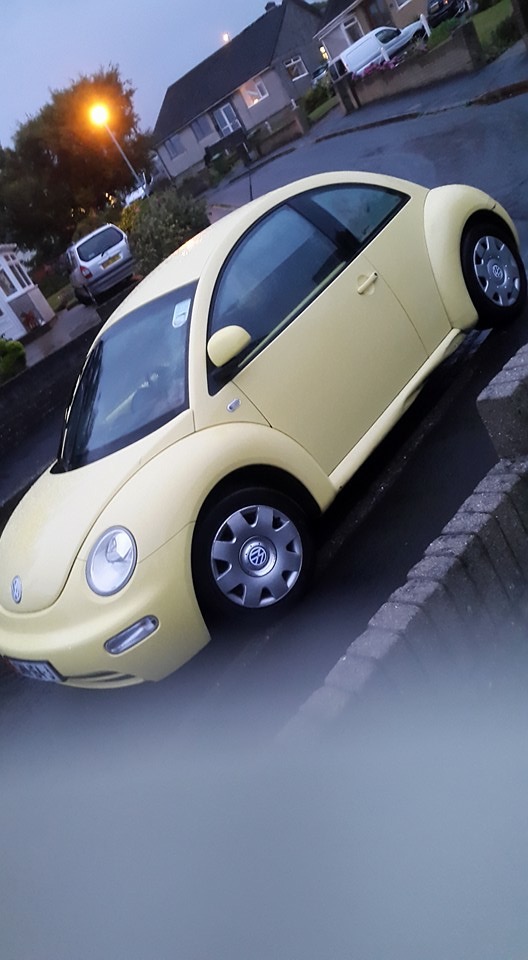

Absolute amazing car but previous owners had shitty flower stickers and the body work has had no love
It's extremely faded in areas
Best way to get the colour back....I'm too scared to machine polish

If you get yourself a DA machine polisher there's absolutely no need to be scared of using it.
I promise you won't do any damage. Just watch a couple of videos on YouTube and you'll be good to go.
Get yourself a kit like this https://www.ebay.co.uk/itm/171177663608 and you'll sort that Beetle out in no time.

These usually fade beneath the clear coat (Leons, Lupos, Golfs too).
Try a test spot with some polish by hand. If the pad turns yellow - you can save it.
If not - no amount of polishing will make it bright yellow again.

If it's faded there's a good chance it's a single stage paint, so it won't have a clear coat they use a hardener instead.
Much like the faded red Vauxhalls you see.
Ps. Is the side skirt meant to be that shape or is it damaged?

What type of polish do you recommend?
definitely a single stage paint and yup the skirt is damaged
I'd be more concerned about the battered side sill tbh.
its the only mark on the car and will be getting fixed - had it all priced up and ready to be fixed. But want to do some work on the paint before i get it done so colour can be matched and it doesnt look odd!
looks like some perfect lady driver has caught it on a high curb 😧
  Renault 5 GT Turbo
Do you have any polish knocking around?
It doesn'tneed to be anything fancy. Just a little abrasive to see if it can be saved.
Some easy ones to pick up are Meguiar's Ultimate Compound or Polish, Auto Glym Super Resin Polish.
Something like that worked properly into a few test spots will tell you if it will come up again or not.
