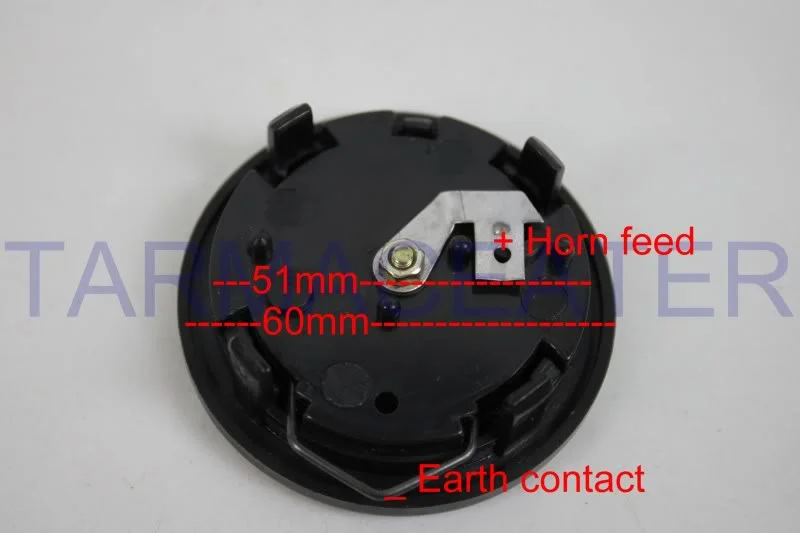

Cheers 1812lsd, I'm away from home for a few days so cant get any pics of my actual horn but this pic on ebay shows the back of a horn and its the same as mine HORNBACK.jpg
  CursedTitanium 182FF
For that horn push you may get away with just wiring the live to it, as the pointy bit on the side is the earth. Only way to tell is to test it. Put the live on the metal bit in the centre then just hold the pointy bit against the metal bit on the steering wheel & see if the horn works (Try and keep it still & in firm contact)
If it gives off sparks when pressed you may need to purchase one with two connections on the back, like this one that I have on mine: http://www.ebay.co.uk/itm/OD-1960-N...arts_Vehicles_CarParts_SM&hash=item4d0149ea16 If you do end up getting that, give me a shout & I'll give you a 60mm Renault badge to replace the OMP badge, no charge, just pay it forward to someone else.
