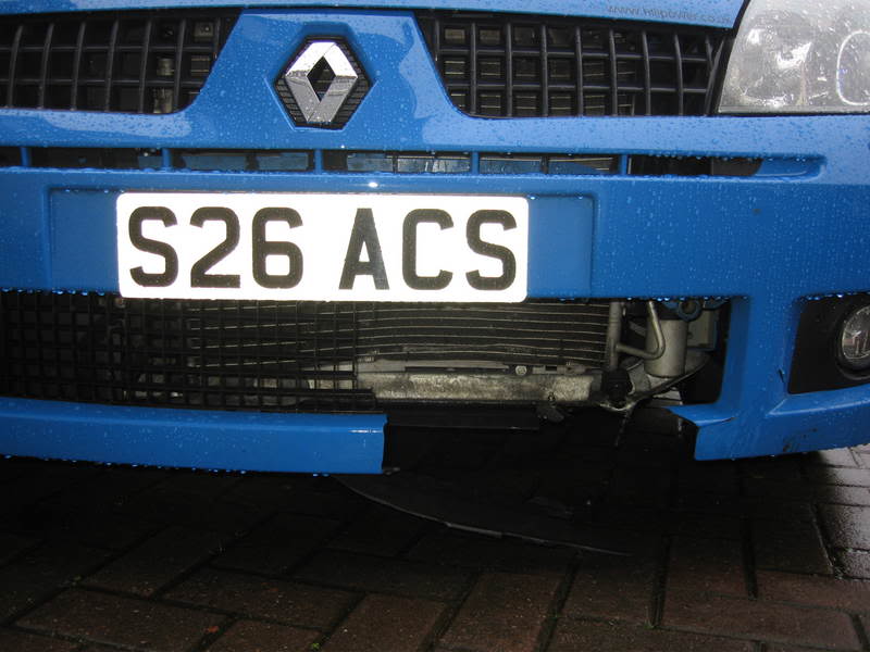

coming home last night and a badger ran out in front of me and took out my bumper, lower grill and has fooked the radiator (huge dent and pushed back)
thought it was a cat last night but went back just now to look for debris and there is huge badger in the road!
absolutley gutted
need a new bumper and radiator cos i think immi is sorting a lower grill for me
does any1 know how to take off the bumper cos i need to see wat the damage is like underneath

Andy, removethe bumper as follows:
1. Open the bonnet and remove the two clips in either corner of the top grille.
2. underdo the clips on the undertray that mount onto the subframe.
3. you need a socket and wrench with extension. Go to the front wheel arch. Where the bumper meets the wing you should be able to feel that the archline is flexible. There two bolts for each side.once the bolts are out. pull the bumper towards you. repeat for the opposite side.
4. disconnect washers and fogs.
5. any questions, drop me a PM.

Its your aircon radiator thats bent, it you take the upper front grill off you'll be able to see straight down to assess the damage better

gonna be an own pocket jobbie, cant afford to pay the high access and the insurance hike!

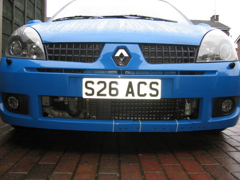

updte: i have temperarily fixed the radiators in position so they should hold for a while, the aircon works and the radiator and fan are working, its just the brackets that are fooked
trying to reaattch the bust bit of the bumper at the mo so it is drivable untill i can either get a new one or get this one filled and repaired

put it back on now, then glue the bit of bumper back in on the cup splitter and each end.
jobs a good un ;)
  VRS
i will post pics of my temp fix in a minute wen the bumpers back on! it aint pretty but will have to do till i can replace it
i can imagine it now..
some of art attacks finest PVA glue
some orange tape
and a kellogs cornflake box.
oh not to mention the tv classic, a fairy liquid bottle.
