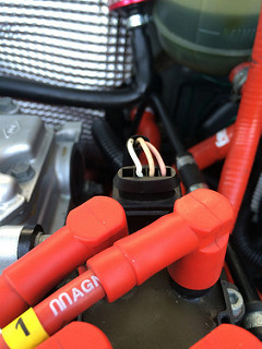

Ive got myself a DRE shift light and have read a guide on here about connecting to the coil pack orange wire. I just wanted to check with you guys that i have the correct one as the colour has faded on the 3 wires. I'm thinking it's the middle one ?
Any help much appreciated
Untitled by Andrew Greenwood, on Flickr
  172 Cup
Just fitted one myself, 99% certain it's the outer orange one.
Remember to set the unit itself to 2cyl due to the wasted spark ignition
That's made even more unsure as to me the outer one looks more pink ?? but I'll try that one first.
Thanks for the heads up about the wasted spark ignition.
