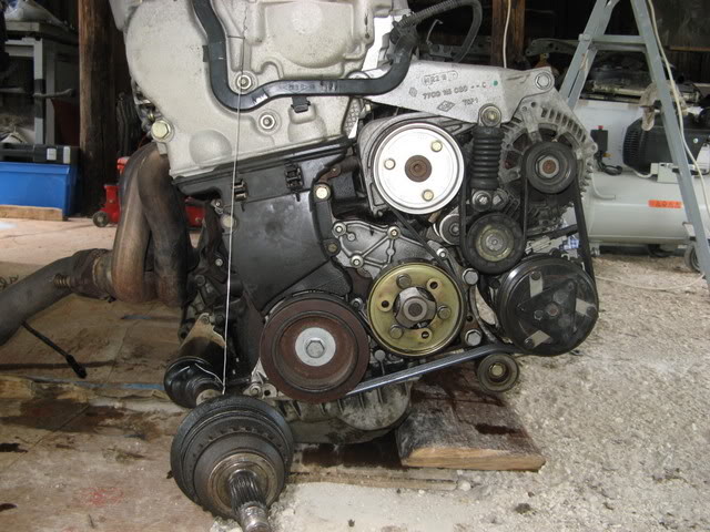

Make sure the belt is routed correctly, or by 20mm short do you mean youve put it side by side to the old belt?? If thats the case its the wrong belt. The aux belt kit should include belt, tensioner and idler.
Correct routing:

When I changed mine I got a Conti Belt, it was slightly shorter than the 1 that came off, but with a bit of swearing it fitted. As said above, make sure it's routed correctly.
