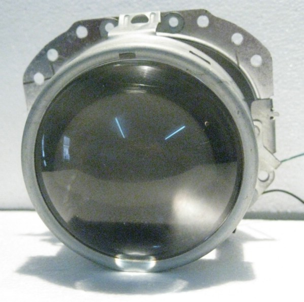

Projector headlight...

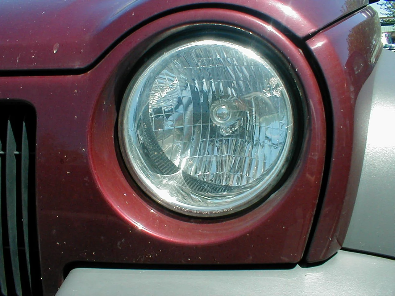

Reflector headlight:
The Projector just directs lights where as a reflector scatters it (with HIDs causing dazzling of other road users)
