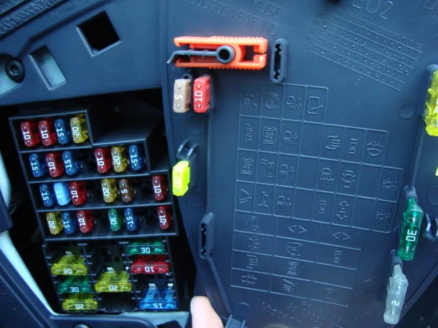

everything else seems to work fine, I have swapped fuses on everything to try and get an idea of what it may be but can't find anything. should I be checking the fuses under the bonnet? would it also help if i completely disconnect the battery to remove any chance of charge being stuck in the cables?

The one that sparked is the power half of the iso block, so I'm pretty sure you'll have blown a fuse. Look in the one on the end of the dash, and look for the picture of the headunit. That should at least get your headunit powered and working.
I did this in my previous car 5 mins before it was going in for part exchange and had a bit of a panic but it turned out to be a fuse PHEW!
