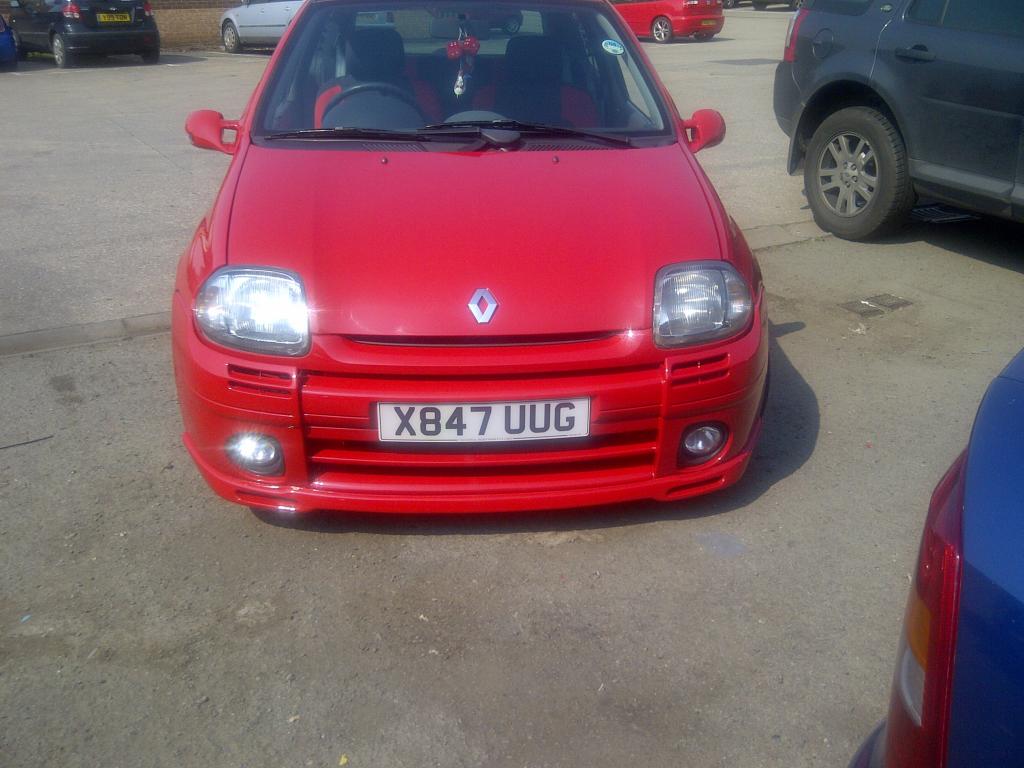

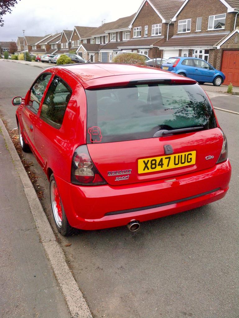

off subject but by any chance did you have your bumpers sprayed at a bodyshop next door to johnspeed mini's?
never seen you around nuneaton either :/
