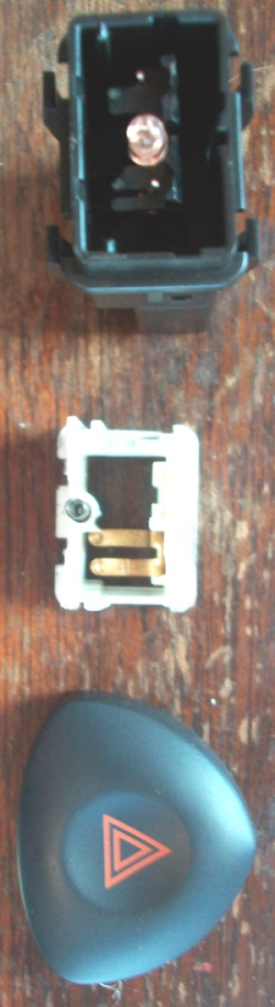

I thought I'd have a go at fixing...
This is what it looks like inside
It's fiddly and I wouldn't know where to start going about fixing it! Doubt it's worth trying when a new one's a tenner.

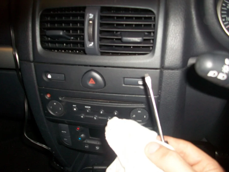

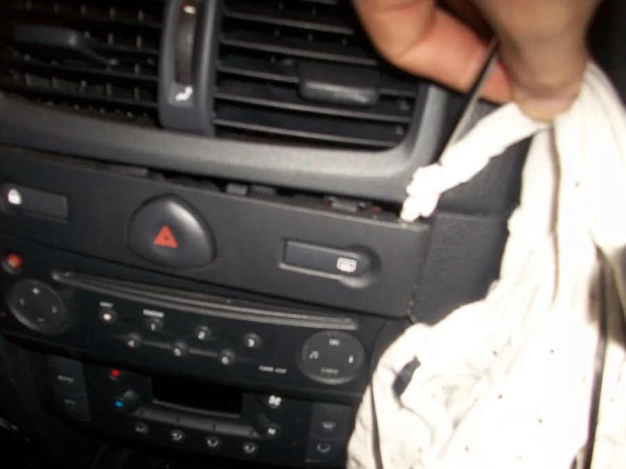

Get a small flat bladed screwdriver and a bit of cloth or a rag.
Put the cloth or rag over the tip of the screwdriver to avoid marking the trim
Insert the screwdriver into the top of the panel and then prise it out like so (using the fingers of your other hand to help):

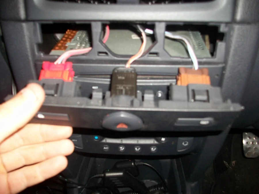

Now pull the panel outwards...

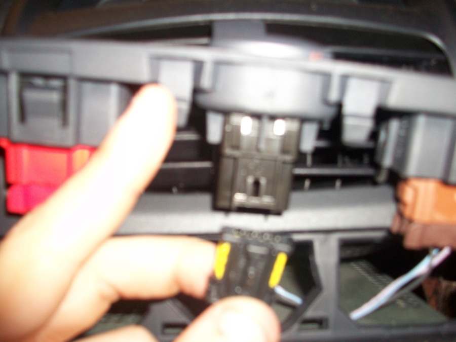

Turn the panel so that the triangle button faces the roof of the car to get at the connector.
Press and hold the tab on the connector down (in the below picture my thumb is on the tab holding it down) and then pull the plug apart from the switch

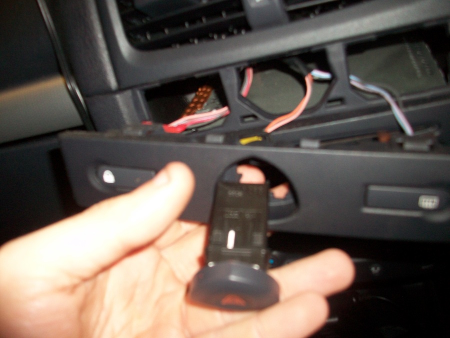

Feed the now disconnected switch through the front to remove it:

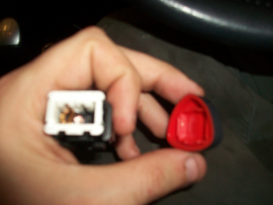

Now on eBay there are some sellers selling the switch plus the triangle plate, and others just selling the switch and you need to re-use your old triangle plate. If you need to reuse your old triangle plate, just pull it off the old switch by hand:
Then you can just push it on the new switch.

As long as you don't damage the paint on the side of the switch when you prise it off! I actually started off the way you did, but noticed the paint is easily scratched, and if you scratch that paint then the red light shines through it and you really notice! Check out the picture second from last (towards left) and you can see a bit of red on the triangle where the paint came off where the screwdriver was... that's why removing the panel is better IMO!
Scratching the triangle only matters if you're buying a switch without the triangle of course. If you don't need to reuse your own then it doesn't matter.

Thanks for that Pendulum, really appreciate that. Hazard light button is now out and will be ordering a new one next week. Nothing scratched either. Wrapped a cloth around the screwdriver...
