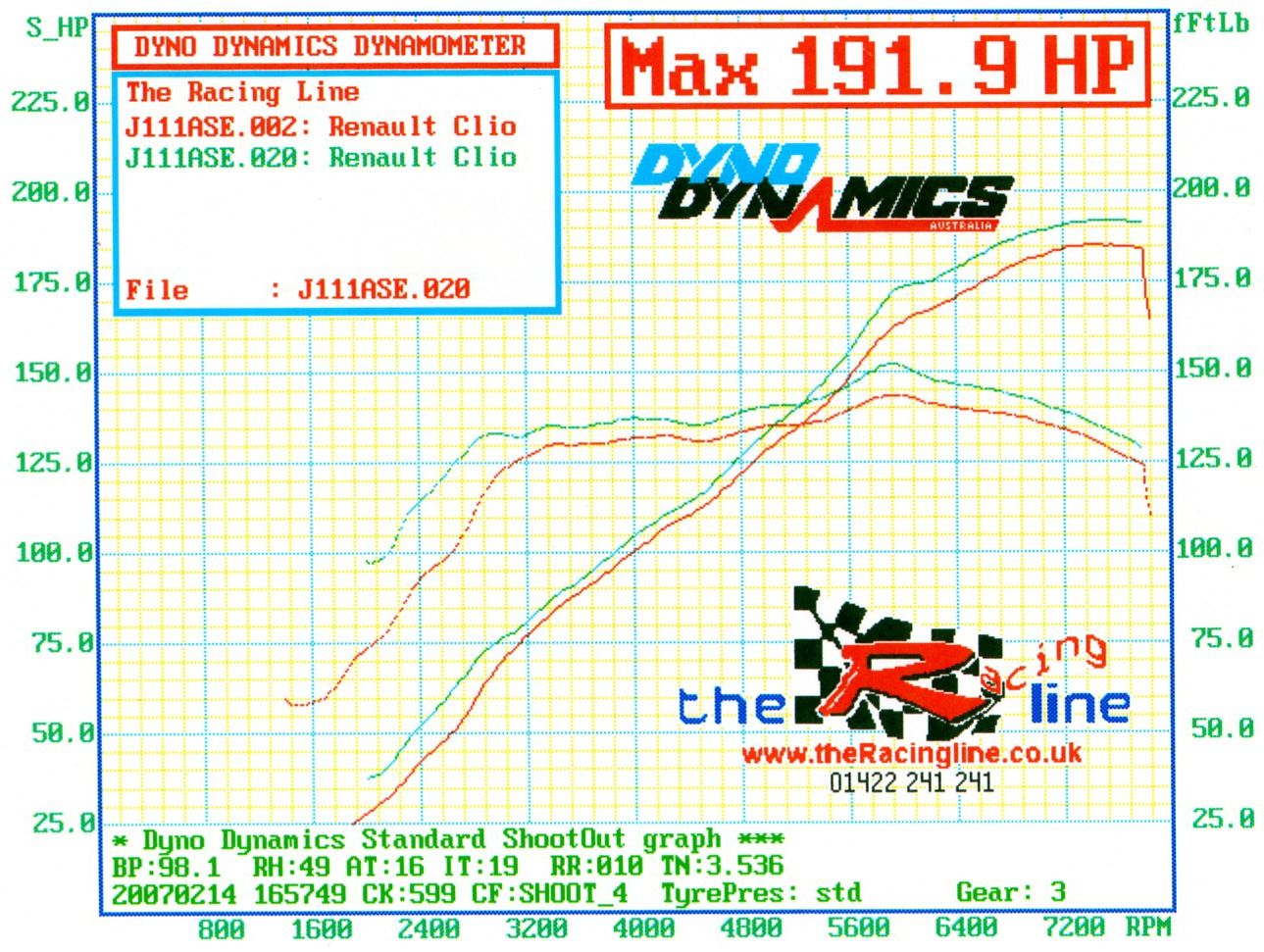

Direct before and after to show the gains.

Paul was that on a standard car.....forgive me im not used to examining the graphs but has the torque been increased low down and by how much? Did it seem to reduce the hesitance of the engine at all if the owner experienced any? and is it best to run on 97/98 as the filler cap says 95 and 98..... thanks

Its at low revs when you can really tell the re-map.
Look at the graph, standard at 2400 rpm gives around 105 lb/ft yet the re-map gives 127 lb/ft!
Thats over 20% increase!!!!
Believe me I had my 172 mapped there, its a big difference low down.

I think I understand it now,it makes about 6bhp difference accross the rev range and torque is up a lot low down. Can you tell me then how its affected the way it drives, gear changes fuel economy etc? As im only considering this and an air filter plus higher octane fuel thanks

the car drives great now.
it pulls so much better right from the word go all the way up the revs and through ever gear.
it has helped get rid of the flat spot low down.
and helped to get rid of the need to gear change quite so often as it now starts to pull as soon as you put your foot down without having to change down a gear or two.
the car wasnt completely standard it has a ITG panel filter.

Always manage over 40mpg, always run V-power or BP Ultimate. Economy if anything is better, even when thrashing it:quiet:
Go for the ITG panel filter, about £45.
