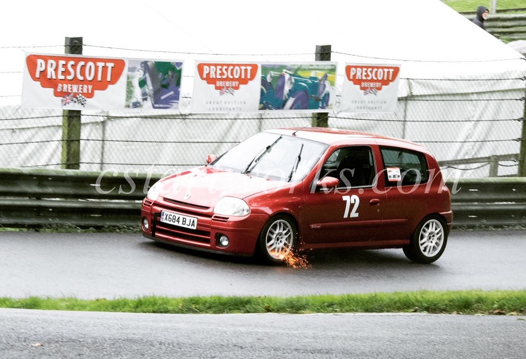

I seem to be the exception to the rule never had an issue with either pulling to one side or reliability (touch wood) in over 2 seasons on the hills.
And i'm seriously hard on the brakes:

Awesome picture. Metal on metal there, did your pads delaminate? Maybe the pump, master and sensors are different on a ph1? Dunno just find it gash.
No the RC6's are so savage it just chews up the discs up I go through 2 to 3 pair of discs in a season.
