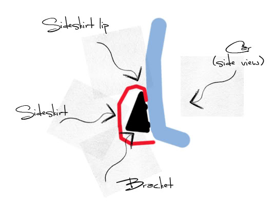

do the RS skirts have a lip on the top of them like the replica skirts (seee pic), do yours clip on by the lip slotting between the sideskirt clips and the bodywork
Thank you. The skirts do have a lip on them, but only so the brackets can get underneath. I didnt need to use any adhesive to stick them on as they are hooked onto the brackets then have 5 bolts along the bottom.

so am i right in thinking they work like this
Yep, Thats how they work.. then there are 5 holes along the bottom of the side skirt that bolt on.. However my car didnt have any holes along the bottom so had to drill them. then I fitted size 10 bolts/nuts and painted them black with a touch up brush.

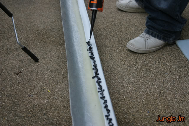

Heres a closer picture for you..
I lined up the brackets on the reverse of side skirt, then marked the center of the each brackets on the reverse of the side skirt with a marker. I then measured the distance between each of the marks I made then used that to get the positioning right when drilling the car. After drilling I put black silicon in the hole and put the bracket in place with the rivet. Hard to explain, hope hope you understand!

i just wanna confirm that the lip of the sideskirt get trapped / slots down between the car body and the bracket, like i drew in that pic, is that right. just wanna check they work that way so will be ok for the replica skirts
  Ultra Red Clio 197
Yes thats how they work.. though im not sure if its going to work ok with replica side skirts.. but give it a go! I used to have the replica skirts and although I didnt fit them, I know they were a right pain to fit. The genuine RS skirts fitted easily leaving no gaps that needed filling.. I was surprised at just how easy they were to fit.
