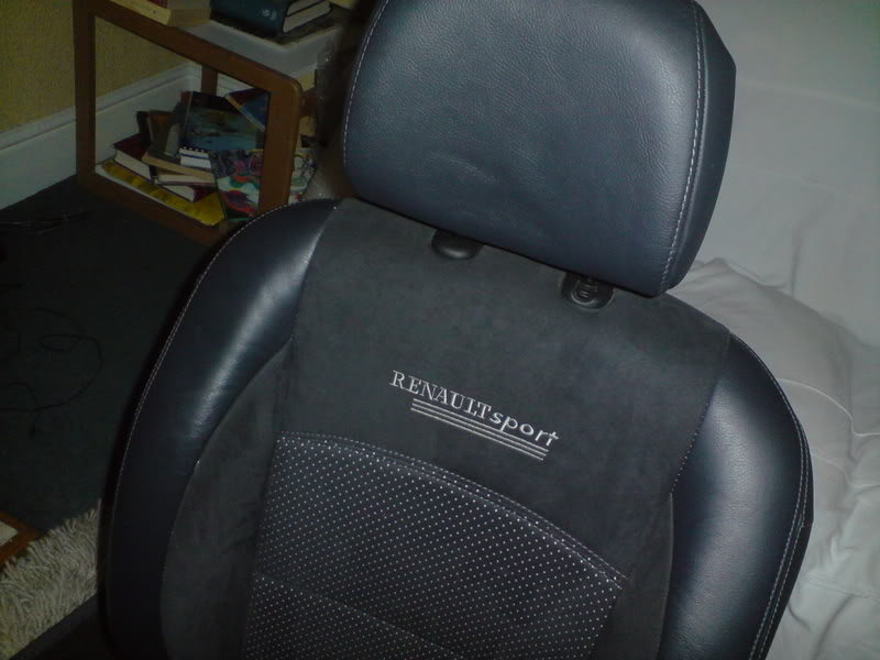

The car is nearly all finished off now, perhaps apart from some xenons. Didn't cost me too much, just need to get them fitted now. £340 for fronts, rears and doorcards. From an 05 plate in absolutely mint condition. Anyone got a guide to fitting these seats into my MK2 Phase 2.

I tried looking for some guide couldnt really find anything. Is it that easy? I put the rear bottom bench down because they just clip out! Do I just unclip the doorcards off? What about the front seats, do I have to get under the car?..
