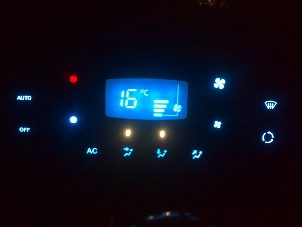

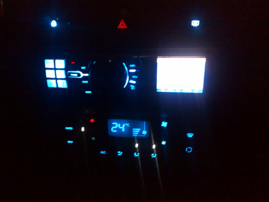

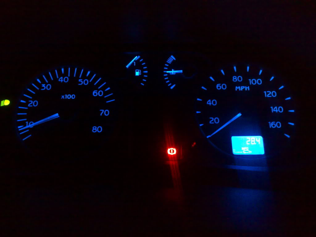

finally after a few brown pant moments..
  Monaco 172
a bit of blue!

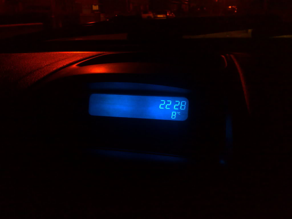

as for the clock...get this...

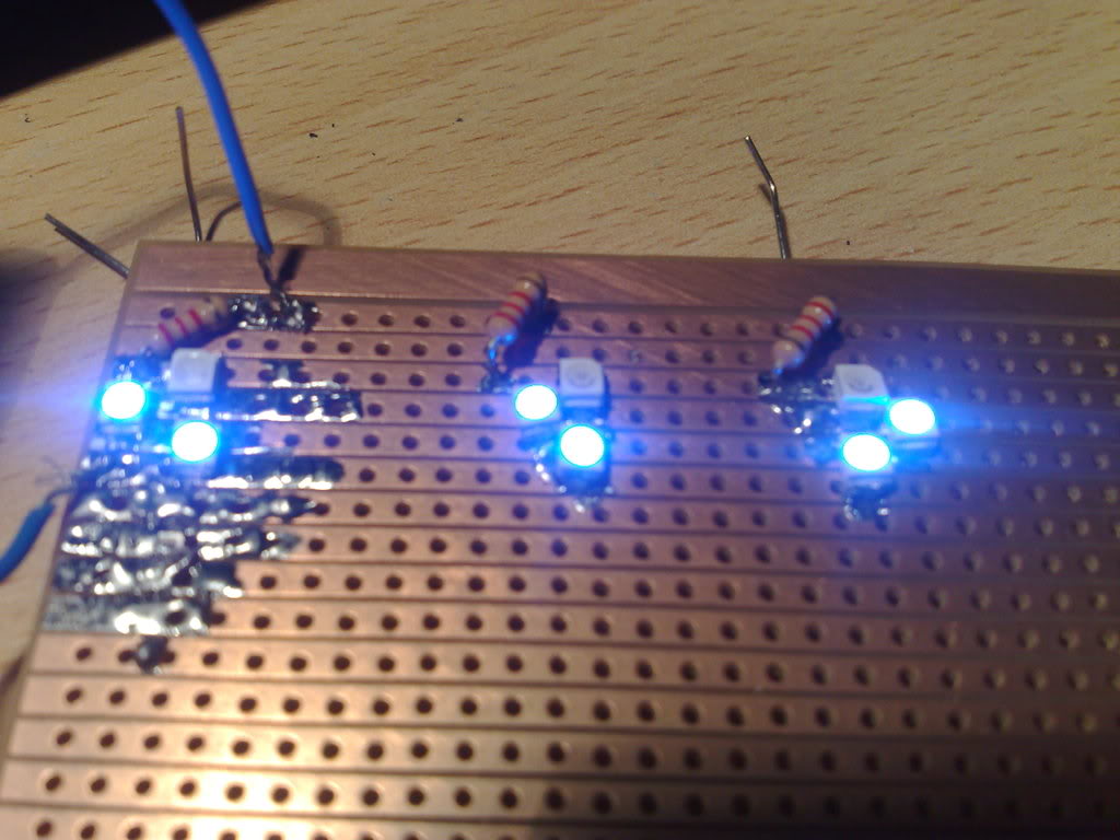

piece of strip board, with 2 series circuits, each with 1 82ohm resistor (as recommended by 24seven) and two or 3 SMDs, those two circuits in parrallel. make two of those as small as you can. then connect them to the contacts at the back of the clock. and put a piece of paper between the filter and LCD screen to dull the glare of the LEDs together!
i never took pics but heres one i was playing with....
you get the idea!
