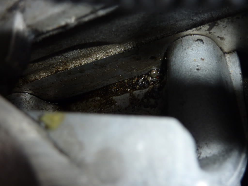

Thanks guys but mine might be more sinister; Rocker Bolts leaking?
I've found another thread and it's expensive to fix, any thoughts?

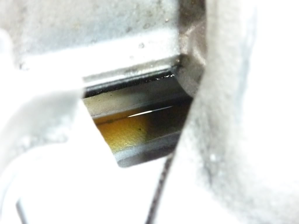

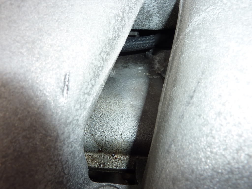

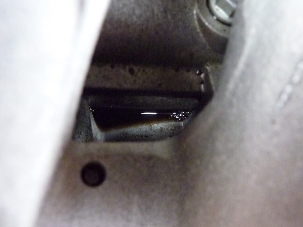

I Bet yours doesn't have this reservoir of oil sitting on the engine.
I think the first picture with the fresh oil could be spillage from when I topped it up last, I'm going to clean it down and monitor it.

looks like your engine is primarily using oil through leakage. However, you've put the wrong grade in, and this may well be burning faster

if its just the rocker cover gasket it wont be expensive i wouldnt have thought, havent done it myself but i imagine it would be a DIY job. Oh and check it when its cold not hot
Most of them leak there a bit, mine does aswell, its definately not your cause of your litres worth of oil......else it would definately be pissing all over the engine and the odd drip on the floor i shouldnt wonder and your bay would look a total mess after a few thousand mines at that consumption.
Ive had everything done by Ktec....cambelt, dephaser, replacement cams (as mine were bent at the ends by previous owner knackering the slots), so the gasket will have been redone on mine, i still have little pools if i look closely not as bad as yours but definately there.
