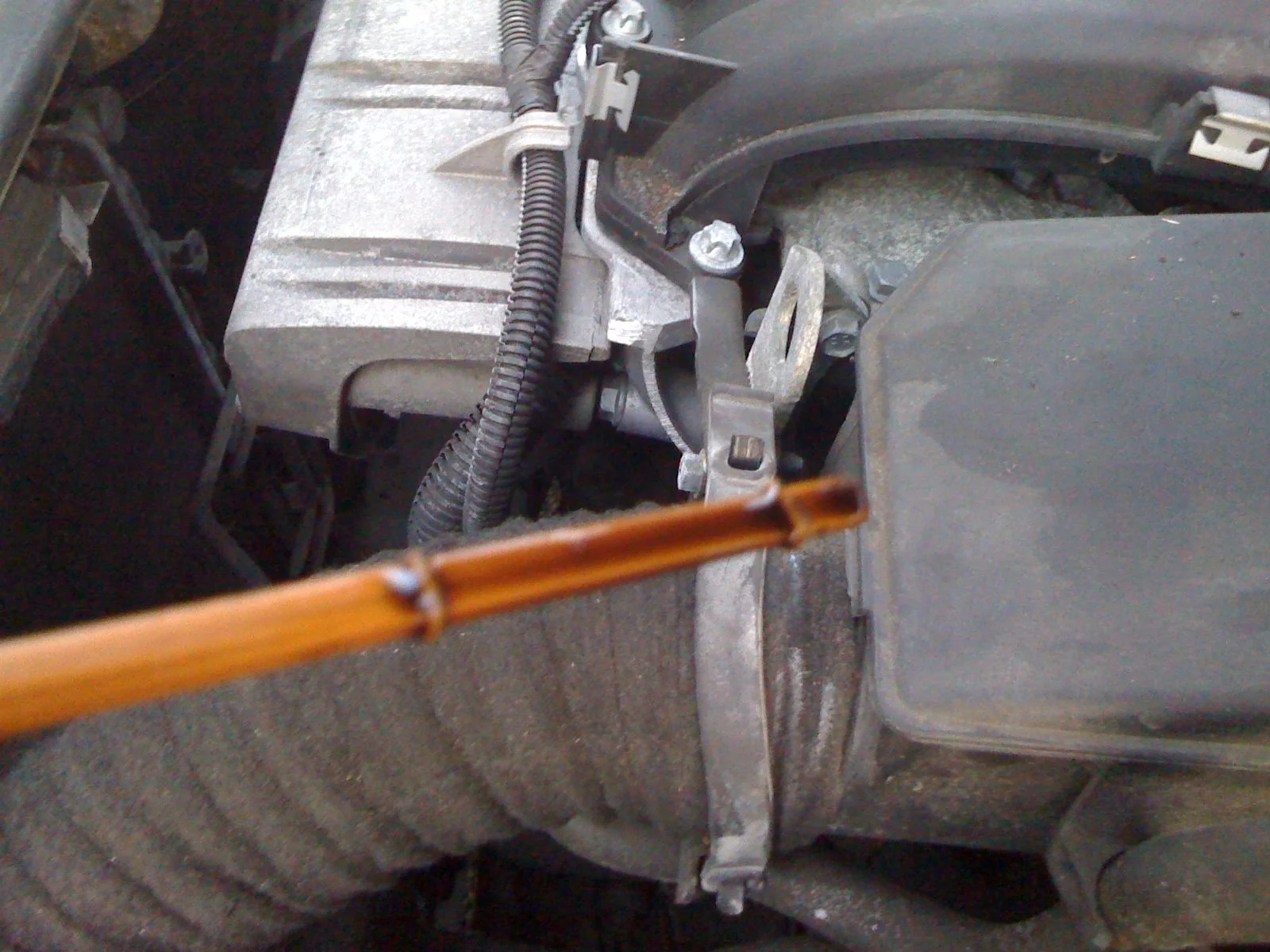

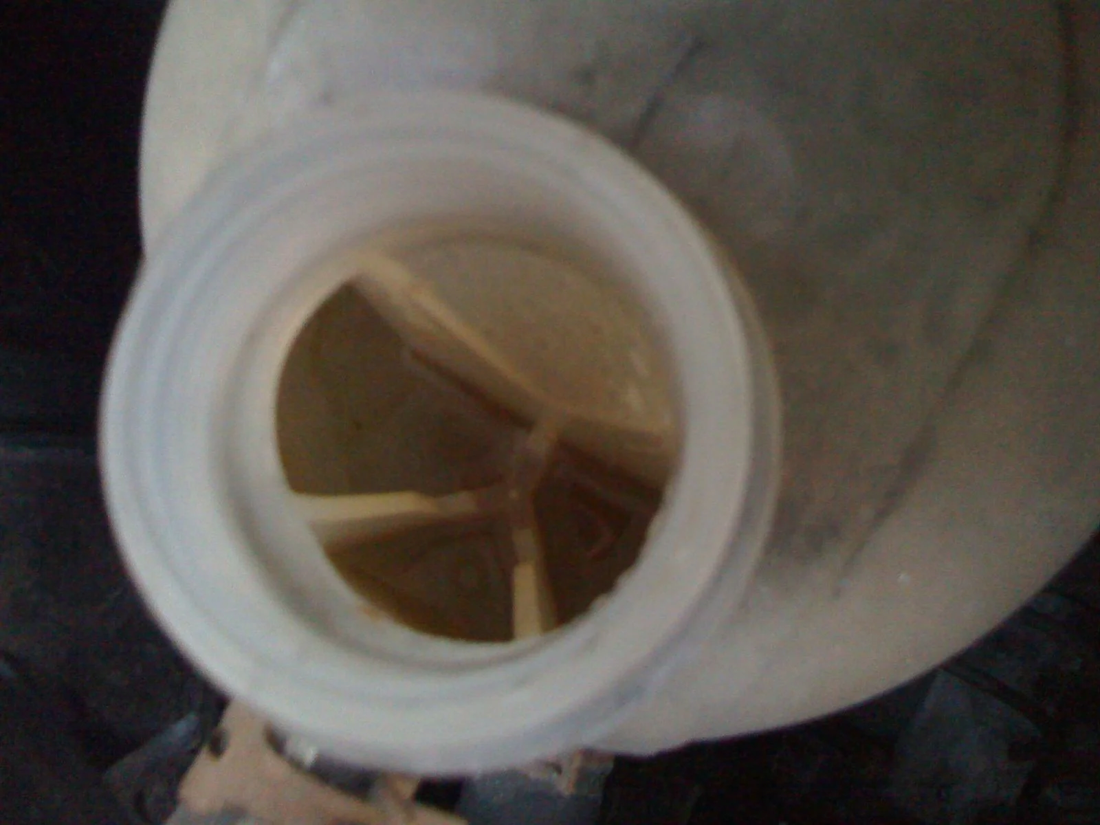

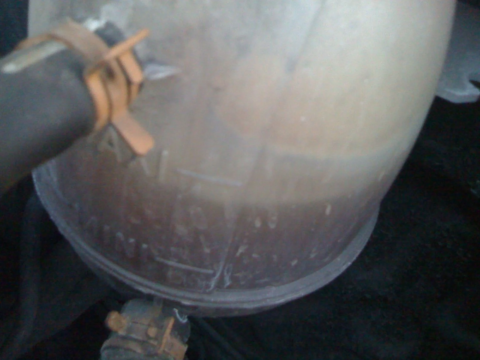

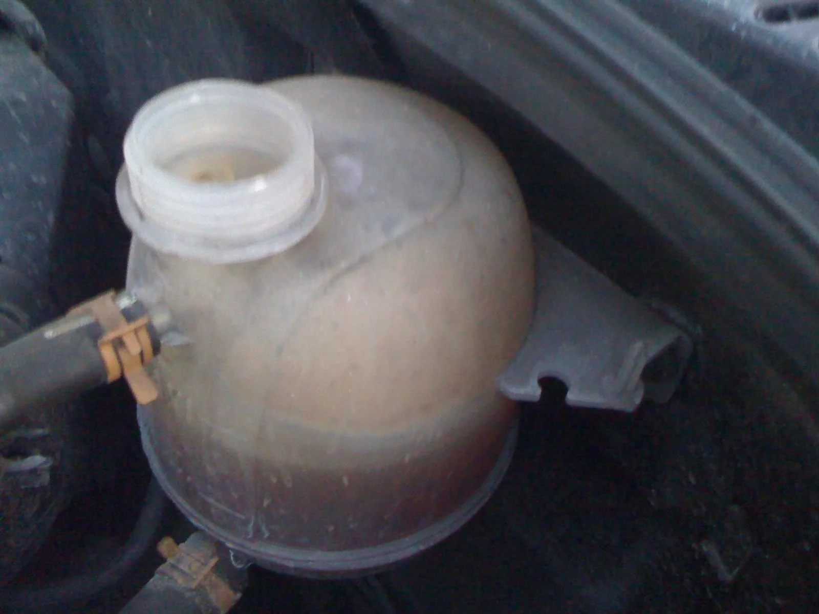

Now guys, just got a car today and just checked the engine coolent and its quite murky it looks worse on the outside than it actually is lol , I have checked the oil and it looks fine to me.
I was just wondering on whats the best way to flush it out. Im a student and not really up to the level of your knowledge yet lol, heard the best way was to put a hose in there until its all out then refill it.
I attatched some pics so you guys can see.
Any help would be appreciated
Cheers
Tom

Haynes manual should cover it. it depends upon the way the circulation runs - usually need to remove the top and bottom rad hoses to flush the rad, and mebbe the thermostat/housing to flush the engine

Ideally you will want a full flush otherwise the new coolant will look murky again in no time.

Bleed it by disconnecting the lower rad hose, and open the bleed screw on the thermostat. Then put the hose back on, refill with new coolant leaving the bleed screw open, close the screw when coolant flows out with no air in it, then keep refilling until the bottle is full, go for a drive, let it warm up, turn the heater on, then refill if necessary.

Yes, undo bottom hose and top hose and flush through both ways with yer garden hose and flush out the filler/bottle, even better take of the bottle and clean it out thoroughly in the sink. I could not access the bleed screw without removing the airfilter box. so-----
1. refill with Halfords advanced ready mix.
2. Leave the filler cap off, turn the heater fully on and start engine and all the air will escape through the filler, as the level drops keep topping up the bottle with coolant until level stabilises and no more air bubbles escape.
2. Refit filler cap and run engine until the electric fan switches on.
3. when your happy there are no leaks. re-top up the bottle drive normally and check the coolant level a couple of days later.
