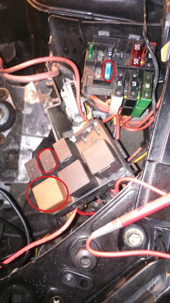

So on the advice given in the thread I've stripped the trunking and tape off the loom from the ecu right down to where it branches off and then a bit further up where the loom goes underneath the battery, couldn't see any breaks in the twisted wires or any others, so started looking at the fuses and relays with a multimeter, all of them came back fine except the ones outlined in the pic below. The two relays and the blue fuse were reading 0. Checked underneath both and couldn't see and loose wires or breaks. Really stumped now :(
