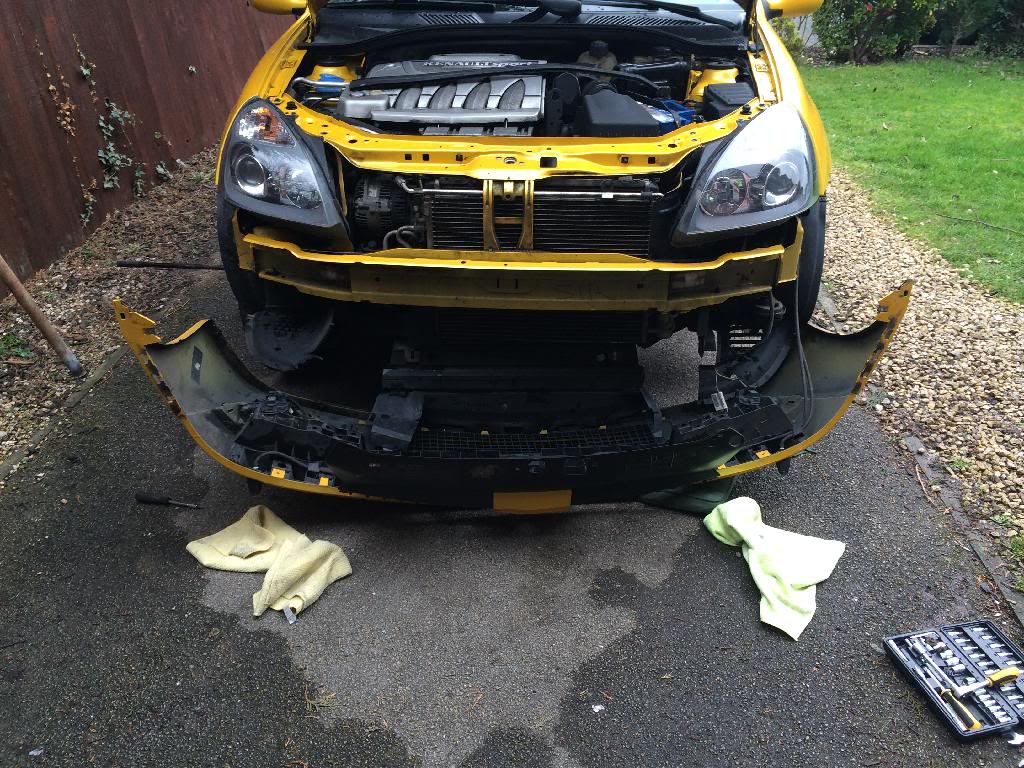

Easiest way to remove radiator fan?
  dan's cast offs.
4 bolts, 2 top, 2 bottom. bottom ones are a bit fiddly to get to although the housing is slotted so you don't have to take the bottom bolts out.
Can i do them without removing the slam panel?
Tried to remove that but the last two bolts are facing inwards to the engine and a PITA to get at!?
Coops Mk1
  Lots of Scrap...
don't need to full remove the bolts on the cross member, just loosen them with a 13mm spanner and the slam panel slots off them
  dan's cast offs.
You've only got to crack them off a bit. It's worth taking them all the way out when the slam panel is off and give them a quick clean and.throw some copper snot on them.
Where a bouts could i fit a hammer between the radiator and the nuts! :S
