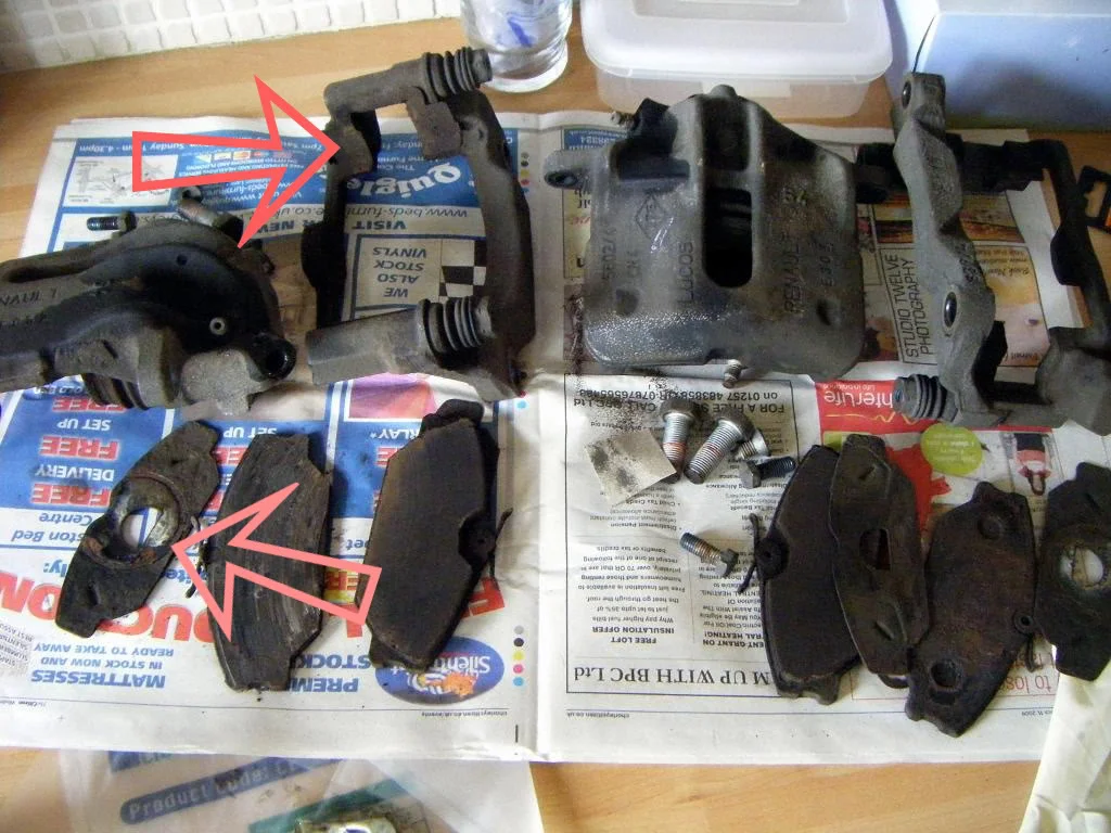

Thanks for the advice everyone. Can I confirm the shims that need removing are BOTH of the ones highlighted? The reason I ask is the bottom ones which look like 'pad spacers' were not present on my setup so were obviously not fitted. The smaller ones that go on the ends of the pads are on there.
I imagine the 'pad spacers' might cause binding but the smaller ones may not? If they both have to go then I'll get to it. I'm replacing the rear disks and pads this evening.
