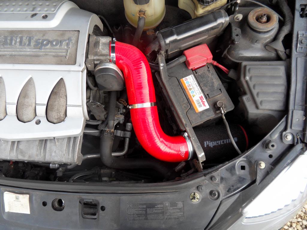

Morning all,
Just fitted my DIY, ktr-style induction kit.
Seriously impressed by the noise. Quick question - worth removing the acoustic valve or just leave it on?

Definitely remove the acoustic valve, only takes 5 minutes.
Your air filter is an " open filter " now . Why remove the acoustic valve ? It's not linked to your air box anymore so will make no difference whatsoever .
Just thinking about airflow. Guess since as it serves no purpose it's best to get it out of there.
Exactly so why would you want it there? Just a pointless part.

I made a quick setup earlier in the year a day before a trackday, then ended up leaving it like it.

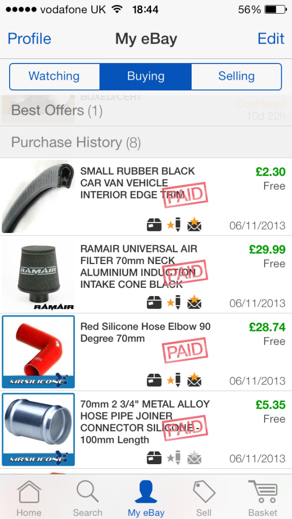

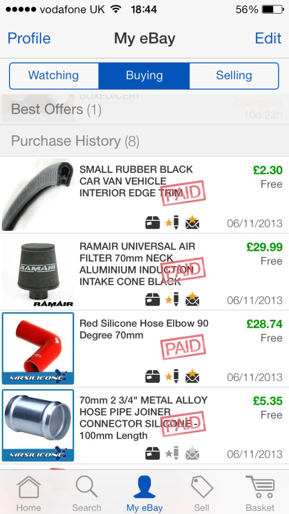

This was my shopping list:
Everything from ebay :)
Two of these: http://www.ebay.co.uk/itm/Silicone-9...item2c71a08a73
Three of these: http://www.ebay.co.uk/itm/70mm-90mm-...item27b98d4e4c
Two of these: http://www.ebay.co.uk/itm/Alloy-hose...item255f8beb16
One of these:http://www.ebay.co.uk/itm/Mini-Air-B...item2c71a8bff2
and a cone filter.
I used this one: http://www.ebay.co.uk/itm/Pipercross...item19e50bd3a3
But there are cheaper filters out there. Look for one with a 70mm neck.
