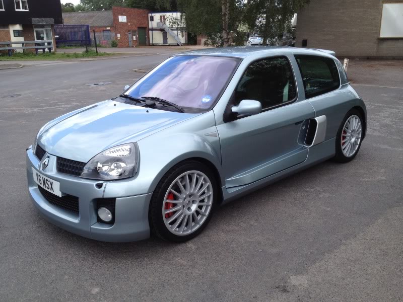

Thanks to you all for your advice. I wimped out of CSS as it's miles away from home plus I'm already going to Kimbolton this year with the V6 guys.
A really nice chap from a company called Dent Repair Service has just left, he did a brilliant PDR job for £70 and the car now looks perfect again. Once he inspected the quality of the respray he had no hesitation going the PDR route as he said it was a top class job.
Ed is happy again :)
