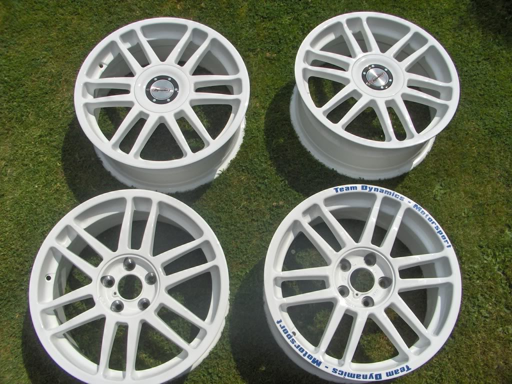

Right picked these up a few days ago currently undergoing a re-spray
info is
7j
et-45
R17
whats the difference between 7j on these and 7.5j on my standard R27 rims? could i still get 215/45/17?
They're narrower, probably want to use your standard wheels on track for more rubber contact, your handling will be better.
I think 205 width will be the max you'd want to run on 7j. Woops.

fook that Tucker! there spotless lol
