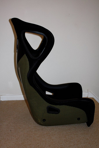

ATM I have a corbeau Revoution carbon Kevlar seat in my bus.
[/url]
IMG_7151 by fletcher10, on Flickr
