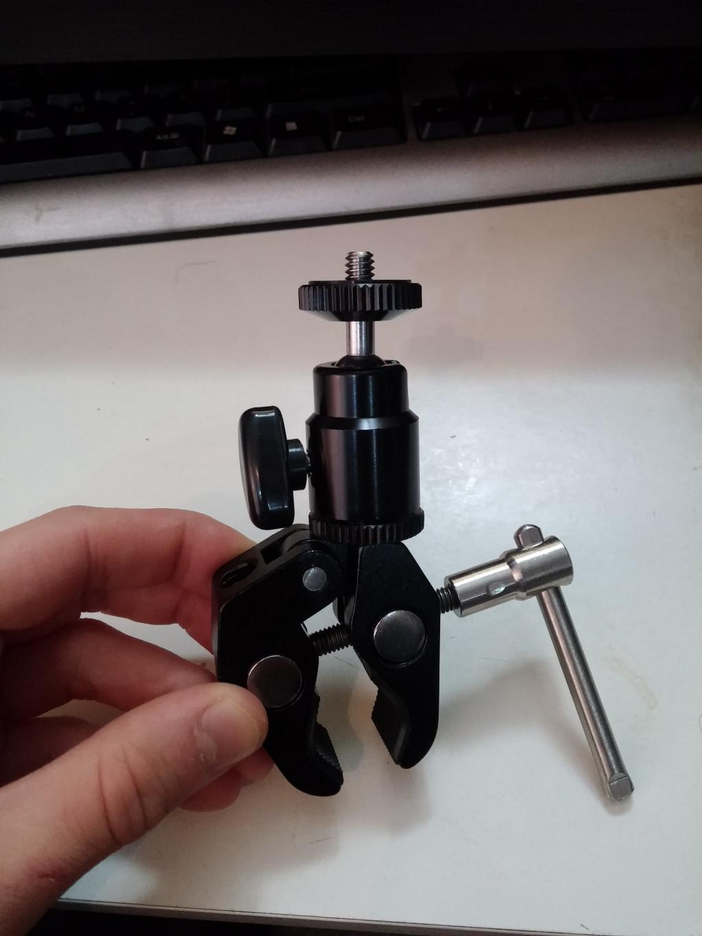

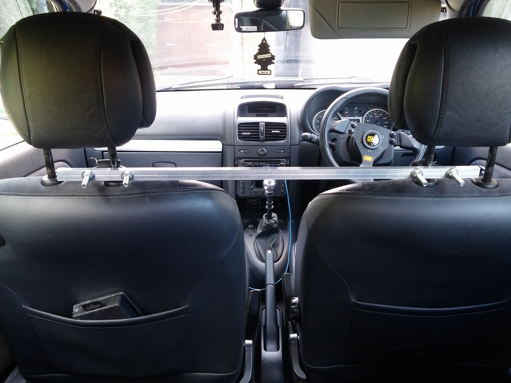

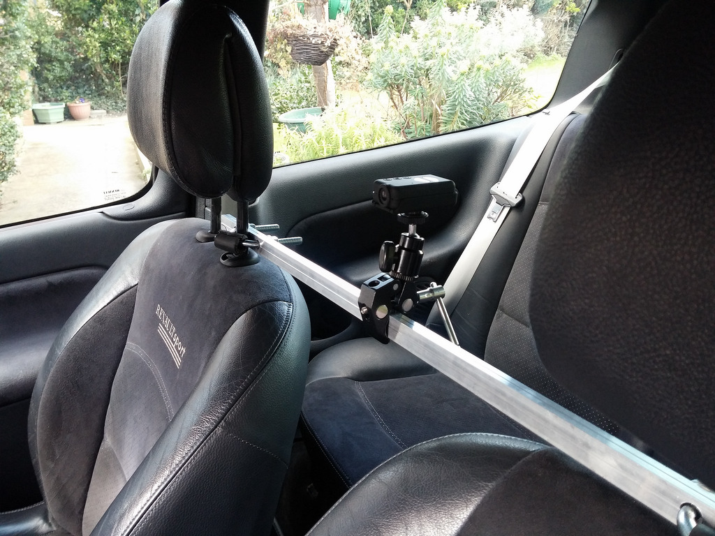

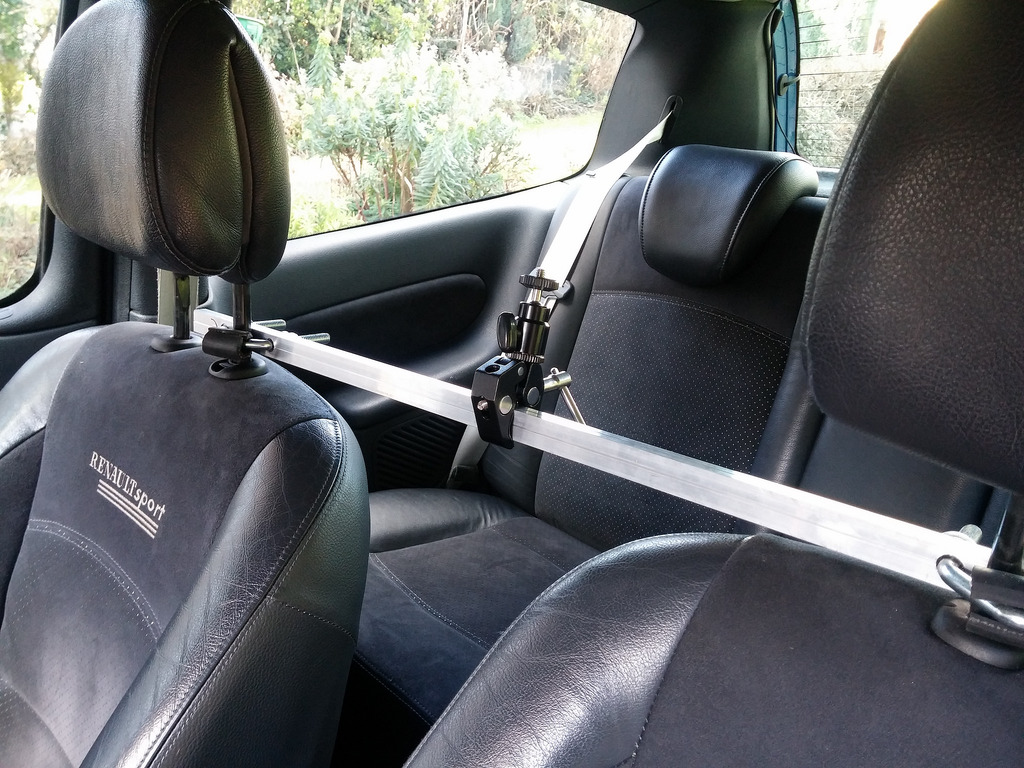

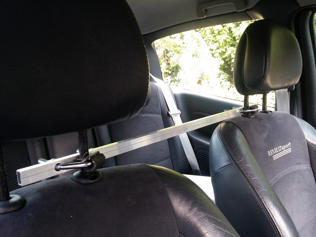

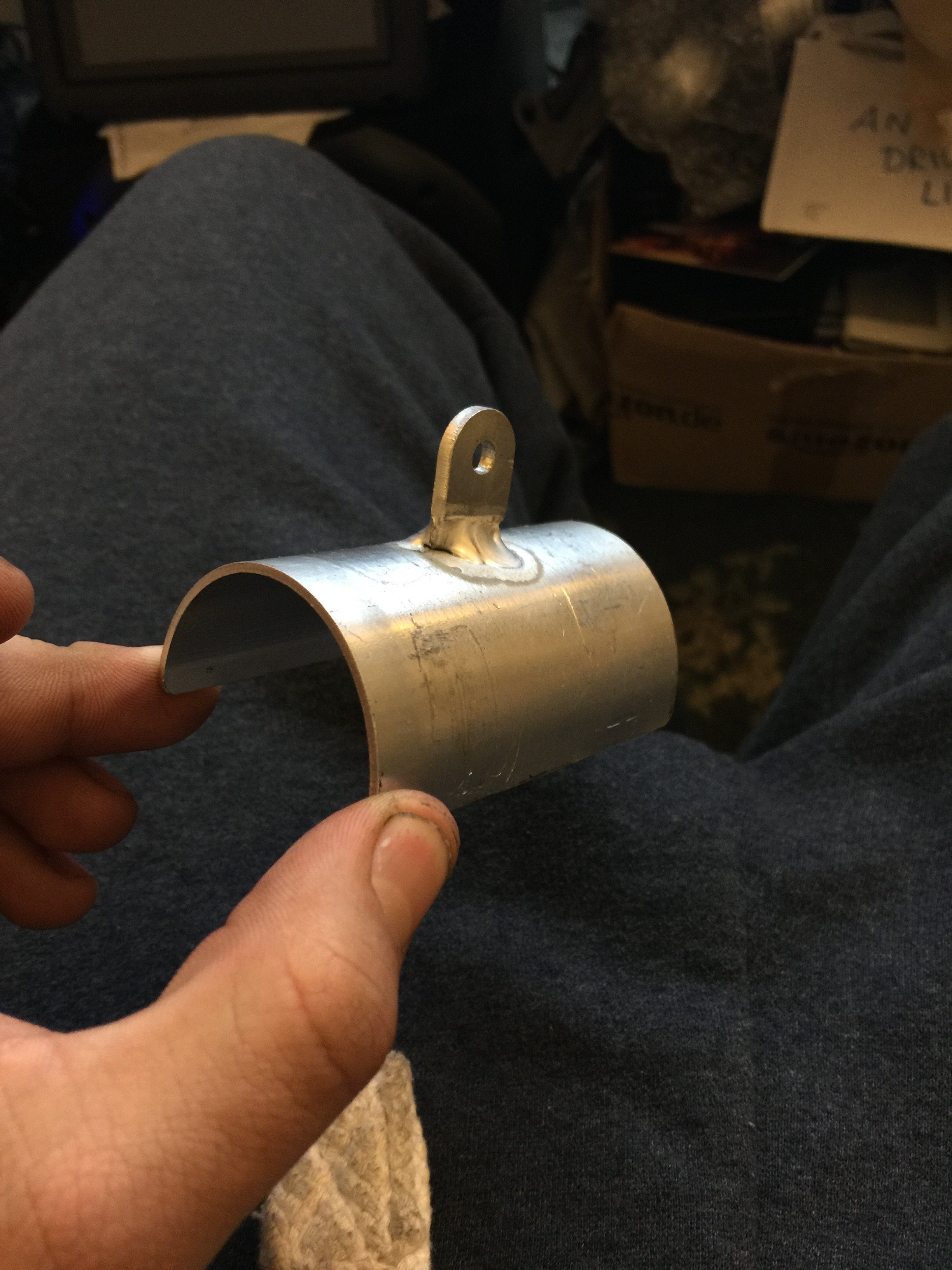

Started the making of my dash cam rig for the track day. It's consisting of one of these:

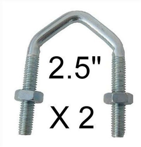

And two of these:
I'm then going to get a pole from B and Q or homebase and drill four holes in it and get the U clamps around the headrest poles
Thanks to @JamesBryan for the inspiration :)

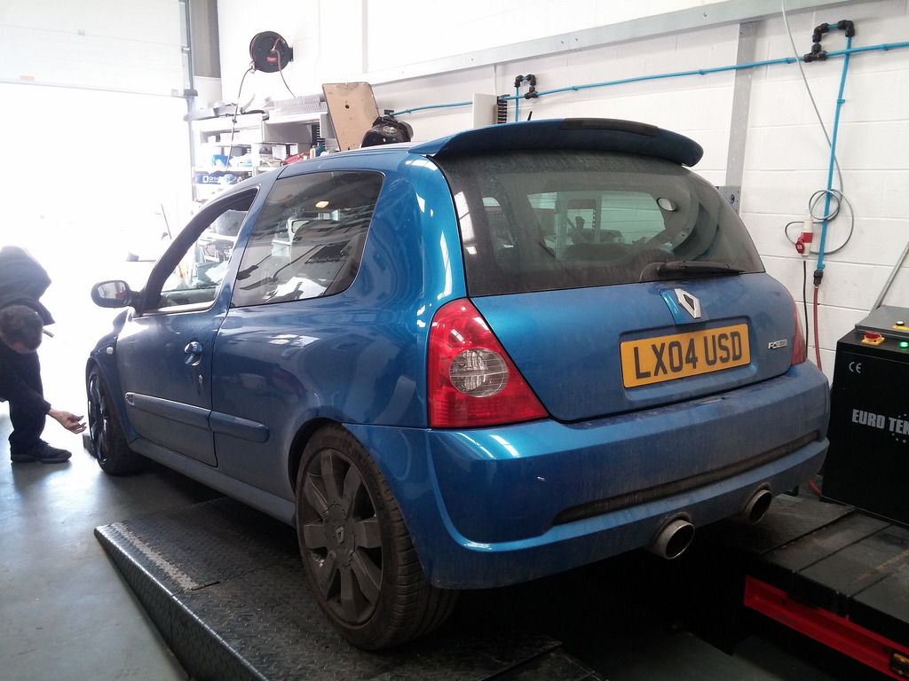

Got a car corner weighted today. It was fantastic. I also saw a fellow clio 182 owner of the Arctic blue variety. Got it on dashcam as we both waved to eat other it was great wkkl upload tomorrow it's pqrty time tonight

Got your car corner weighted?????? Any pics of the weights???

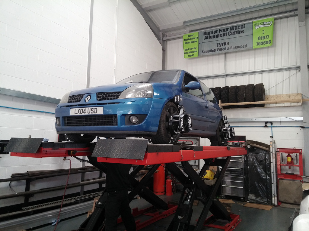

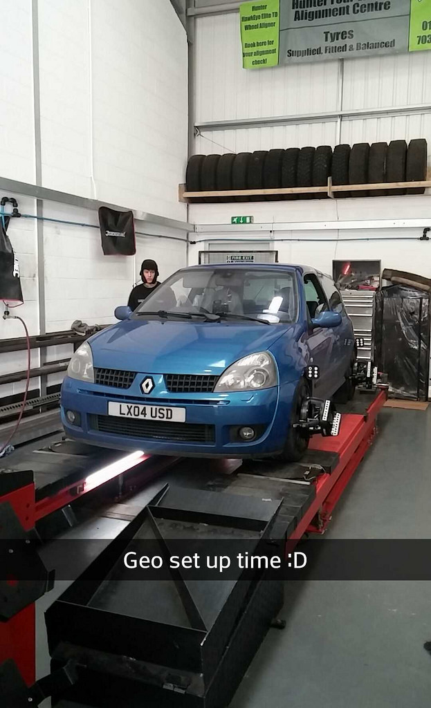

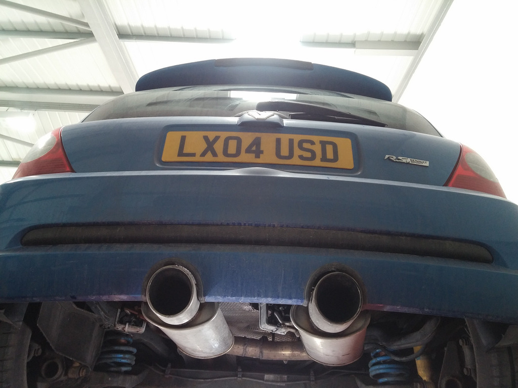

Anyway a few pics of the weekend. I got my car tracking and corner weighting done as above so got a few from there. Car is filthy but nice and used haha

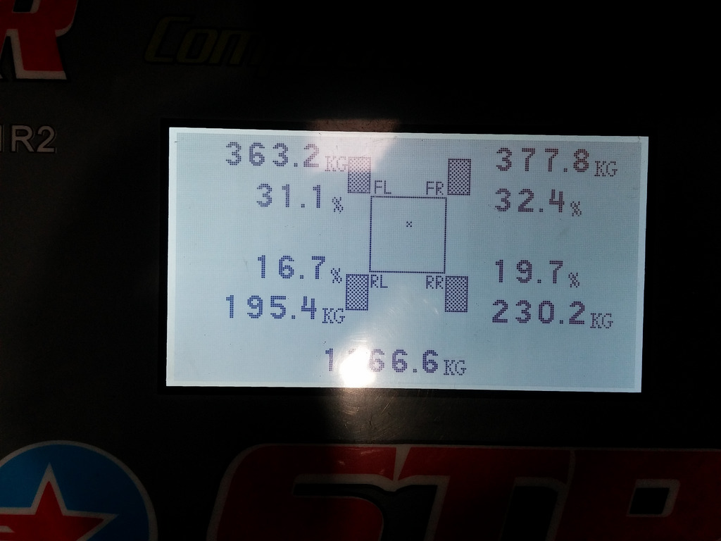

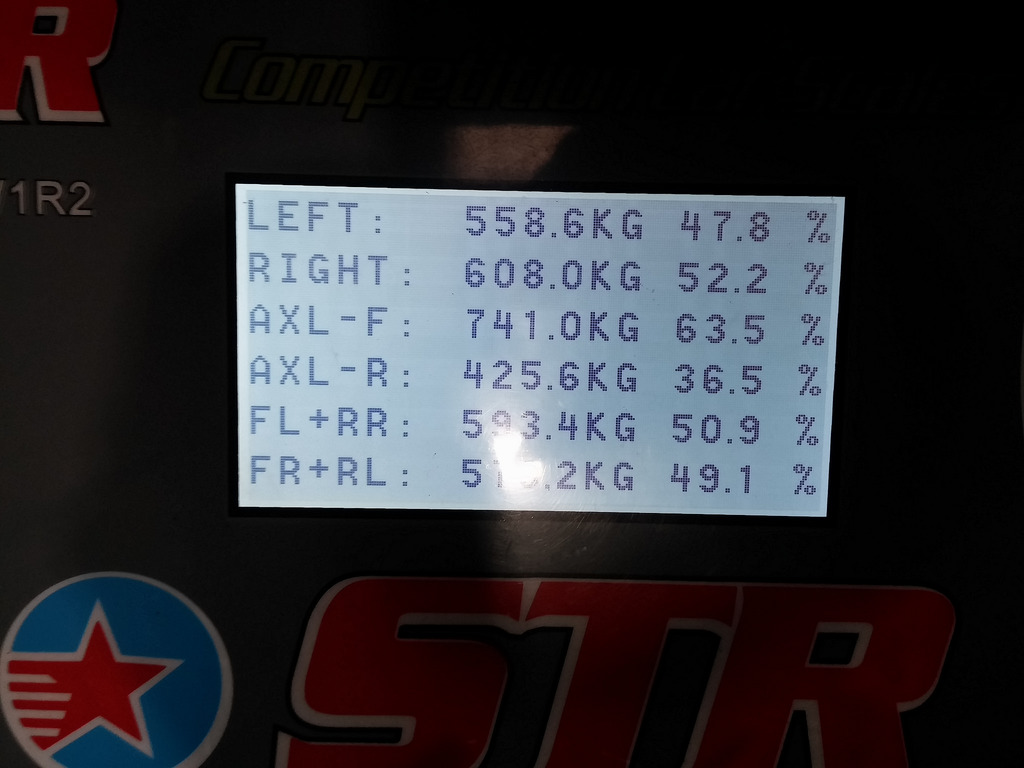

These were the final values for the corner weighting, it was the first time they'd done it and we were kind of left to our own devices so not sure if it's set up perfectly?! Totally new to this.

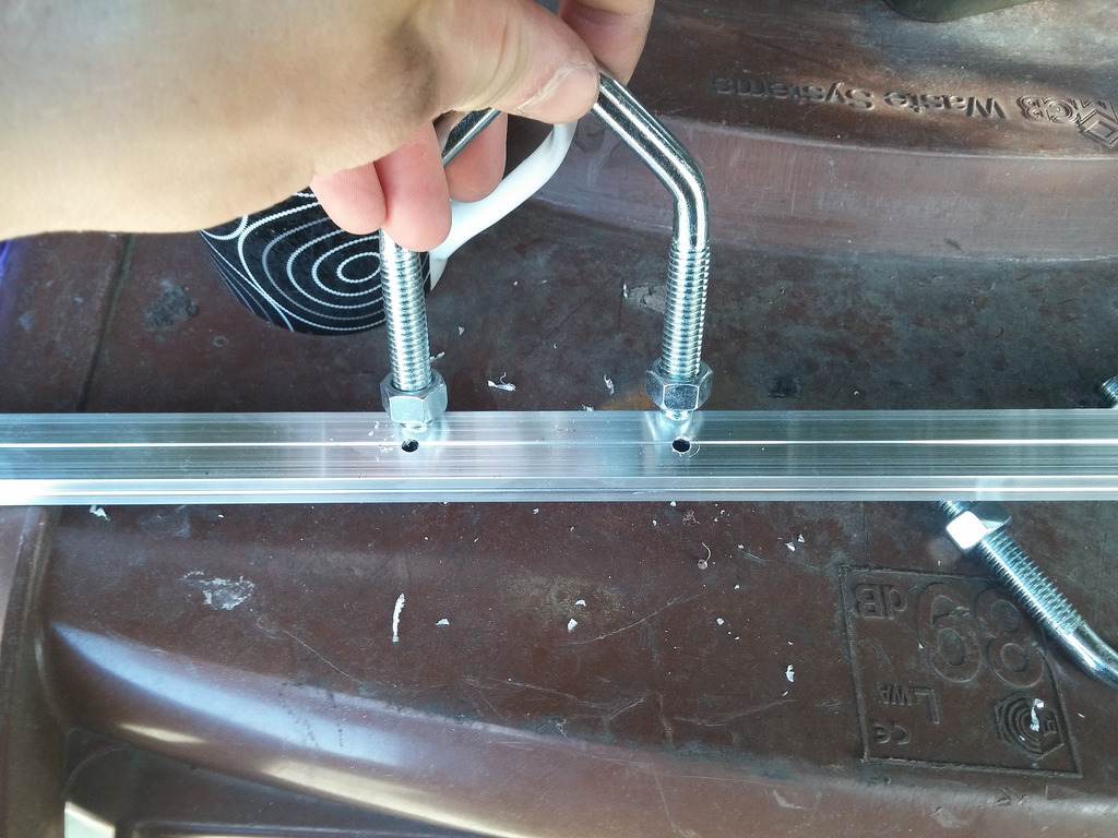

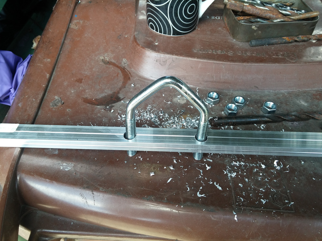

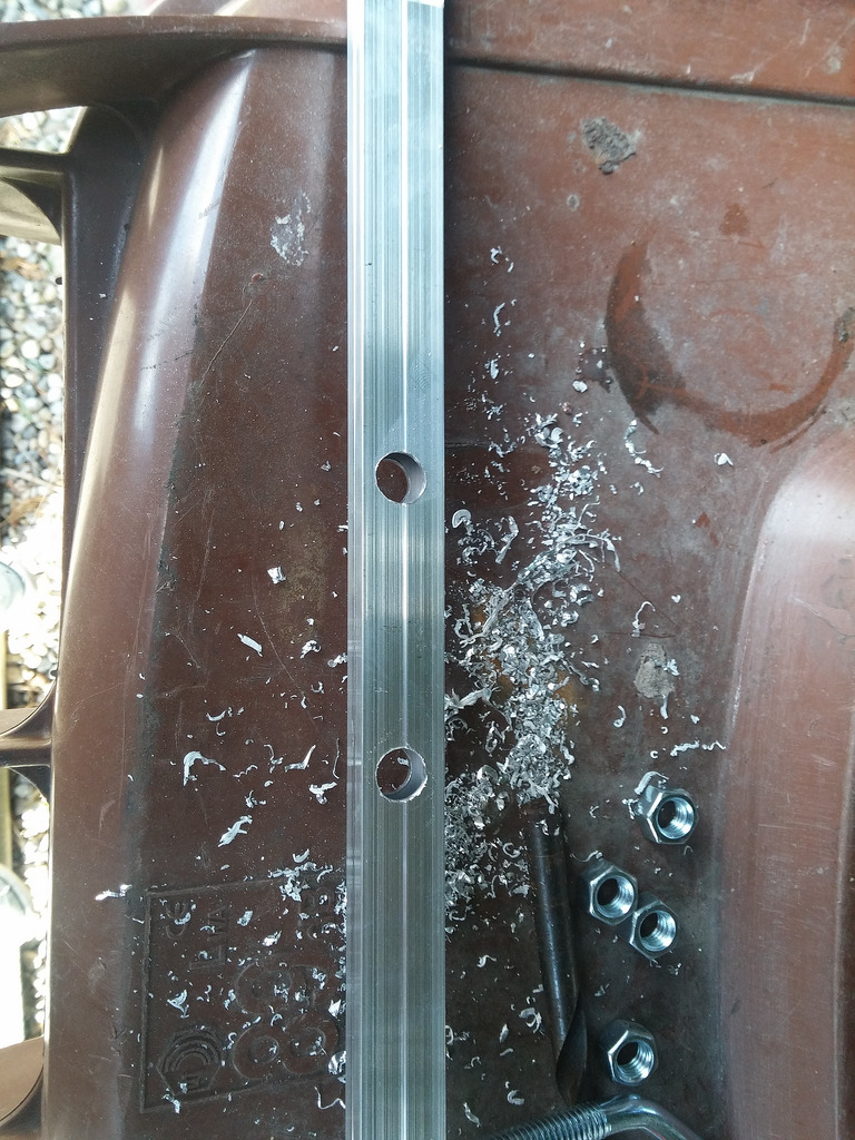

I then cracked on making the mount for the track day that i've got coming up
Initially drilled some holes
20150223_141239 by dann2707, on Flickr
For this u bracket
20150223_141252 by dann2707, on Flickr
Then made them bigger
20150223_141957 by dann2707, on Flickr
20150223_142003 by dann2707, on Flickr

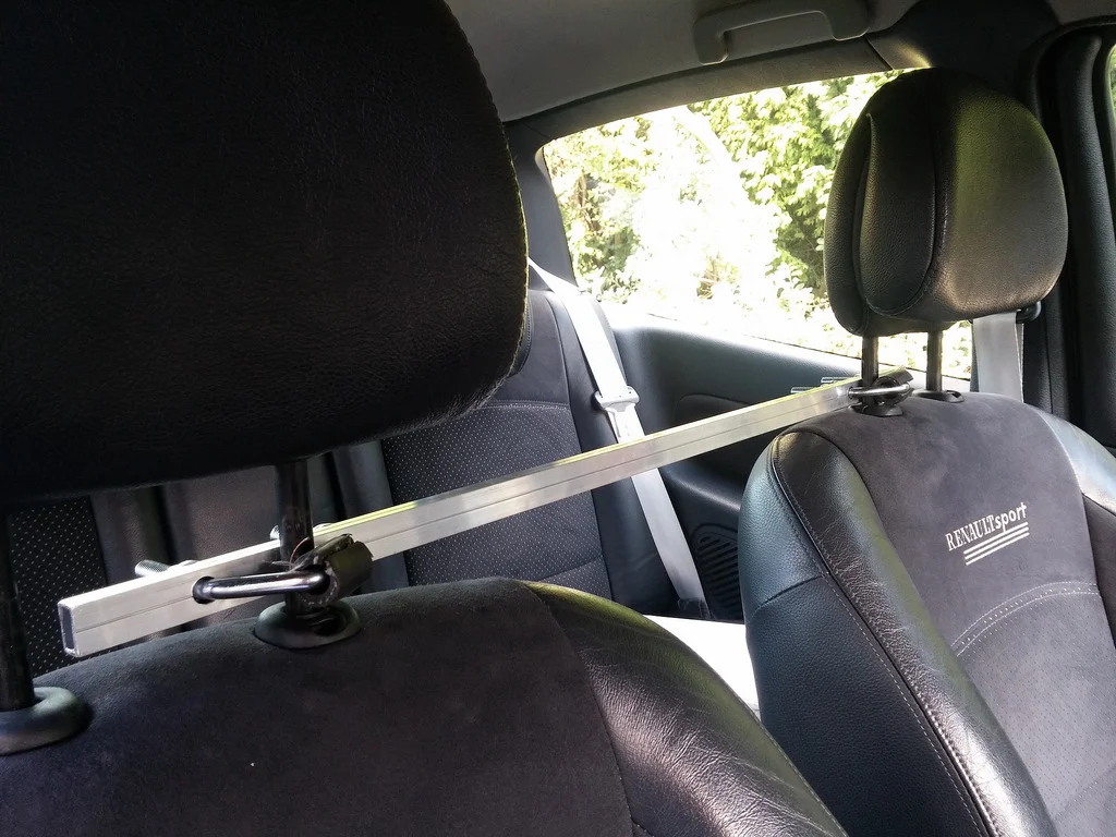

Then voila! Some how managed to get the distances wrong a little bit so it's not bang on central where the U bracket clamps for the headrest pole but it's fine it's absolutely solid. really pleased with it to say how easy and cheap it all cost.
20150223_144847 by dann2707, on Flickr
20150223_144929 by dann2707, on Flickr
Then the super grip is in place :)
20150223_145027 by dann2707, on Flickr
20150223_145100 by dann2707, on Flickr
20150223_145506 by dann2707, on Flickr
20150223_145518 by dann2707, on Flickr
Can't wait to properly test it out :)

1166kg the total weight? Can't quite see with the light reflection.
How much did he charge you for that mate?
Was that the final corner wrights at the bottom? How much fuel did you have in? Still quite substantially out is that. I hope to get mine a lot closer. I know the fronts are more important than the rears but 35kg difference in the rears and 15kg up front is a lot still.
Did you have a before and after weights???

Yeah was going to say that back end is a fair difference side to side... Think mine was 2kg diff with me sat in there. Did you have your beer keg in the boot on one side?? [emoji2]

The bottom two readings from the first pic are the cross weights and you want that as close to 50% as you can, which it is.
