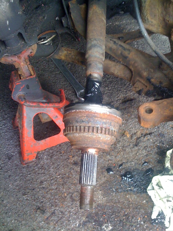

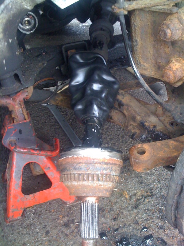

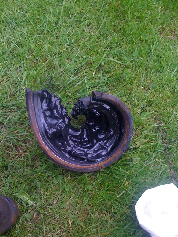

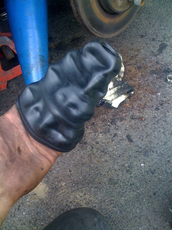

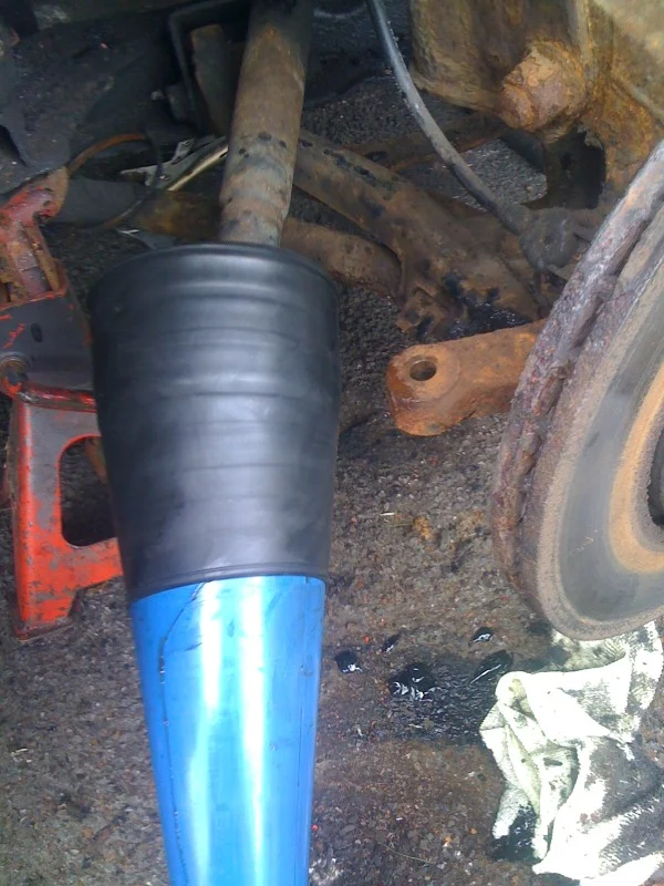

as Dan says, if its knocking replace the CV joint. The Boot replacement is easy i have just done one on mine yesterday for its MOT. here are a few photo of the replacement.
remove bottom ball joint, and caliper ( to save breaking the line ) make sure you remove the 30mm Hub nut before you jack the car up.

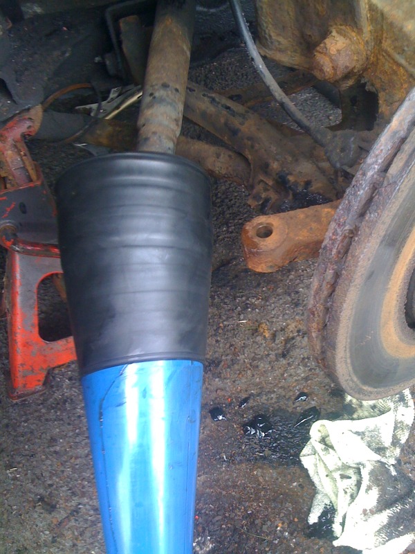

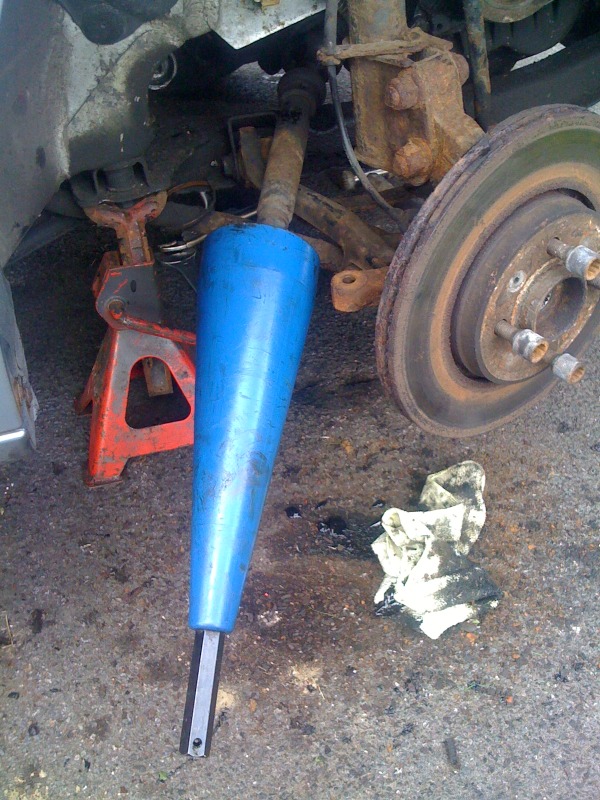

I used a stretchy boot, if you use one you always turn it inside out. plenty of lube on the cone. but not on the part your pulling :)
you will need, 18mm Socket and ratchet 30mm Hub Nut and a cone, WD40 and a new boot with grease oh and its messy!!! :)
