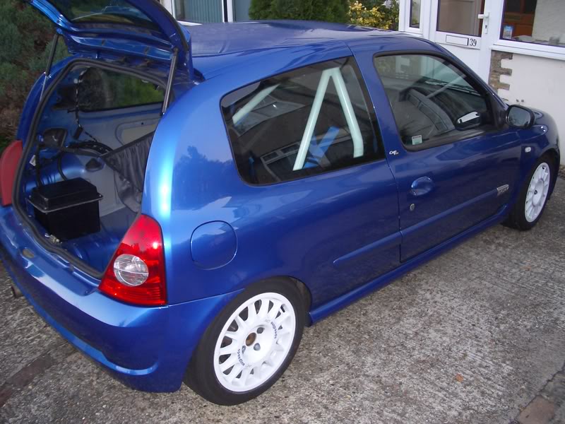

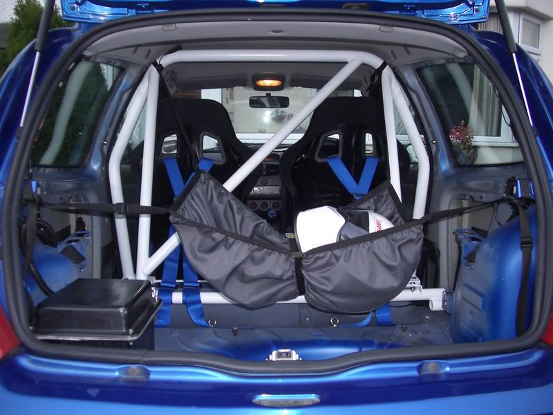

Bought a half cage from Matt and Steve (cheers guys) and decided that I wanted to go against the norm and spary it before fitting. As far as Steve was aware only Ang has her cage painted - pink I believe!
Picked the cage up end of September and after a week or so when the weather started to clear up, I decided to set about prepping the cage, sanded it down, primered it, sanded again and then sprayed it with about 4 coats of hammerite smooth white, pretty pleased with the finish, obviously theres a few imperfections, but nothing that would be picked up until someone got in the car and started looking for them!

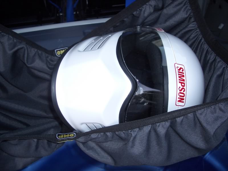

Oh there was no excuse for me putting my Simpson in the pics btw, just thought it looked pretty good in the hammock!!!! :p

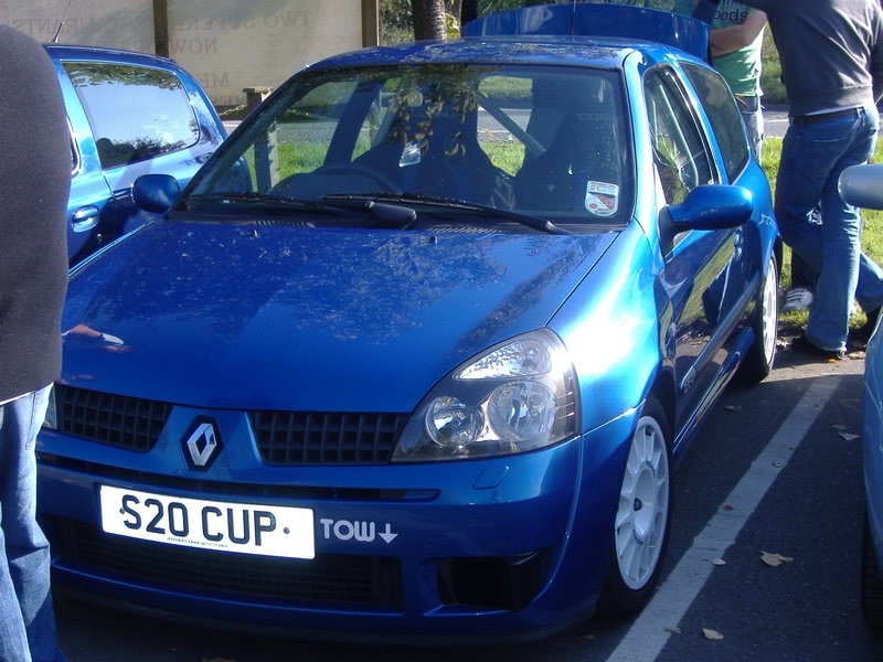

Also here's a quick pic of the front of the car (courtesy of Deb I think at the last Westerham meet! Ta very much :) )

Looking good!
Don't lie. You actually wear it when you go down the shops don't you? :rasp:

That looks just fab in white, good choice much nicer than orange.
Cheers Matt, glad you helped persuade me white would be the better thing to do, tbh I'm glad I didn't go down the orange route now, more than chuffed with this!

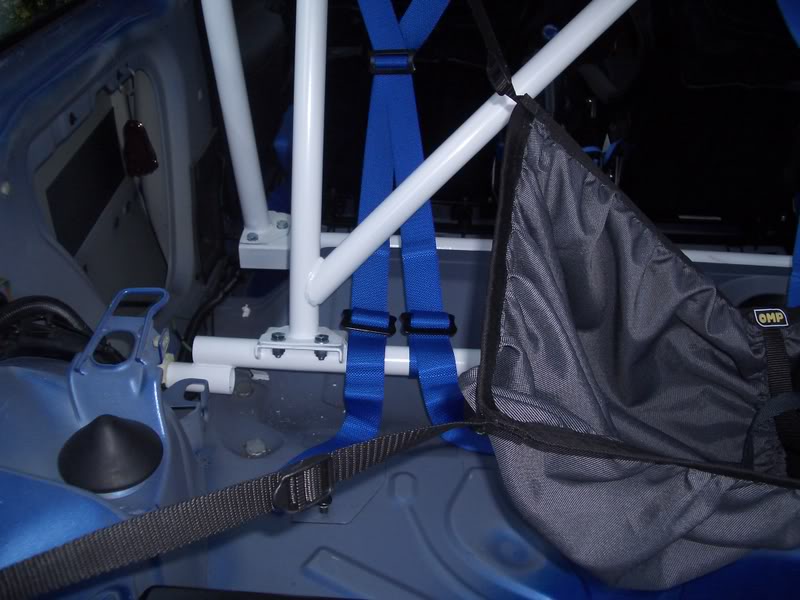

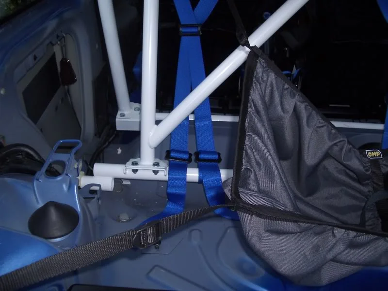

spinal injuries if you have an accident with the way you've mounted the rear harness points. 0-30 degrees from level of shoulder. other than that, looking really good!
