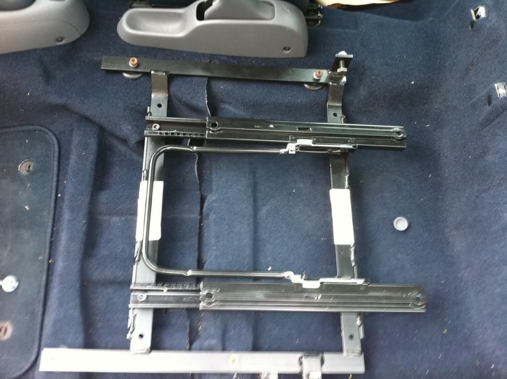

Yesterday I started on the stripping of my Ph1 and fitting of buckets. I have Cobra Imola Pros, Cobra Side Mounts and Cobra X-Low Subframes with sliding mechanism (supplied by Demon Tweeks).
First thing I noticed is that, although the subframes bolt into the floor fine, the sliding runners are too narrow to bolt the sidemounts and seats too. The subframes do also have holes for what looks like a fixed mounting position and that's fine, but I wanted to use the sliders.
Has anyone else had this problem?

Pics of subframe? Cobra have been known to c**k things up mate, they sent me the narrow runners and said i needed adaption bars, they ended up sending me the correct runners and a whole new set of subframes :) Tell tweeks that you have the wrong frame and they might get cobra to send direct to you.

As you can hopefully see from the above image, subframe fits fine, but the runners are very narrow. The fixed holes just to the outside of the runners are ok for the sidemounts though I beleive, but kind of defeats the point of having runners!

They are really narrow, look like they are made for seats which mount from underneath rather than with sidemounts.

By the looks of things, they are either the sliders for base mounts seats, or you need an adapter so that they can be used with side mounted seats like yours. Or, and hopefully, they have sent you the incorrect sliders...

Thanks Dave, will ring Tweeks tomorrow when they are open. It's almost like the slider runners need to be moved to the outer holes, but then then pull handle is too narrow. I'm sure they will sort me out, just annoying as I wanted the seats in this weekend.

Subframe will take both runners, they just pre-drill for both types. Pic below of the incorrect ones Cobra sent me, same as you... they will never learn!

I can't praise Demon Tweeks highly enough for their customer service. Multiple emails and calls today updating me on their talks with Cobra. The end result, I had the option of them sending out completely new subframes, or a quicker option of them sending out the wider handles today for delivery tomorrow. I went for the latter option as it looks like a simple job to just bolt the runners onto the wider mounts. Result.
