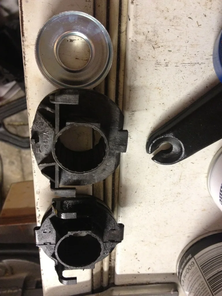

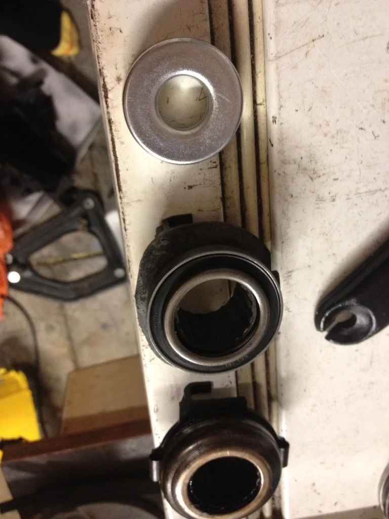

Got the old release bearing off it looked like this one on the bottom.. Not marked valeo
My new valeo kit has one like this one on top.. Slightly different design!
Clutch and pressure plate looked the same and are fitted no worries at all
I've been told the silver bit next to it isn't important and to chuck it..
Also I seem to have lost the grease in the kit for the inside of the bearing and input shaft.. What is best to use? Copper grease okay?

If it fits on the fork and is the same thickness then its fine. The other part is for alignment, not needed and makes fitting harder imo.

yeah its the same thickness and everything just looks a different design! yeah figured as much.. binned.. aligned by eye anyway
