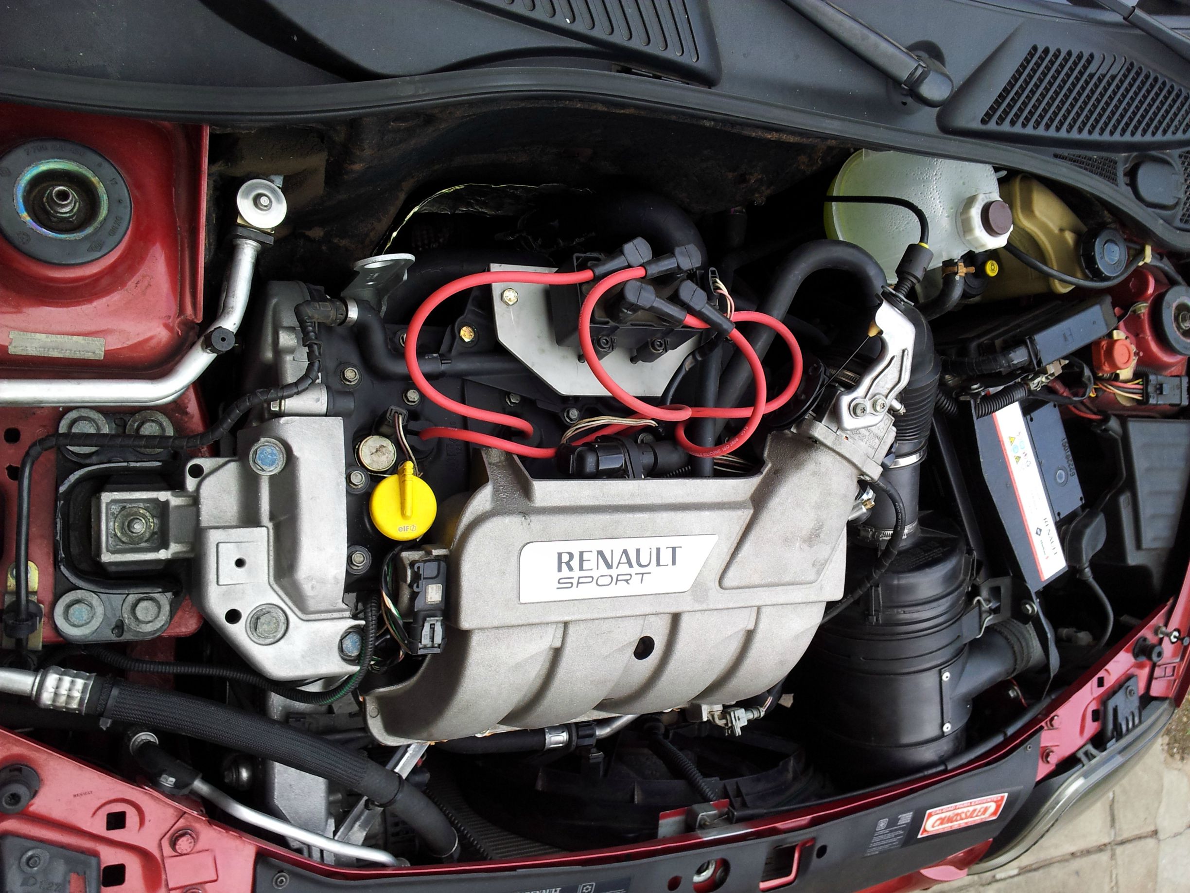

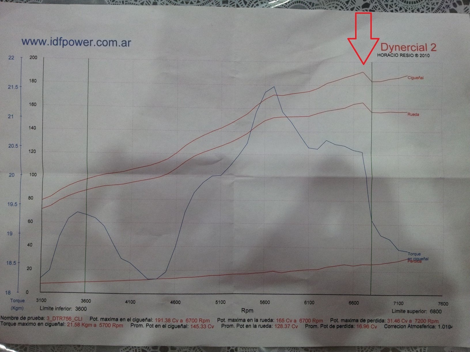

Mount on my Clio Sport catcams 428, cylinder head was duct work (springs, valves, tappets and rocker OEM) 4-2-1 exhaust manifold, inlet manifold Clio 197 Clio 197 injectors. In the dynotest is good until 6800 rpm giving about 191 hp but abruptly drop one 10 hp! In all tests is always about 6800 rpm. The strange thing is that no strange noises or obvious flaws. I leave a picture to see the power curve.

Could be the VVT solenoid switching off. I think mine did similar before it was mapped. Have you had it mapped?
Yes! It has been mapped, but how do you control the switching off of the solenoid by the map? Is this possible?

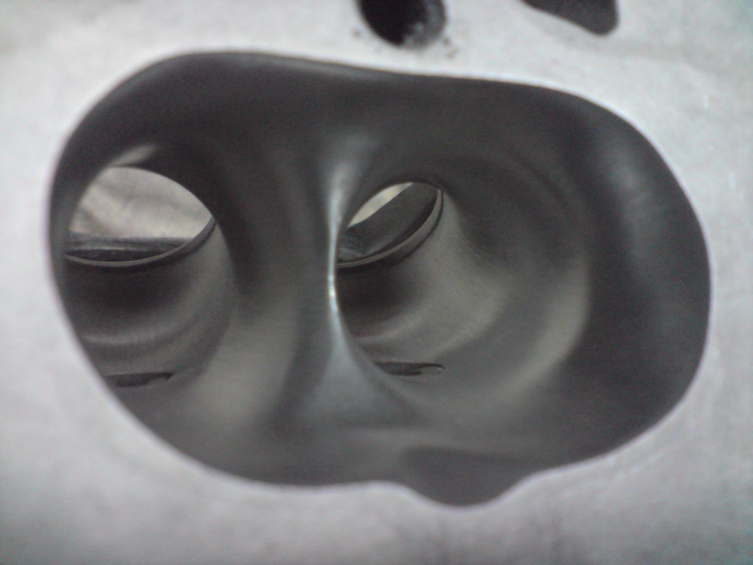

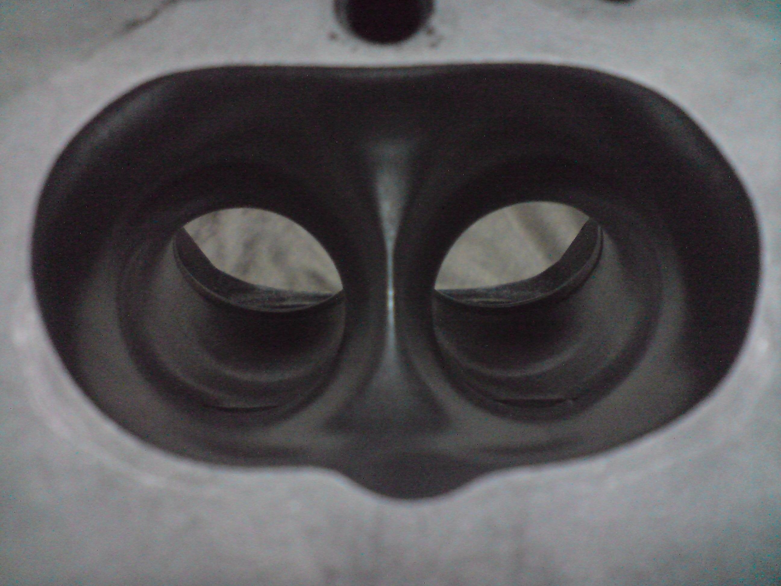

Got any pics of the portwork between the inlet and he head, as they are quite different IIRC
That drop looks exactly like the dehpaser switching off to me.
  Renault Clio Sport Fase I
This is the work I did on the head. I had to enlarge the head to fit the manifold and make the hole for the injector...........

Even I can not take full potential by falling power you see on the graph. I begin to doubt that it can extend the action of vvt...
It will be possible to modify the parameters from the ECU!?

Yes mate you can alter the point at which the ECU turns the solenoid off again when you remap it.

speak to Paul at RS tuning, he can map it remotely as can Henk at Fastchip, if its 6800rpm its the VVT switching off

I thought he said it'd been mapped though? If custom mapped in this configuration it should be fine. He would just need to keep the vvt on past 6800 and then have that part of the map adjusted to suit.

It was only the dephasor not turning off that they missed in the map by the sounds of it, they obivously did the fuelling.
That's ....!
It only remains to adjust vvt RPM.
At first the mechanic, thought that the vvt was driven mechanically, but to confirm that you can adjust from the map now is work on that and find a way to do it from the map. Still do not know how.....
