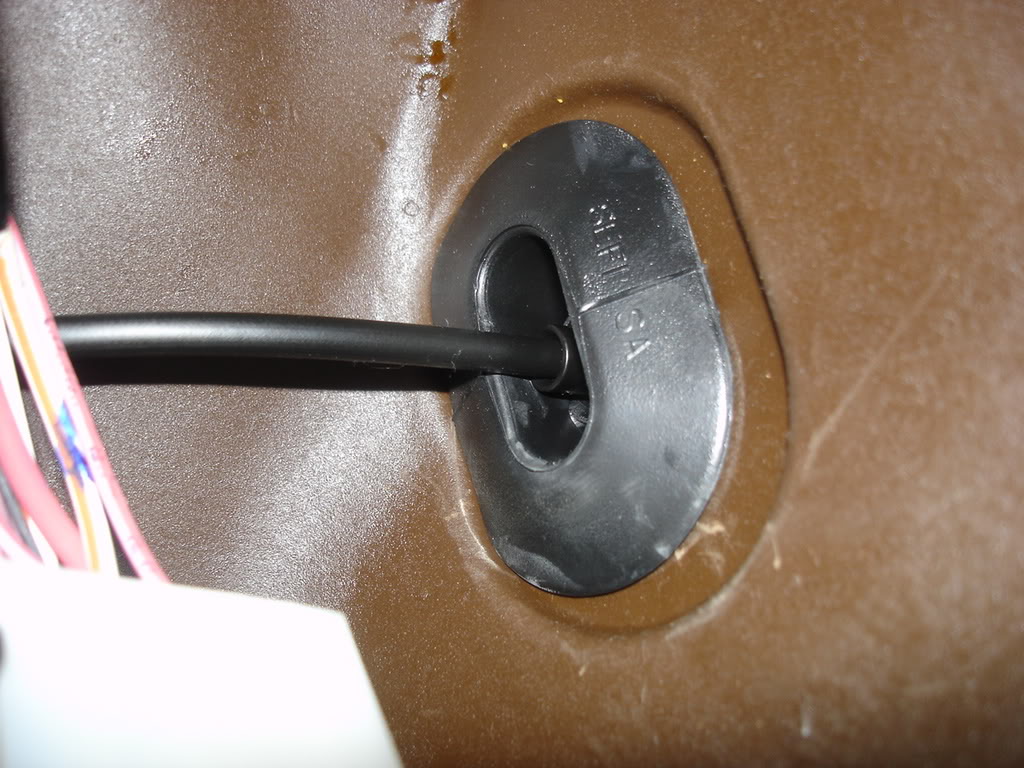

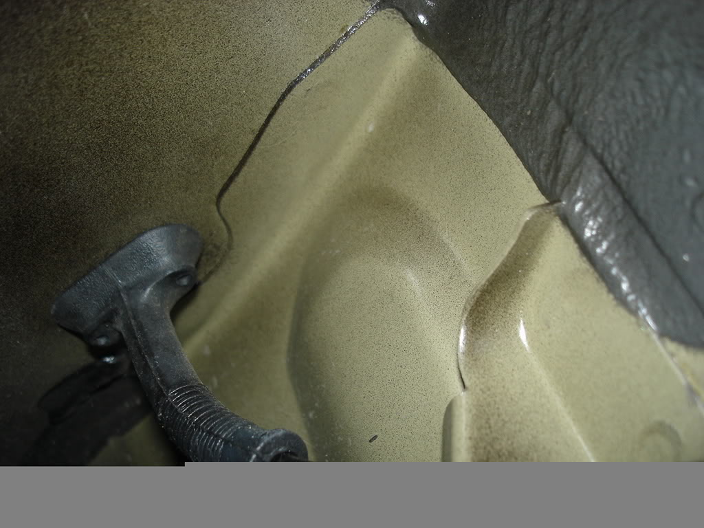

what gauge power wire are you using? i used 8 gauge (i think). u need to look in the passenger footwell for the gromet for the bonnet release cable. feed a long thin screwdriver (or whatever) through under the grommet and tape ur wire to the other side once through the firewall. then just pull it through. its a bit tough and theres a few people on here who done it and struggled with it too. i took some pic of the grommet in my '55 dynamique inside the footwell and engine bay!
footwell boot release grommet:
engine bay (other side/exit of grommet)
if you need anymore help or pics then just pm me
