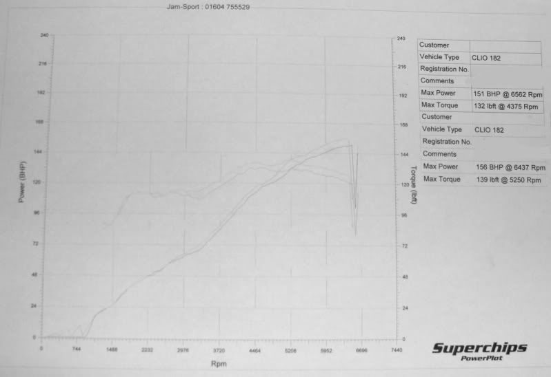

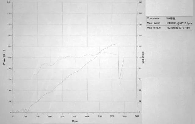

Also below is my dyno run. Is 150 at the wheels a good result with:
1. K&N panel filter
2. Matched manifold
3. Superchips remap
  PH1 172 Sport

182 is PS not HP for starters and that's measured at the flywheel, you have to take tranny loss into account to get the power at the wheels
  Clio 182
what do u mean... how can it drop down 32bhp because its on rollers??
Estimated BHP at flywheel was 187BHP (190ps approx) but I did not put that up as what matters is the "at the wheels figure".
Before the mapping (but still with the filter and manifold I got 145 at the wheels, approx 180BHP (183ps) at the flywheel).
Did not get a reading without the K&N filter and matched manifold but I would expect it to be around 140 at the wheels (173BHP, or 176ps).

145 BHP ATW calculated as 180 BHP at the fly (approx 19% losses)
The 183 was just the conversion to PS which only serves as a comparison to the name Clio 182

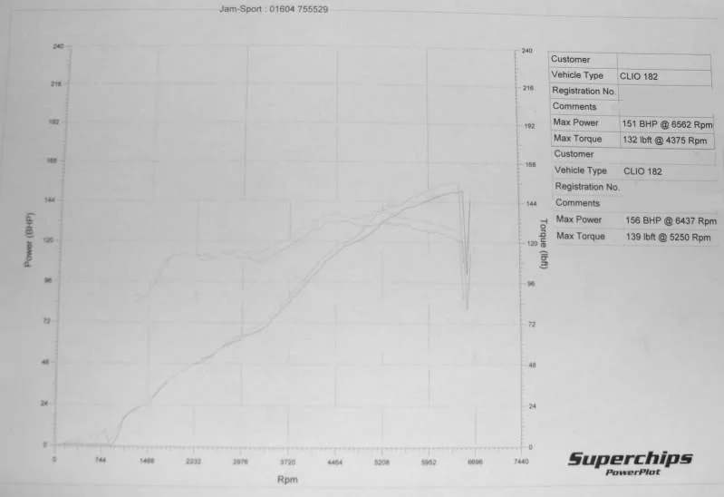

Also below is the dyno run using a new map Jamsport developed for their matched manifolds. Power is up to 156WHP now :approve:
