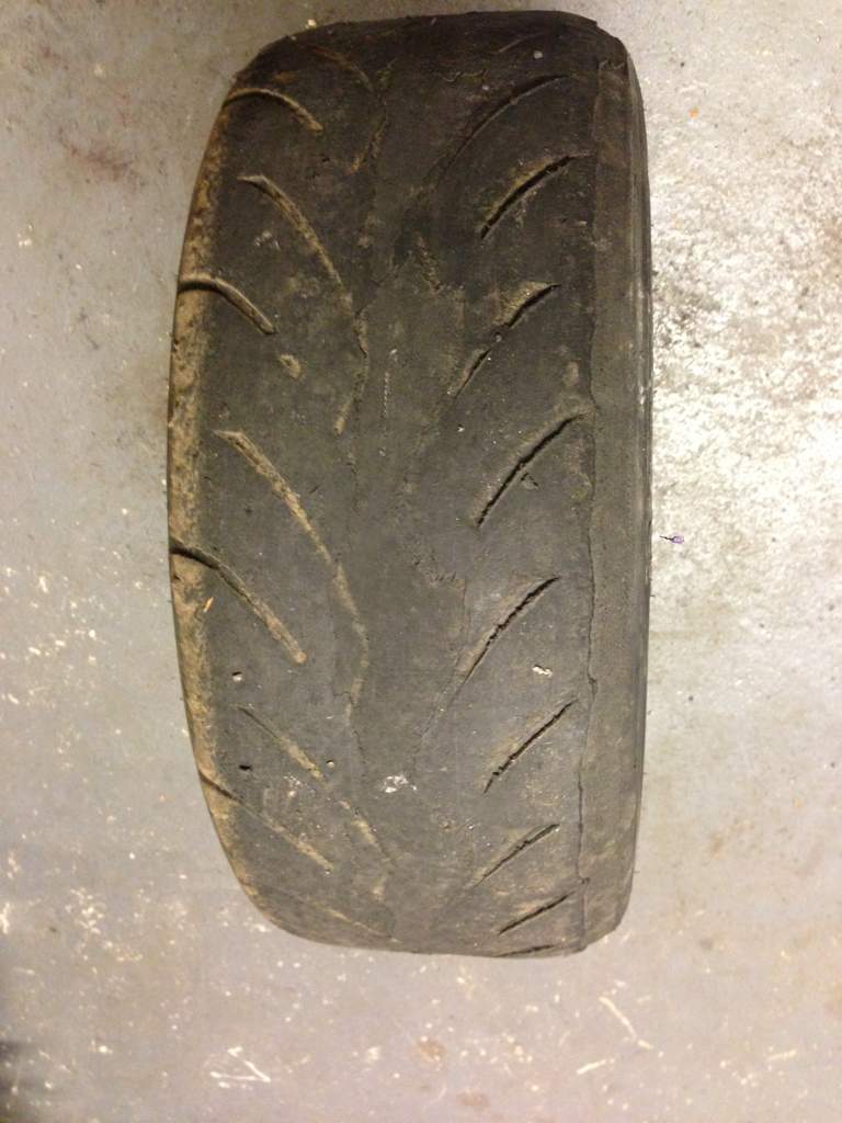

Excessive wear down the centre suggests the pressures were still too high?
What kind of psi do you run at?
  Clio RS 172 /Trafic
I never swap tyres around. No need at trackday. Just make sure they're I'm good condition before you go and don't over-inflate them. 2.0 bar max.
i would be running them lower than 30psi they have stiff sidewalls so should be no problem and they have been well over inflated looking at the way they have worn .....

30 psi is way too high, i would think about 20psi to be about right.
when i had my gtir used to run at 18 psi and that car is alot hevier.

I'd be starting off at about 20psi and seeing how warm they get. Wouldn't want to run higher than 28-30 when at full operating temps.

I was told by yokohama the optimum pressure for an 048 was 21psi hot for a base setting ... then look at tyre temps

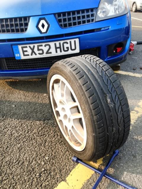

That does look like it been slightly over inflated as the centre is worn.
That looks like a Direzza to me, our man from Dunlop told me 28-30 hot, as long as there is a 10deg temp range across the surface.
You can swap them around if you like, but you would better to do it at lunch time, when they have been left to cool for a bit.
It is a direzzas, one of the ones I got from you nearly a year ago!
Ill drop my pressures to 28 on Sat and see how I get on. Will try keep to shorter sessions aswell,
Ill keep an eye on wear and aim for swapping at lunch.
