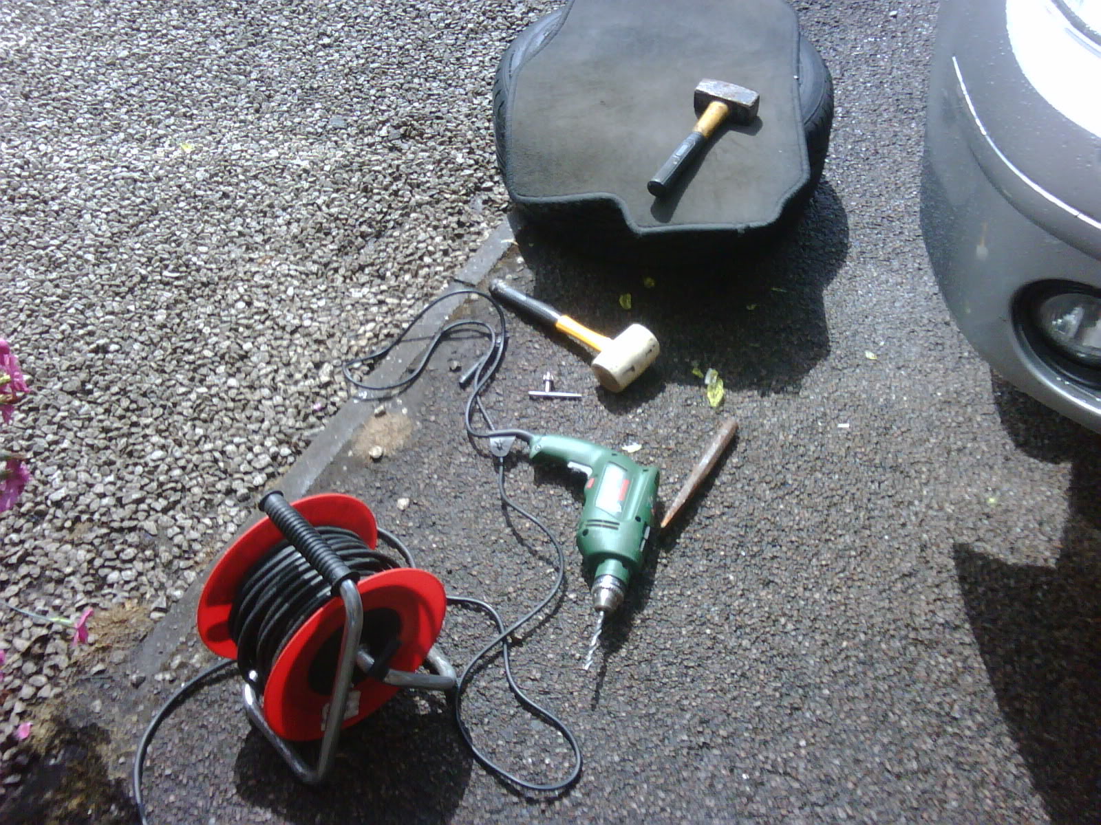

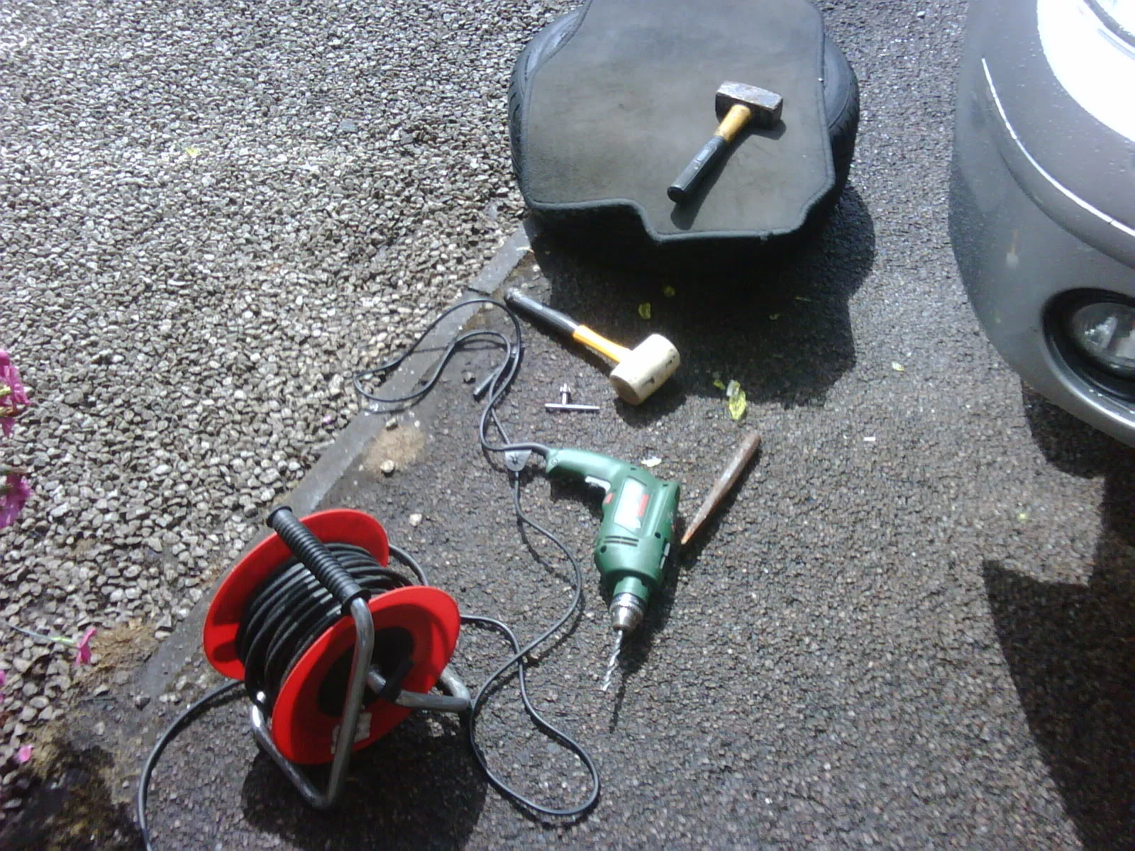

Don't forget the essentials either...
(And no I'm not kidding).
Lol what's the drill for? Is it for when it all goes wrong and you've got something handy laying around to take it out on the nearest person? :rasp:
Seriously though I take it that's for incase you round a bolt off?
  Bus w**ker
Torx grub screws mate. The c**ts weld themselves in and just round off.
Under the car there were tonnes of broken tools from where I'd tried to "help" the screw out but after an hour or so trying I gave up. Grabbed the drill and a 10mm metal bit and went at it lol. Still had to attack them with the cold chisel and 9lb lump hammer afterwards too.
Same on the other side too. :(
