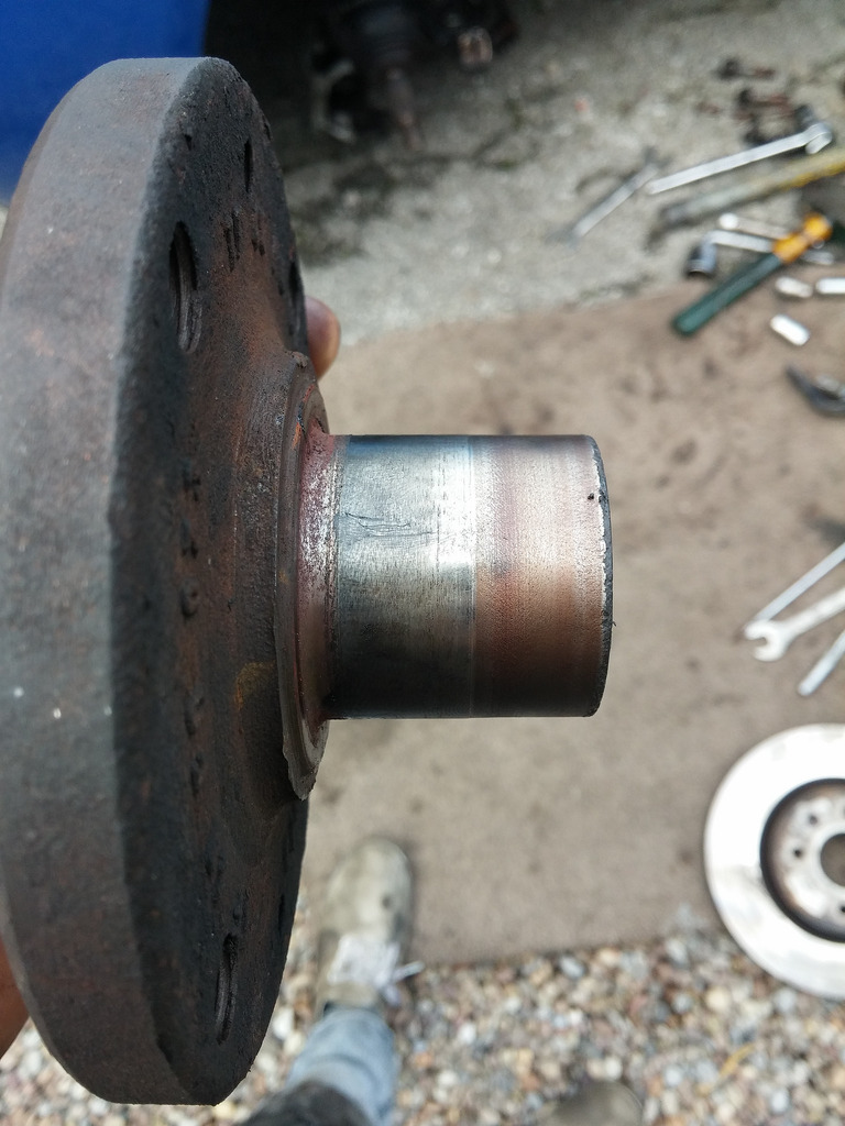

Found the source of my problems! Fingers crossed anyway
But basically I identified that the n/s bearing was totally gone when wobbling the wheel at 12 and 6 oclock positions, clonking loads and just really sloppy compared to the offside.
20141025_112620 by dann2707, on Flickr
There is a lip on the bearing carrier. Picture doesn't really show it but running my finger along that shaft :)D) shows a big lip. I'm not exactly sure how long it's been like that. When I first got the car the bearing was loose so maybe tightening and loosening, tightening again has worn away some of that material.
The new bearing is still sat in my bedroom as I am just using the one that came with the replacement hub that I bought yesterday. I'm not sure whether to just run this one into the ground or replace it anyway seeing as though I have it here anyway.
The replacement bearing is on and i'm fairly certain I didn't hear a single clunk when changing gear but I only had a 1 minute drive to the shops.
