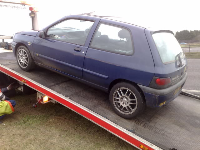

my poor car.
driving down A130 today
doing 60....
and all power went. and engine cut out.
managed to get to side of road.
after fiddling with the usual stuff decided to call the recovery team
the guy looked about for awhile and said that the cambelt is gone :(
i know this is a very expensive job...
but that it is also possible to do at home..
only thing is apparently it might have caused damage to the head.
any one know of prices roughtly??
