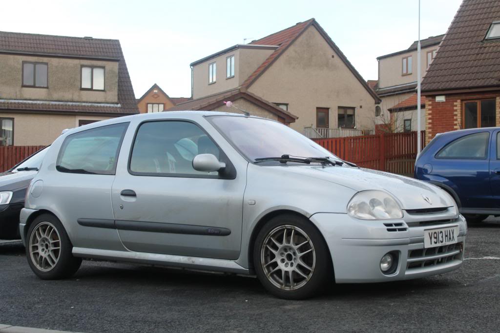

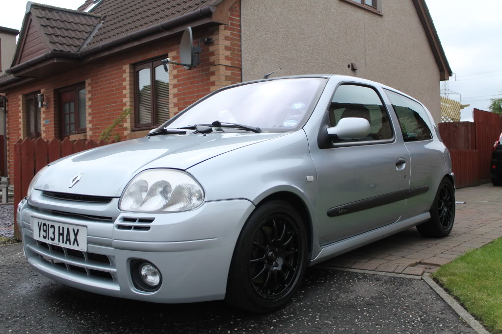

Bought my berg as a birthday present for myself. My mate Stu (cliostu) had the car before me. The car came with ph2 dash / interior conversion, Stealth exhaust, anthracite wheels, also floor carpets and roof lining were changed to black. Since buying the car i havn't really done much to it tbh. Main focus just now is to get it looking a bit better for FCS. This will include some lows and getting the front bumper re-sprayed for going.

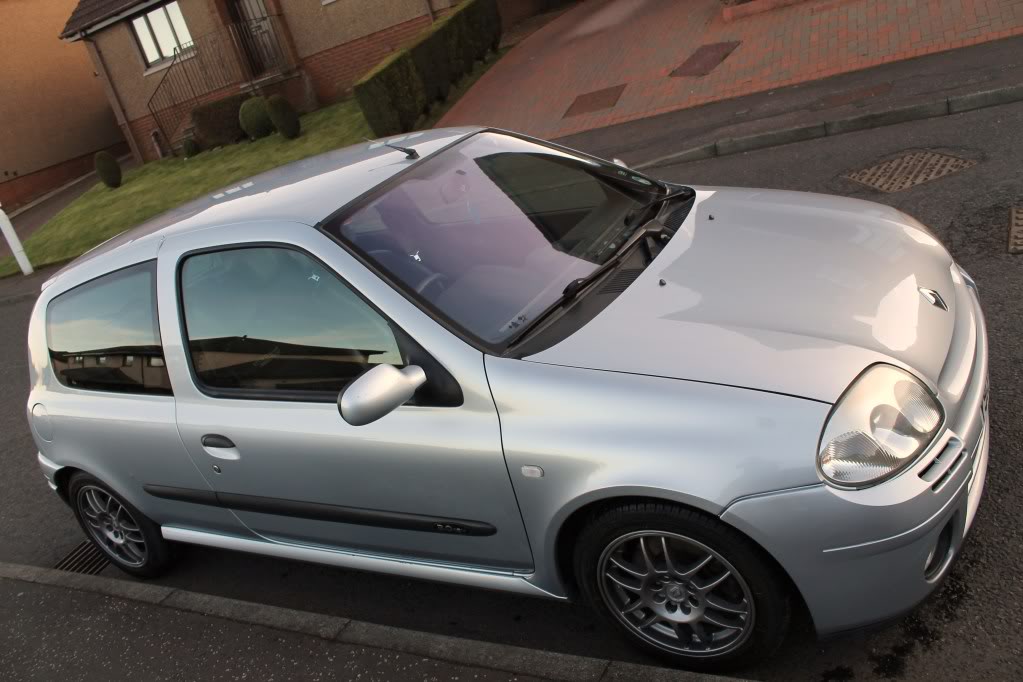

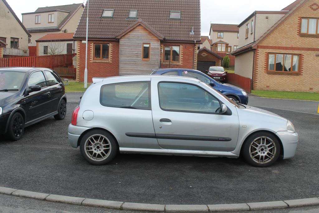

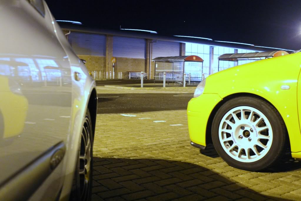

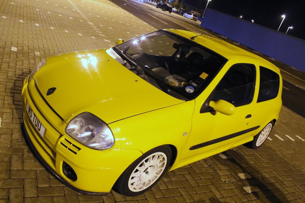

Here are some pics of the car as it stand just now.
Progress will be pretty slow on this as i still have to pay off my insurance :(
Give me a couple of months and i'm sure things will start to happen.
A couple of photos from livi cruise. (pictures are mainly for stu here)

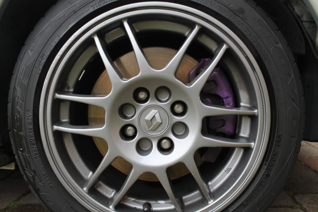

Get it decked and that Ph1 is textbook! Ace. What colour are the wheels mate? It's like a bronzey/anthracite? Don't suppose you have a colour code?!

Danith - its anth, I'll update this when im in tomorrow for you if foz doesnt know.

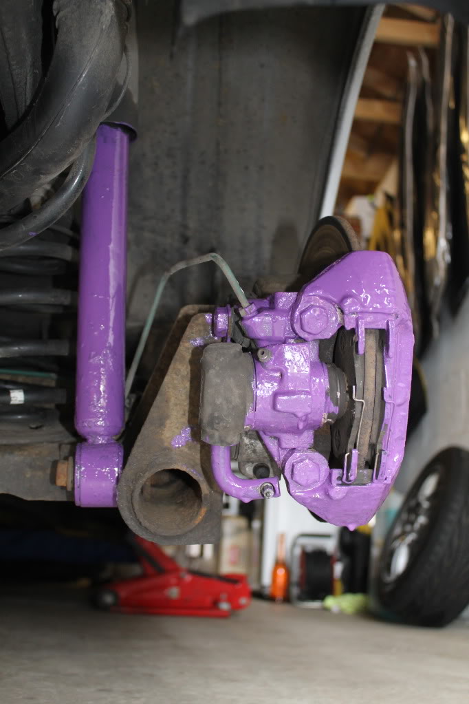

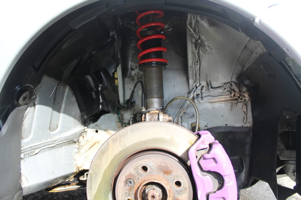

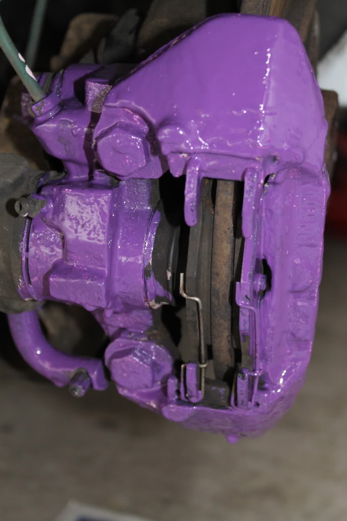

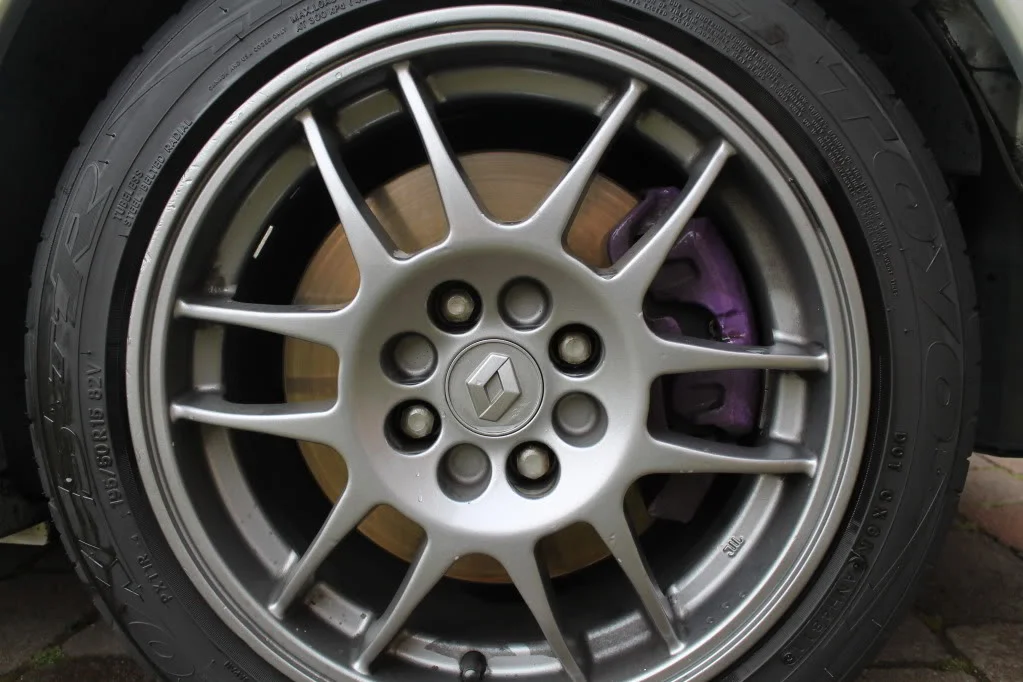

172 Berg, caliper painting fail

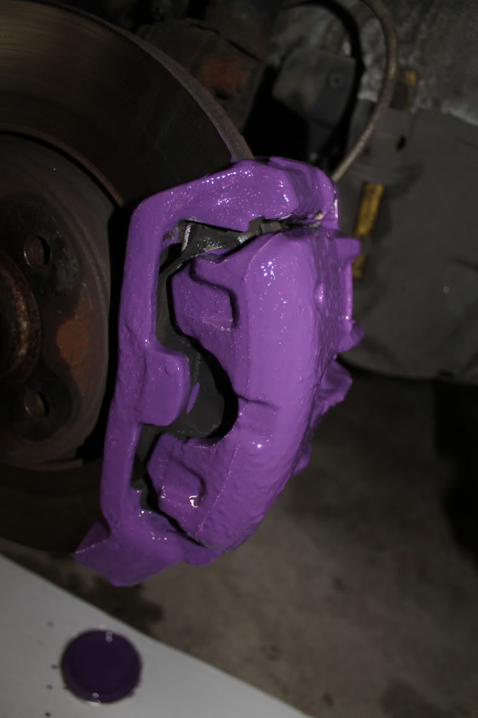

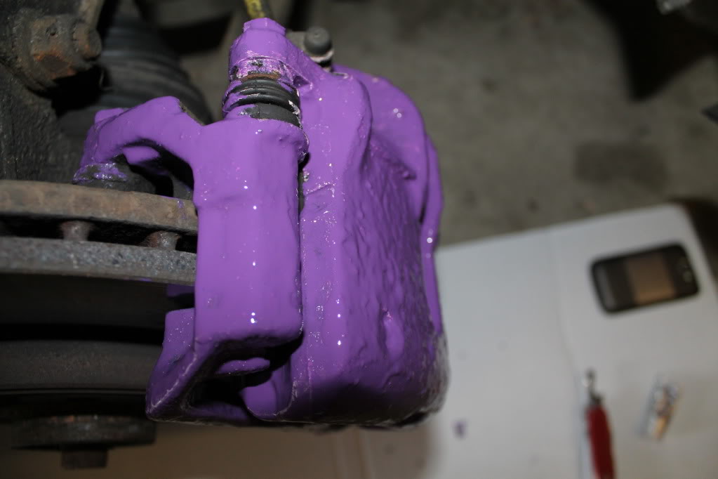

So the calipers when i got the car were pretty tatty. all the pain had flaked off during track use so i decided i'd give them a paint.
I decided i wanted them purple due to not seeing it before. For some reason i didnt think about using ebay and finding purple brake caliper paint. so i bought white hammerite and mixed in about 7 bottle of blue and 7 bottle of red food colouring. I got to s hitey colour but thought i'd use it anyway after wasting all the money.

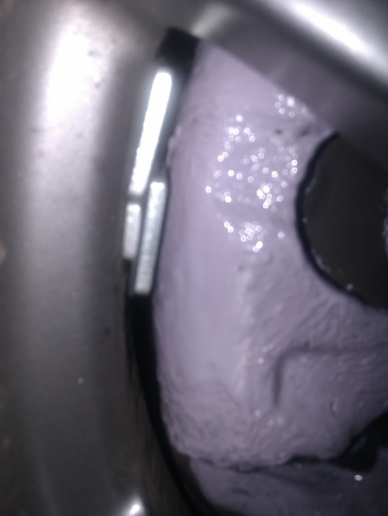

after painting the callipers i switched the front and back wheels round. since the back had just been balanced i obviously didnt think about this haha
Removed the wight and all glued it onto the wheel

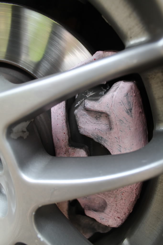

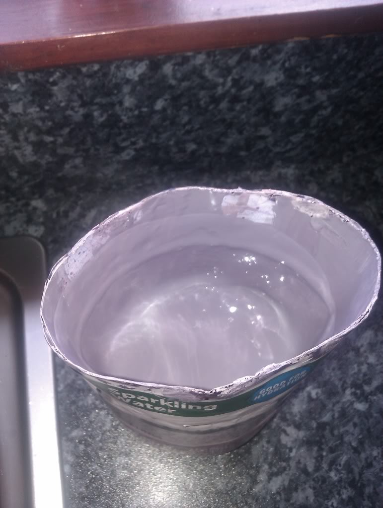

When the shitey hammerite dried pretty much all of the food colouring came out of the paint and was "beading" on top of the paint. After washing the food colouring away they looked worse than before.
SO then i ebayed purple paint. i got the colour i wanted so whacked it on the calipers and decided to paint the rear shocks as well. IMO it looks pretty good. So i'm happy with the results. No before pictures unfortunately
This pic was taken after the food colouring came out of the paint haha
Final paint :D
comments appreciated :D

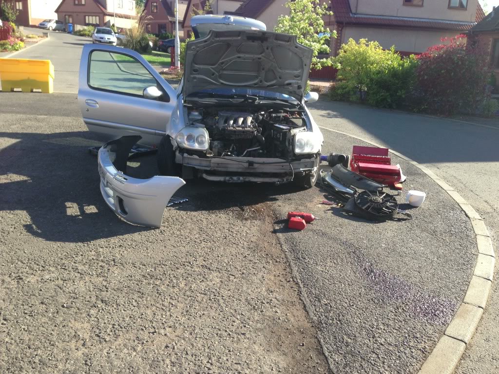

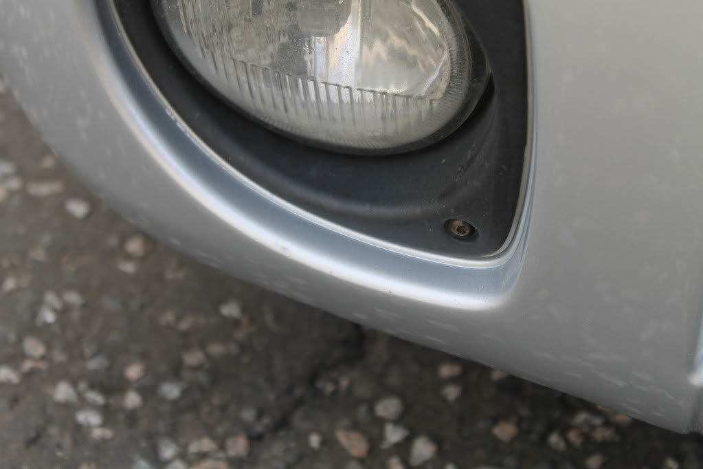

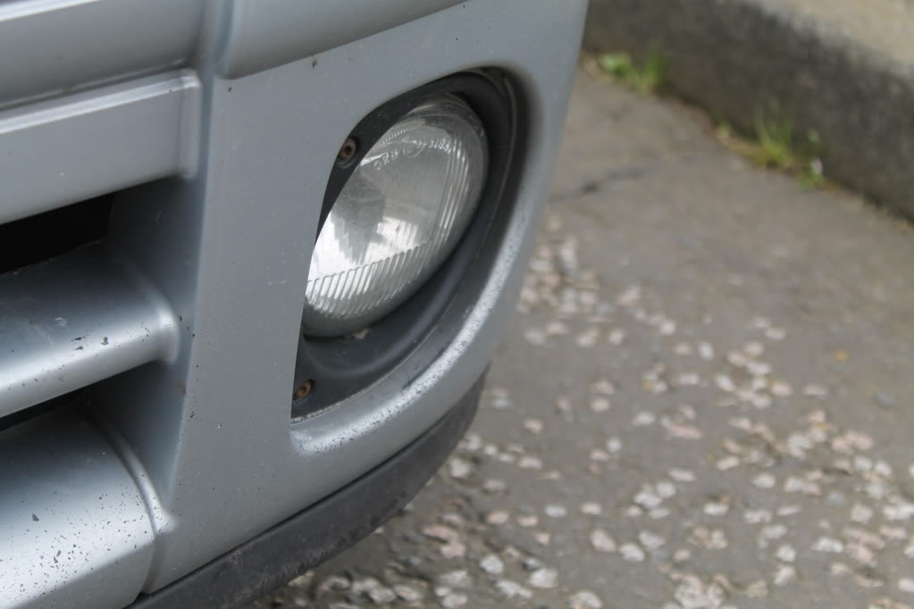

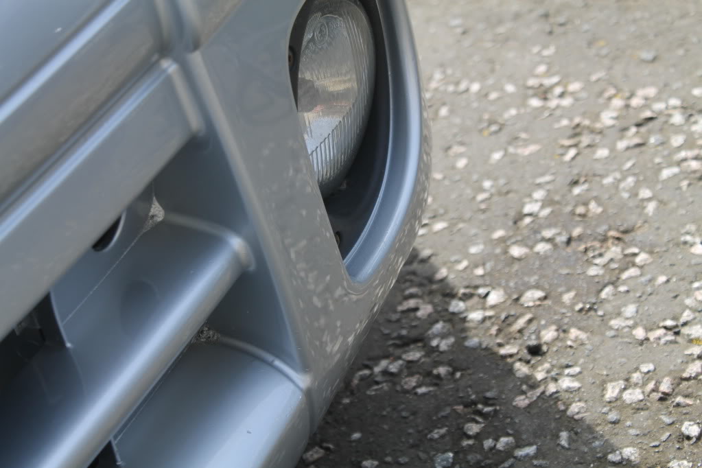

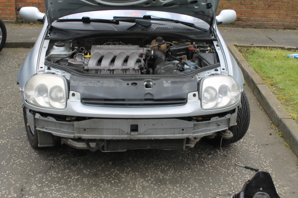

First up was the tatty front bumper. Full of stone chips which didn't look to great.
Out with the old!
and in with the new!
Thanks to Clio_stu for helping fit the bumper.

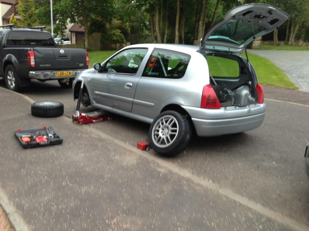

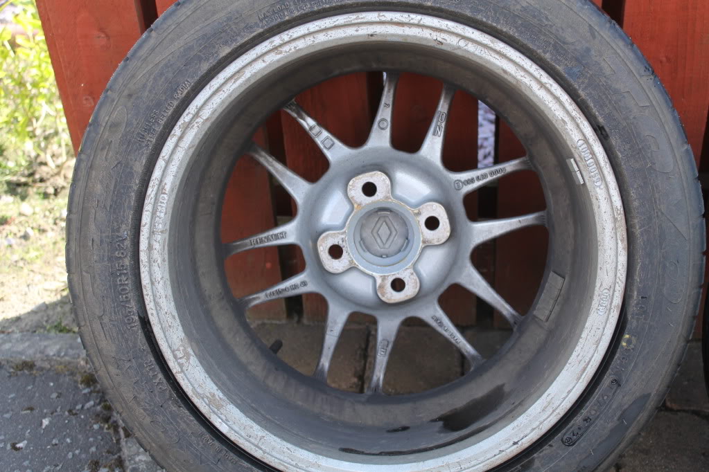

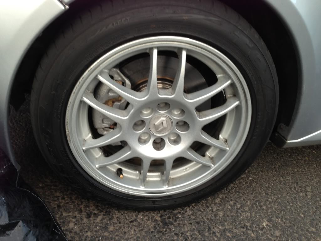

The car was on standard suspension and the wheels were starting to look a bit worse for wear.
Probably one of the better wheels but it makes for a good before picture lol.

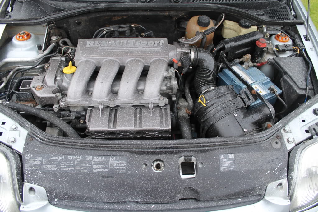

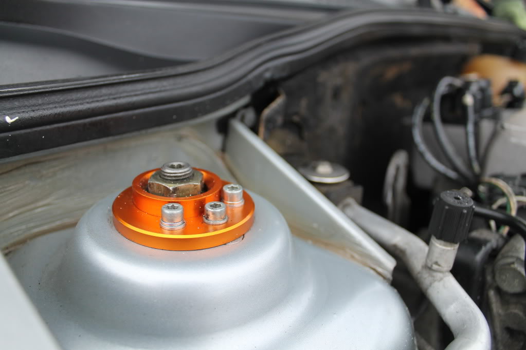

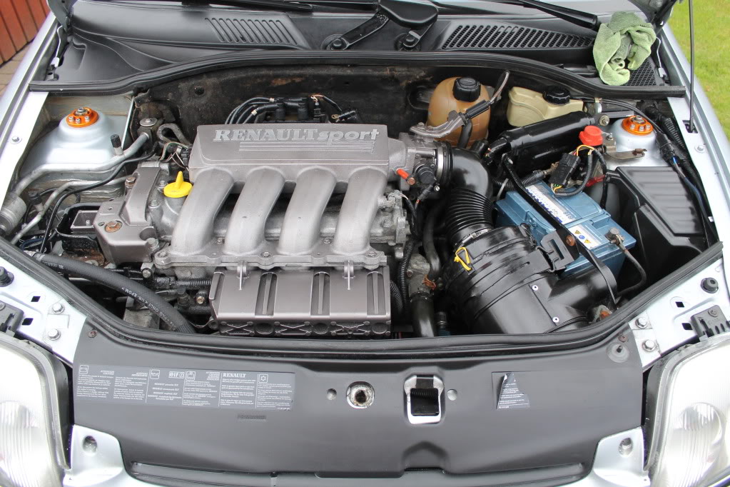

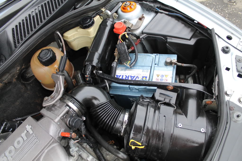

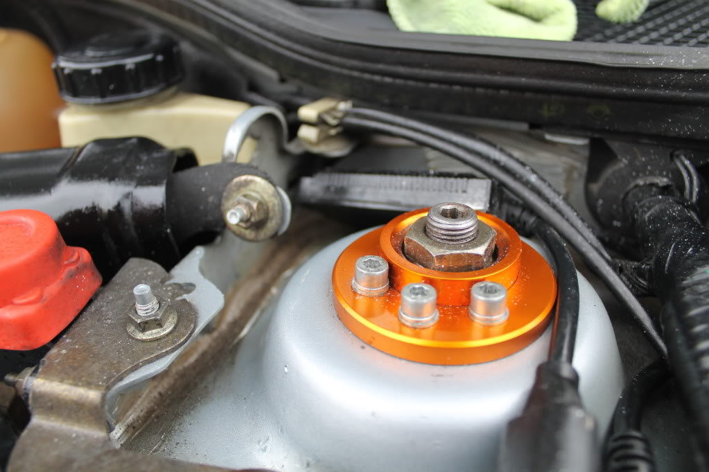

Some under the bonnet goodies :D
Again thanks to clio_stu for helping out with the colies and the top mounts.
Cheers to frazjam for a shot of his track wheels whilst mines are away being refurbed.
After the coilovers were fitted!

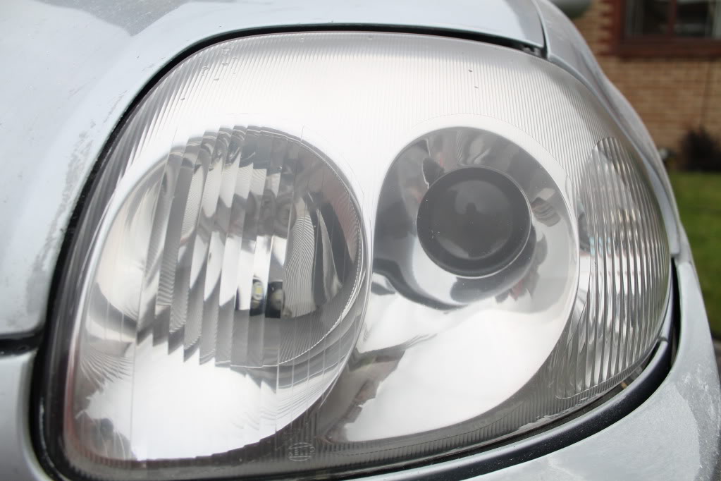

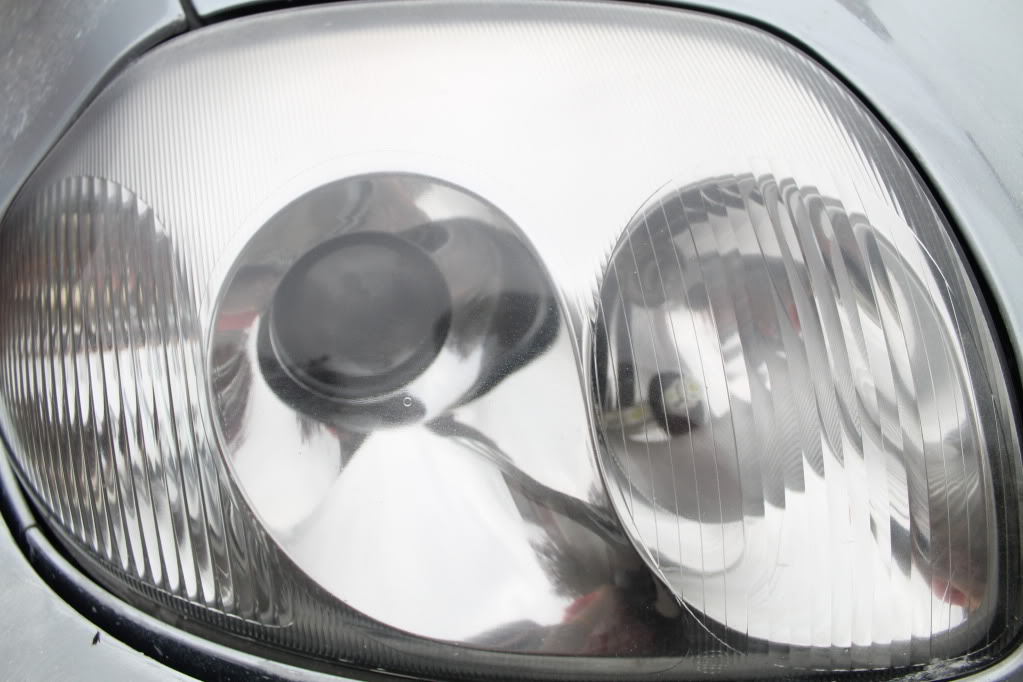

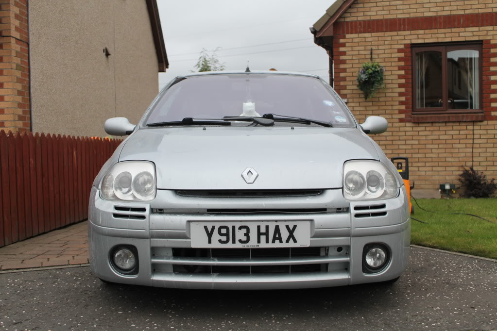

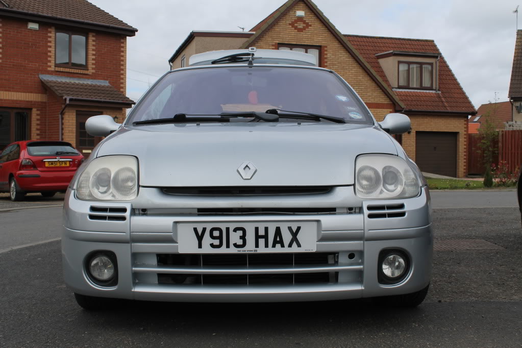

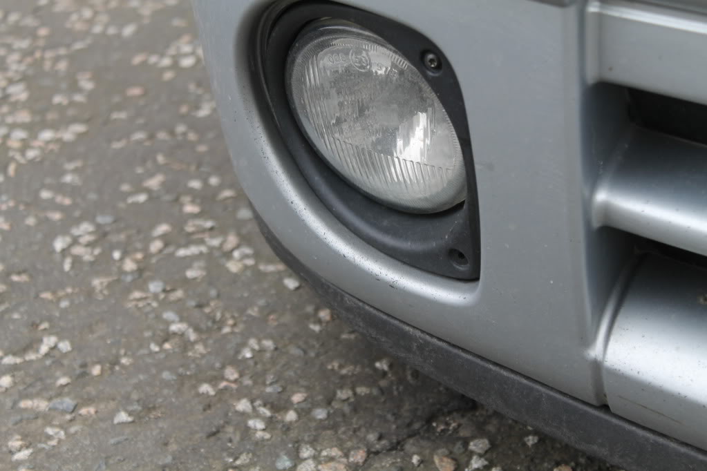

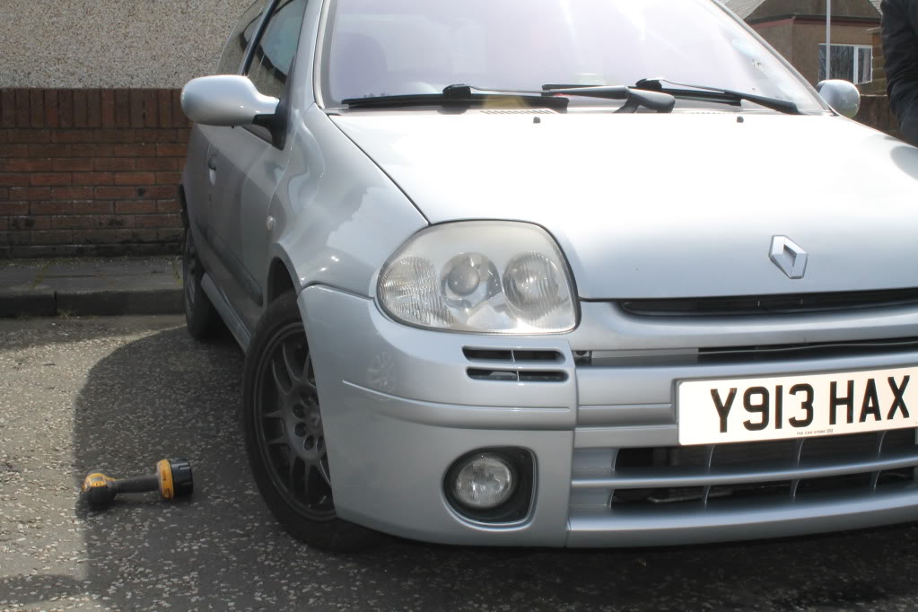

The headlights were next on the cards. The drivers one looked yellow in comparison to the passengers.
Wet snaded the headlights. Started with 600 grtin, then 800 grit, then 1500 grit, then 2500 grit. The headlights were then machine polished with cutting compound then given a final buff up with SRP.
Not really got any before or during pictures. Just afters lol

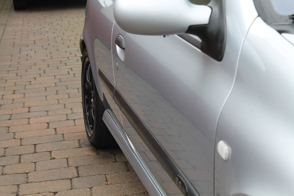

The car got absolutely covered in polish during this so a good clean up at the end of the day!
Before!!!
After wash and polish!

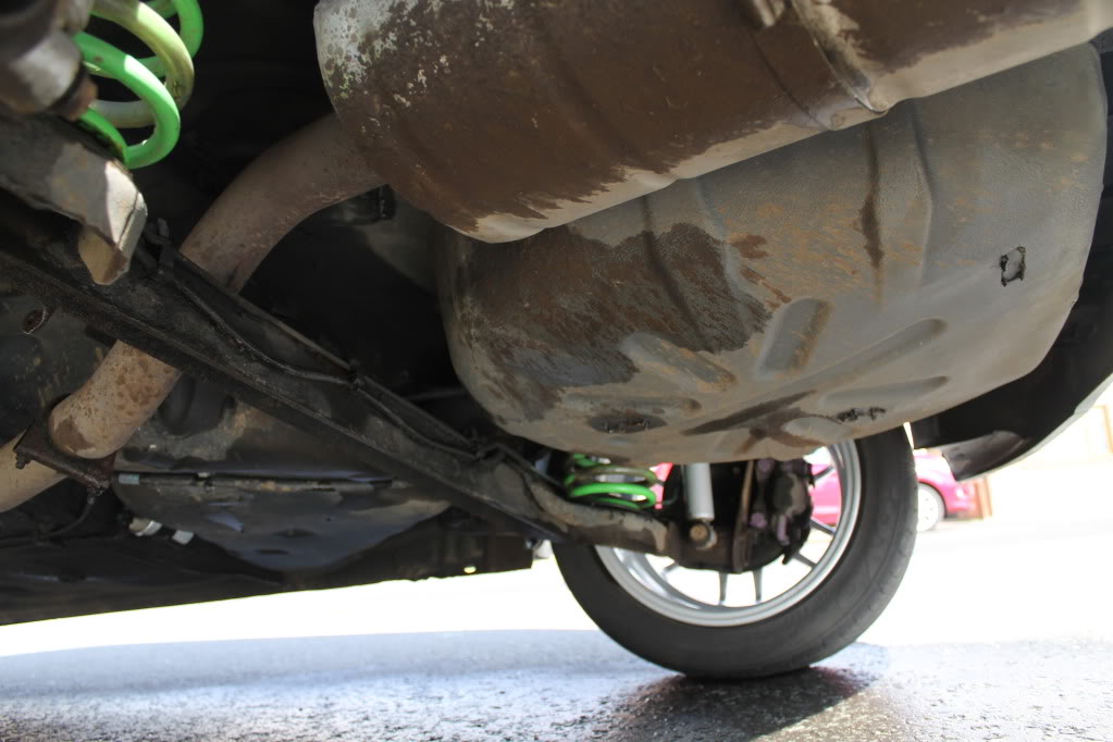

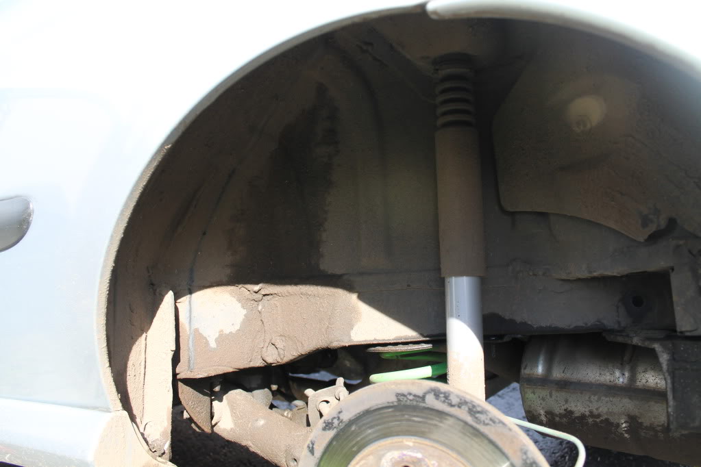

Wasn't to happy with the reverse rake from fitting the coilovers so had the car off the ground today and wound the front down another 20mm or so :D
Looking a bit better now

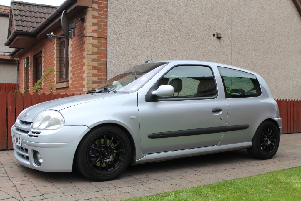

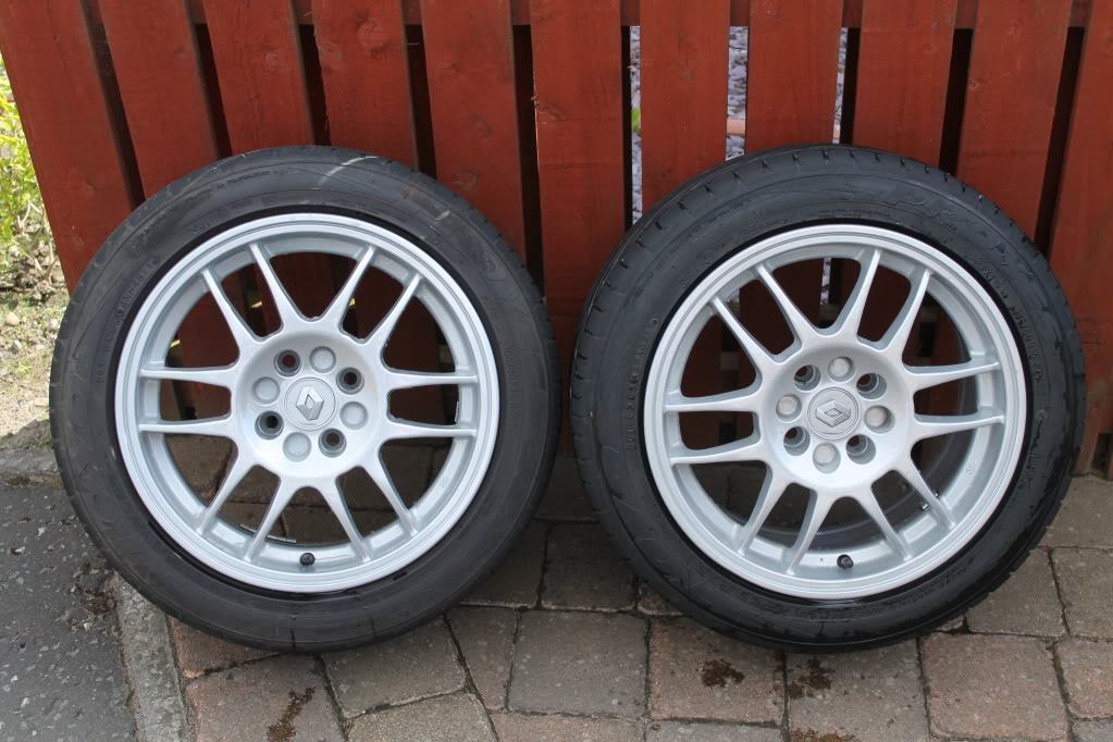

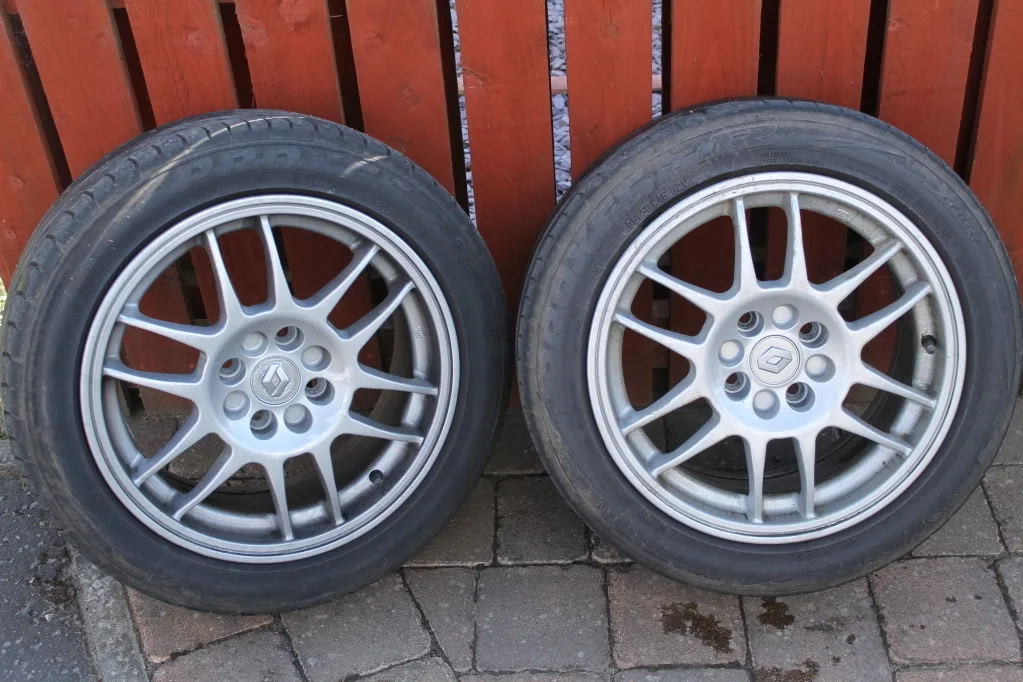

Got my wheels back last night.
Just a quick picture as i couldnt be bothered going outside to take photos of them
IPF in glenrothes done the job. £160 for he furb. Top quality work, all kerb marks from previous owners removed ;)
he also removes bends and will weld crack in wheels

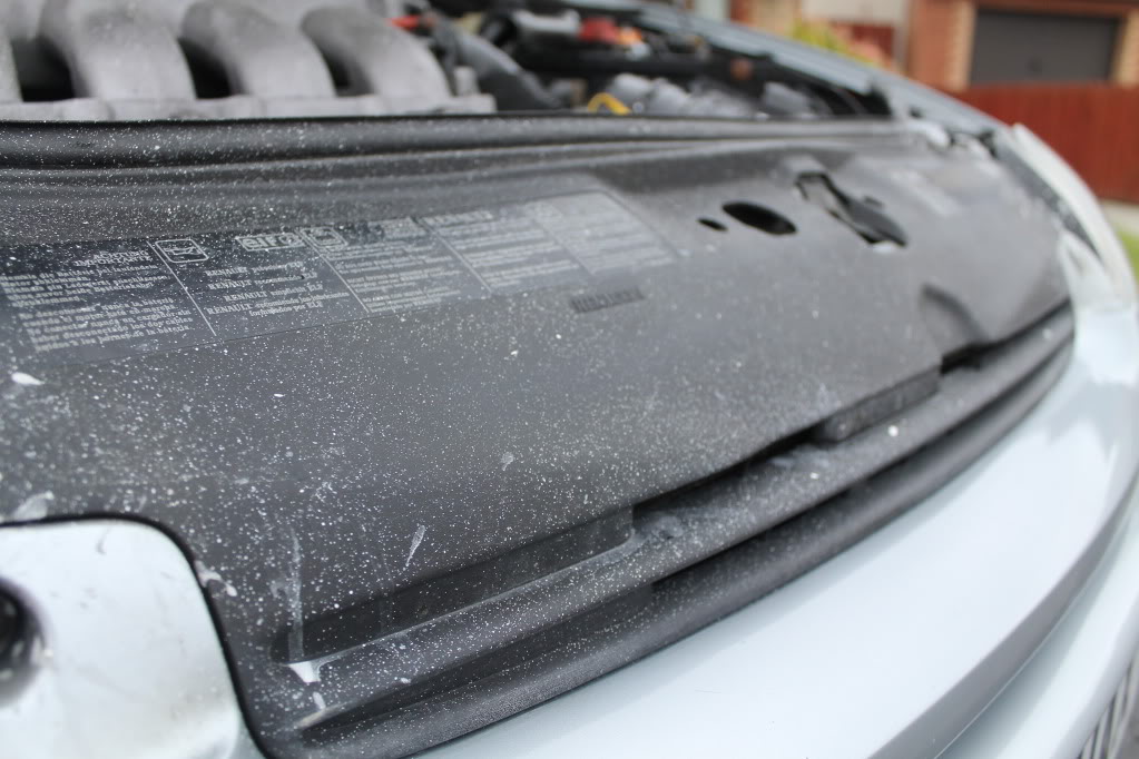

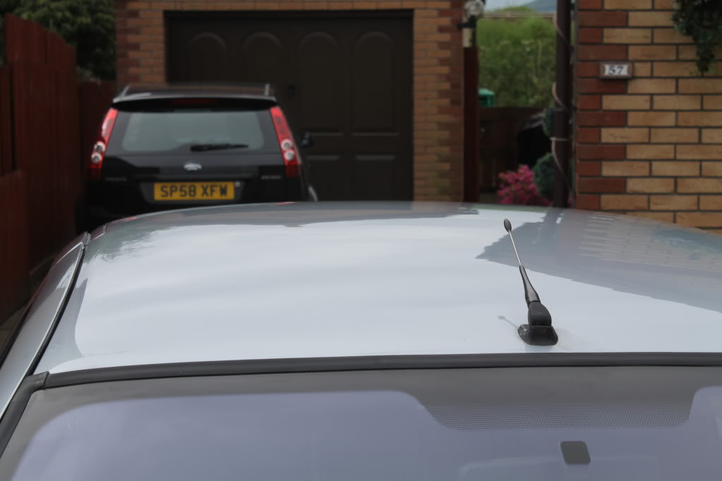

After FCS and the royal highland show the car was absolutely disgusting. Got her sorted out today lol.
Pics will do explaining from here.
a rather crap update, but none the less it was a good way to kill a couple of hours haha

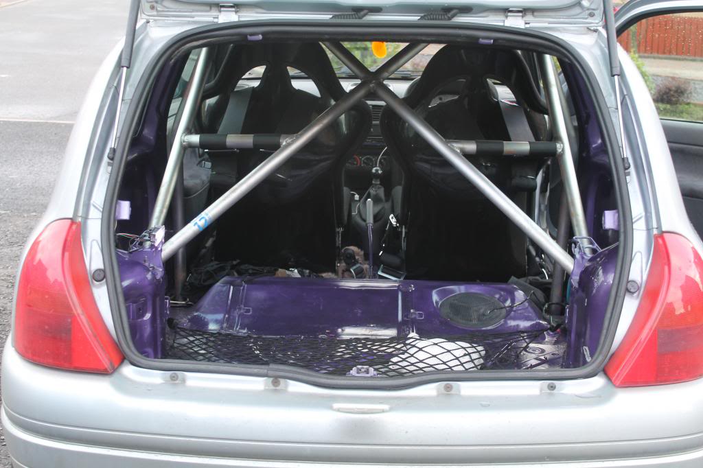

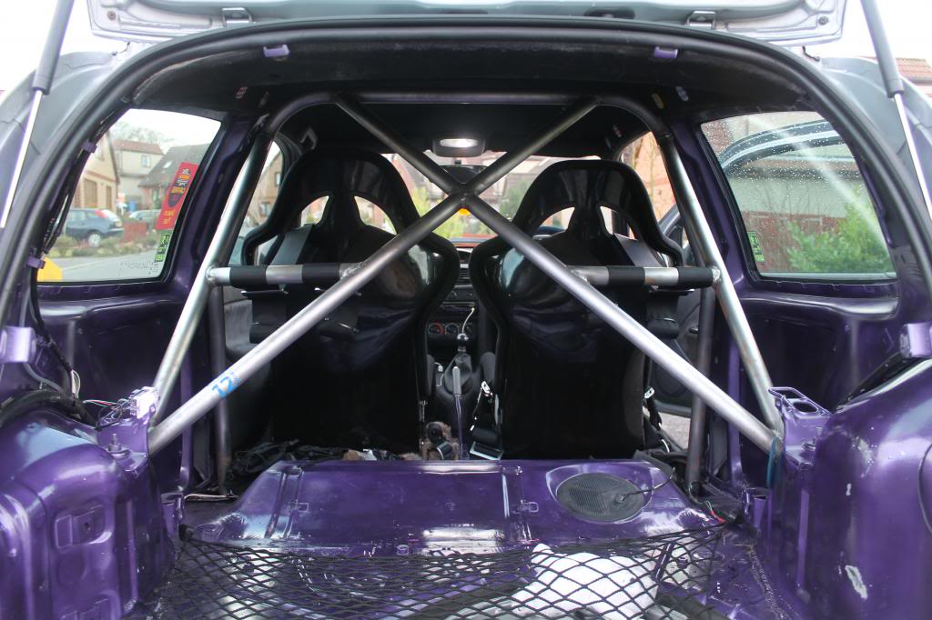

Ive made plates out of steel sheeting and covered up the "holes" that the rear doorcards sit in
I've also painted the inside ford violet purple. I then fitted a rear half cage with the help of djwjohn and djwdave
few pics:

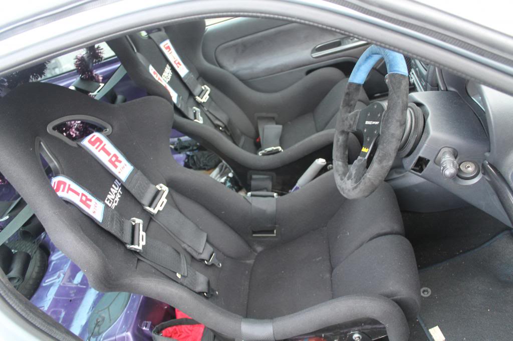

I also bought a set of bi marco seats and str harnesses, These wire fitted at the same time as my sabelt wheel!

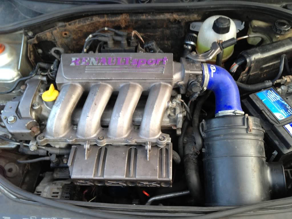

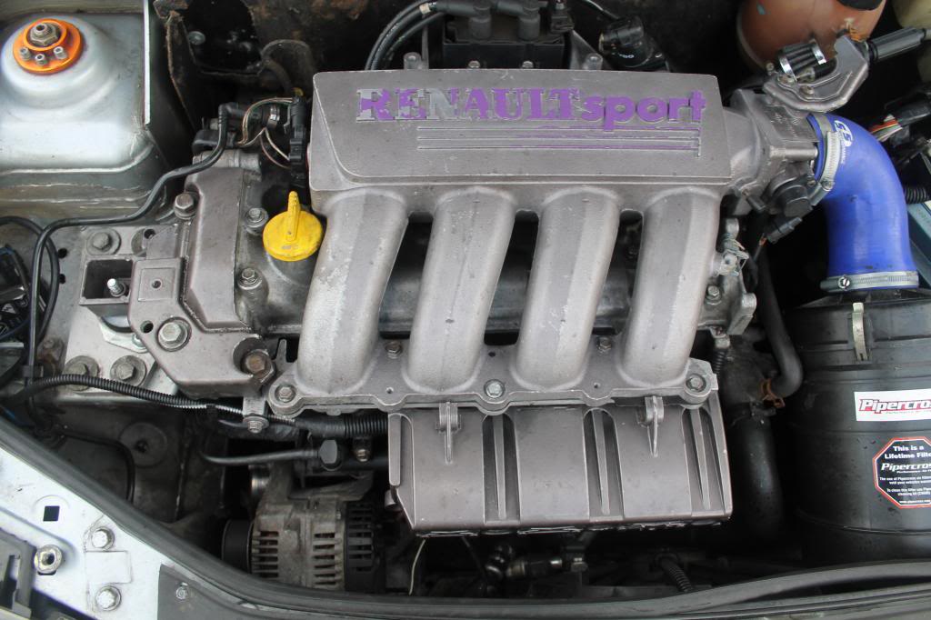

Sticking under the bonnet I've got solid engine mounts installed which has made a big difference. Totally changed the exhaust not strangely enough! lol

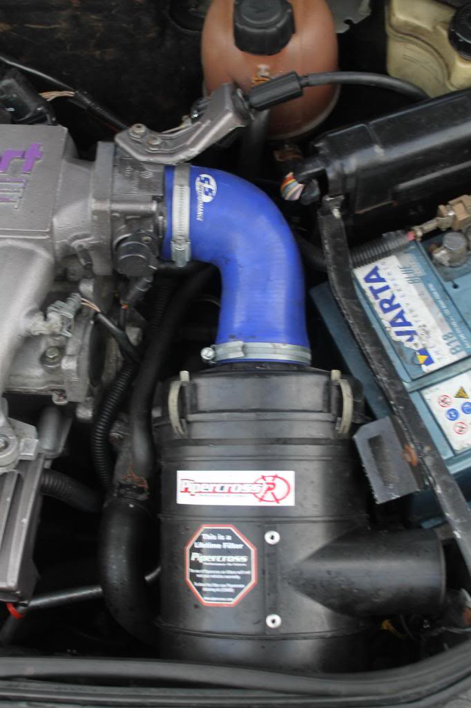

finally i got a new airbox and a pipercross filter, along with a silicone bend
(V6 box next i think!)

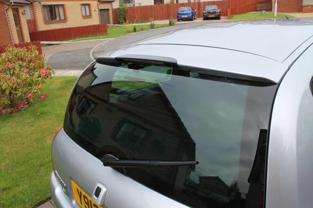

On the outside of the car i got a cup spoiler from frazjam and stu off of one of the cars they were splitting.
Makes such a difference to the look of the car! I also have new headlights on the way however FK are possibly the worst company in the world to deal with!

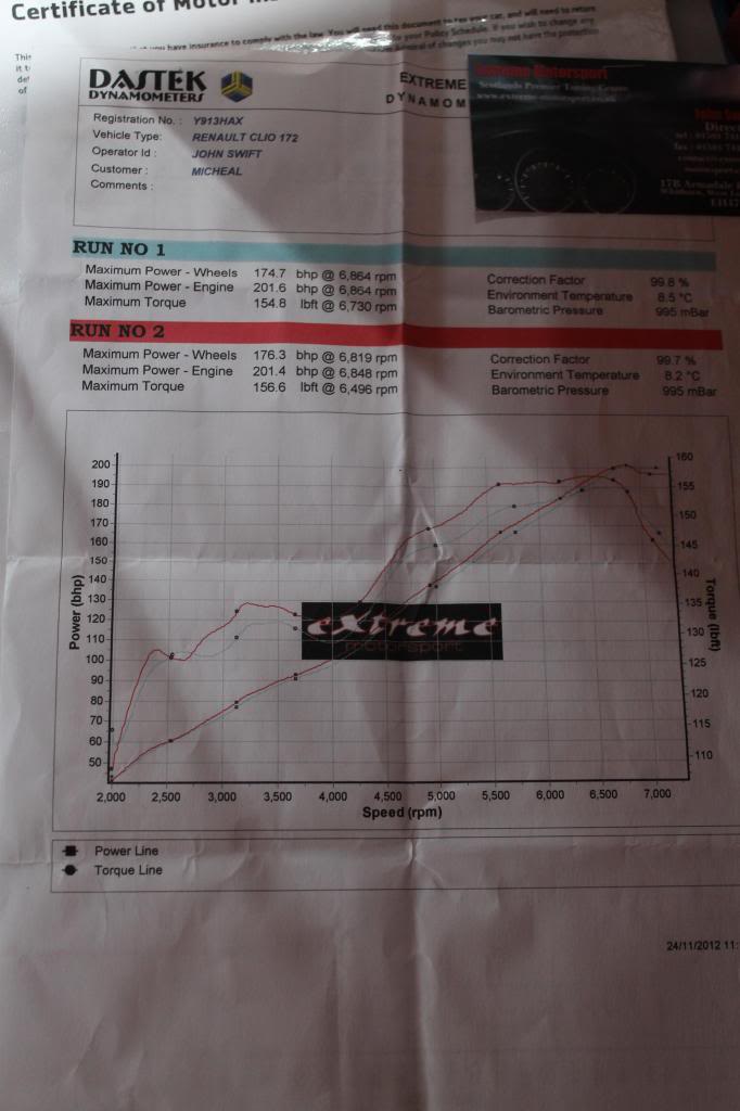

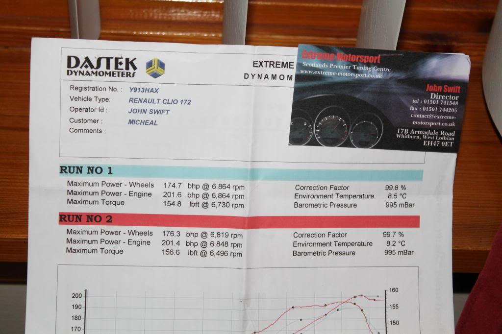

After having the car remapped me and the other fifers went to a rolling road day at extreme!
Pretty happy with the figure that i achieved :D
As for the car it feel awesome to drive. The cams have made a big difference. loads of fun!!

Wow those cams make awesome power, so much want! Who mapped it?
yeecup
  mk8Fiesta ST,172 cup
Re: 172 berg,
Does he have rollers too? Just wondering cause swr do work on my car too and cams are on my want list.
Michaelfoz
  Clios
Re: 172 berg,
He doesn't have the rollers but the person who does the map has rollers so will provide a rr figure

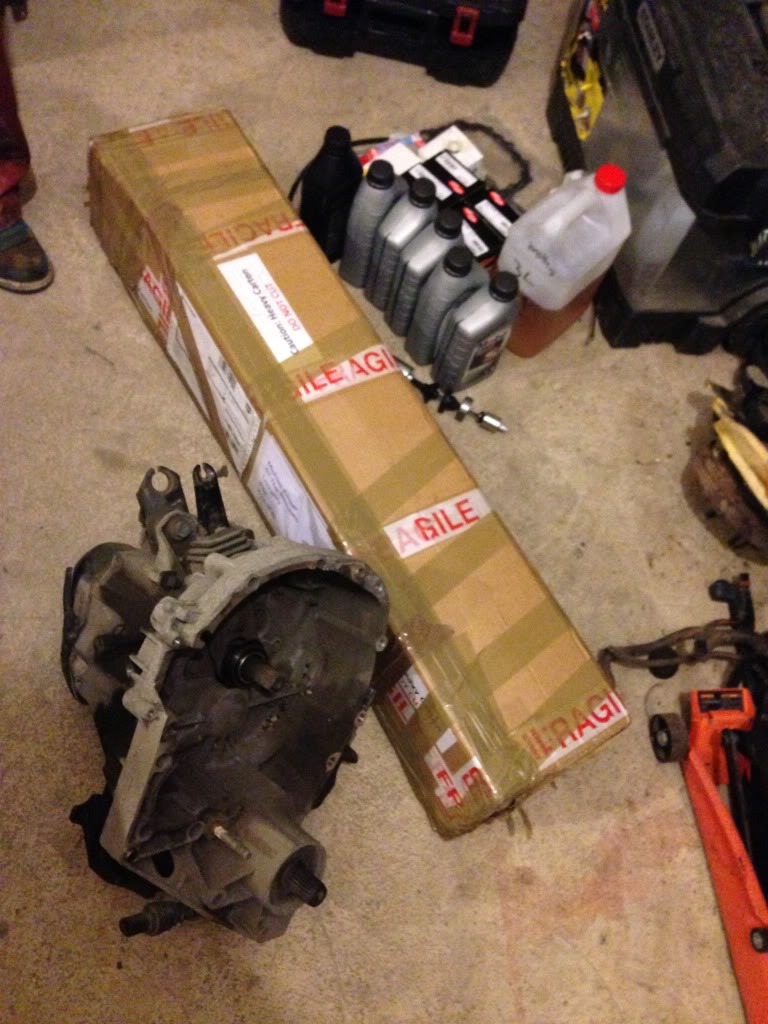

gearbox done
sump gasket done
crankshaft seal done
track rod ends done
ball joints done
asts fitted
tracking done
Full service done
Frazer Jamieson = hero
spent the eveening of his 21st helping out / loaning his garage
then 18 hours straight the next day to finish all this
Clio_stu came along for five or ten minutes as well :p

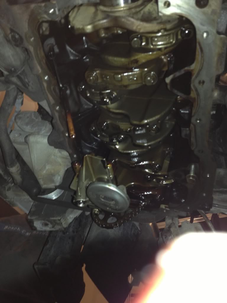

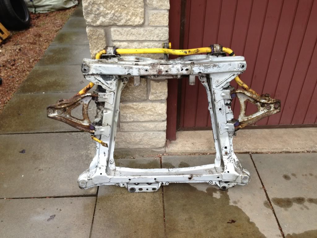

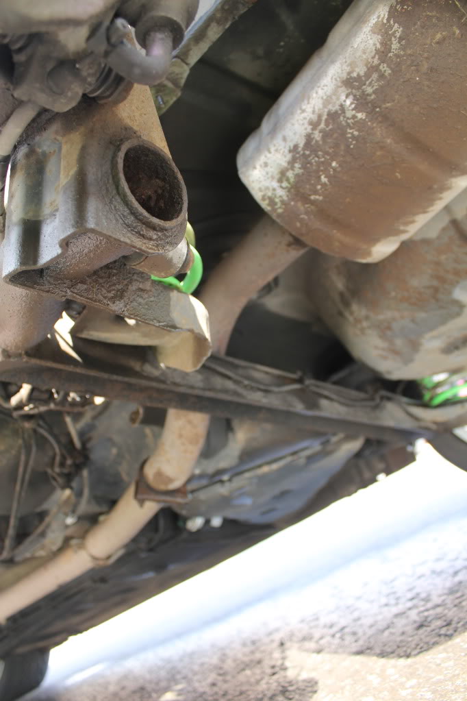

As adam is a moaning faced hoor i have acquired one or two photos from doing all the work stated above

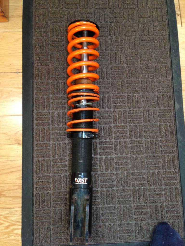

Asts, enigne oil, gearbox oil, clutch cable, sump gasket, new rear caliper, track rod ends and ball joints
subframe degreased and all oil removed.
could do with some more paint but time was wasting away lol
big end

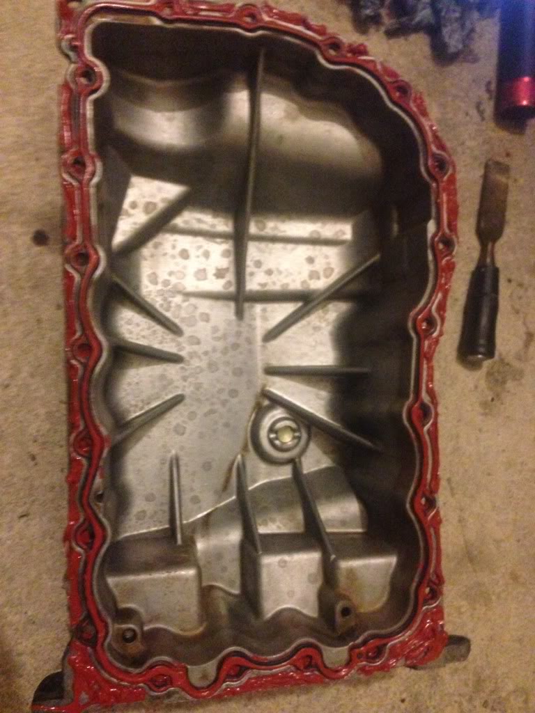

Sump all cleaned out, new gasket and sealant on

AST's!!!

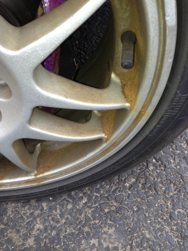

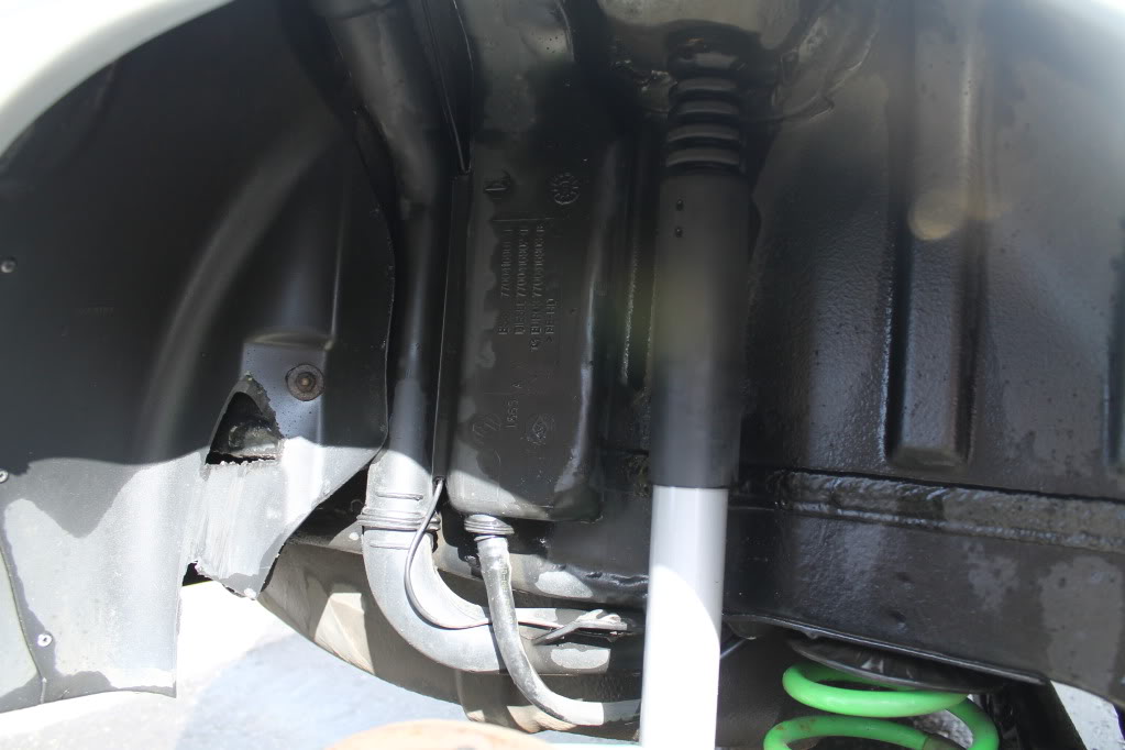

went on a road trip at the weekend which resulted in the read pads being worn to the metal, a windscreen being broken (again), and a hid ballast being burst.
New ballast has been fitted, rear pads changed, and windscreen getting replaced today,
New brembo discs have been ordered and a set of carbon lorrainne RC6 pads
Rear pads wearing down to the metal resulted in metal shavings collecting in the wheel. these have now went rather rusty lol

A v6 airbox was purchased and installed! running a pipercross filter same as before!

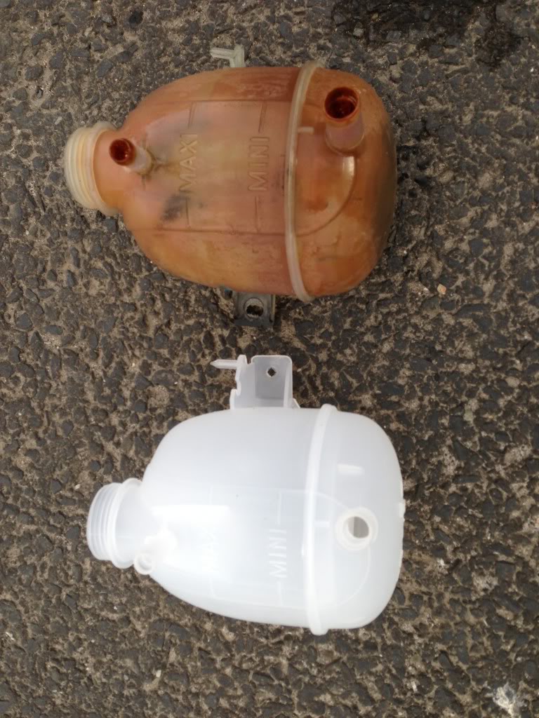

also bought a brand new coolant bottle! totally pointless haha

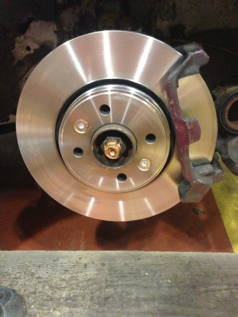

New front discs and pads!
running brembo HC discs and Carbon lorrainne rc6's
what a set up. the squeal off of the pads can be a bit embarrassing should you be down the high street BECAUSE RACECAR

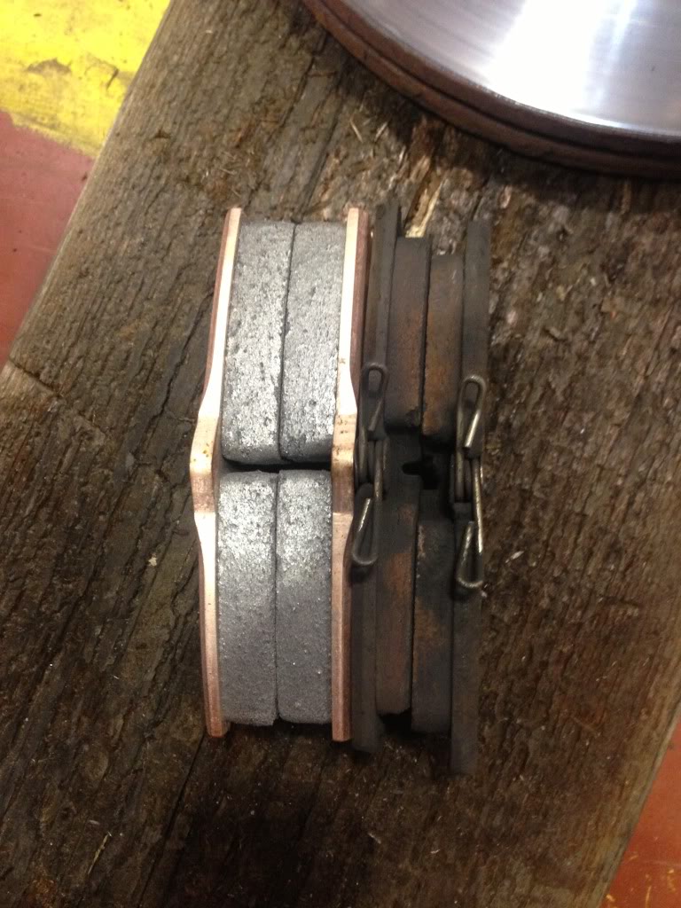

Old ds2500s vs new rc6's
ds2500's were originally dannyR's who sold them to fraser.J who then sold them to me at the end of a track day!
still got quite a bit of meat left for the mileage that they have seen

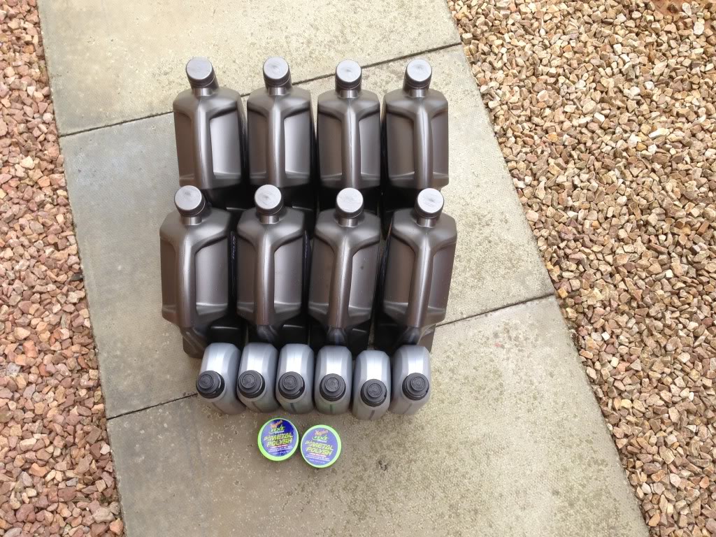

bought a bulk buy of oil from opie!

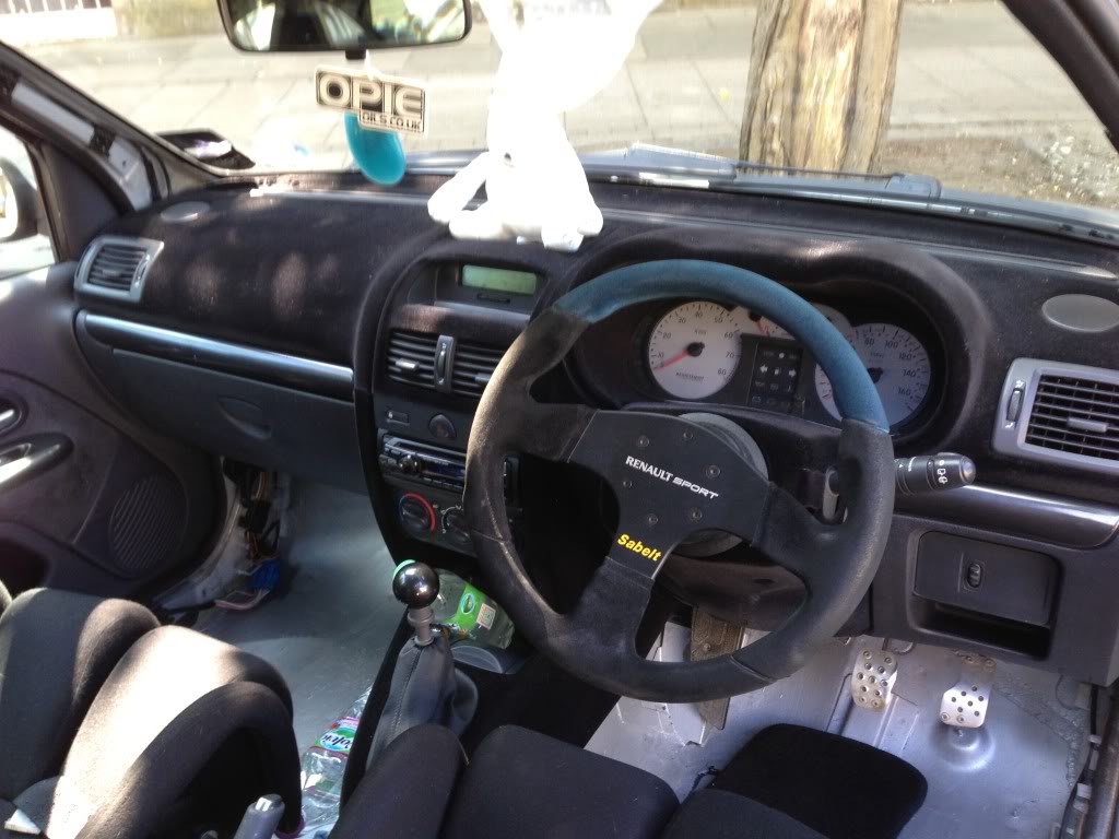

I also thought it would be hilarious to run about without a dah for a while which ended up being pretty irritating!

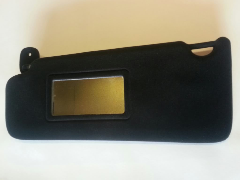

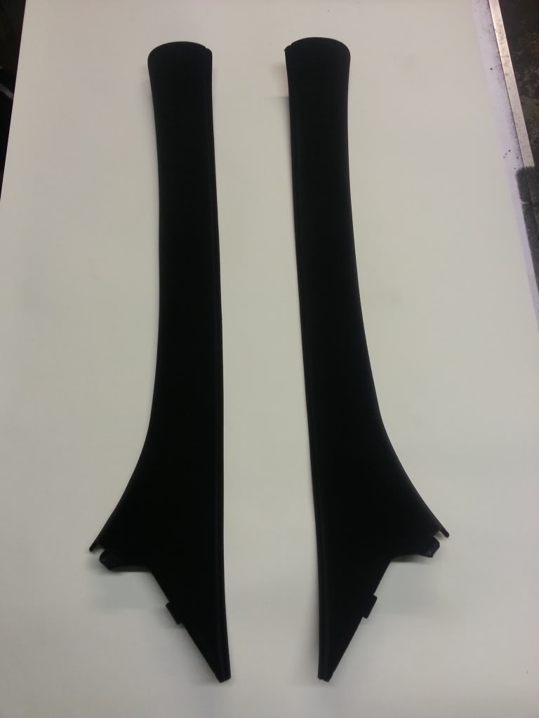

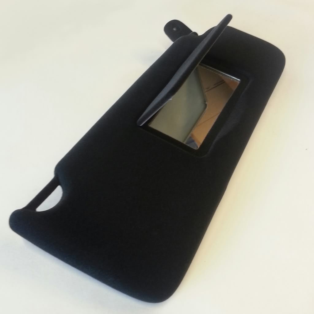

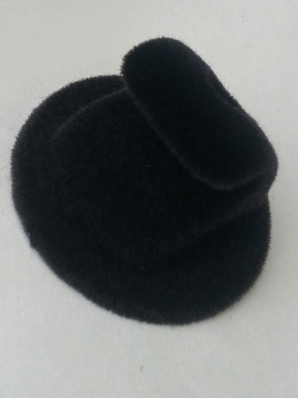

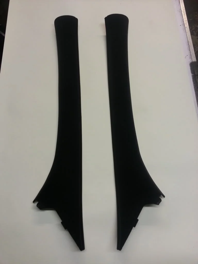

purchased a flocked dash and ordered some flocked a pillars and sun visors from geordie_james on here!
great work and would highly recommend him. Very helpful!

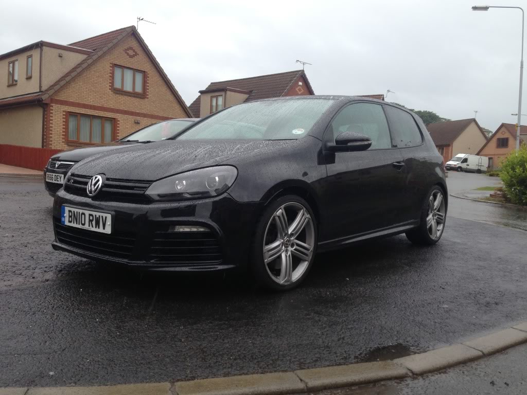

Also purchased a new daily motor to potter around in
